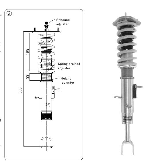

IIRC height is set at close to what Ohlin recommended in their install documentation. I think it was 33mm between spring perch adjuster and heigh adjuster. Maybe even more because there is about 4-5mm of preload on the spring.

From the manual;

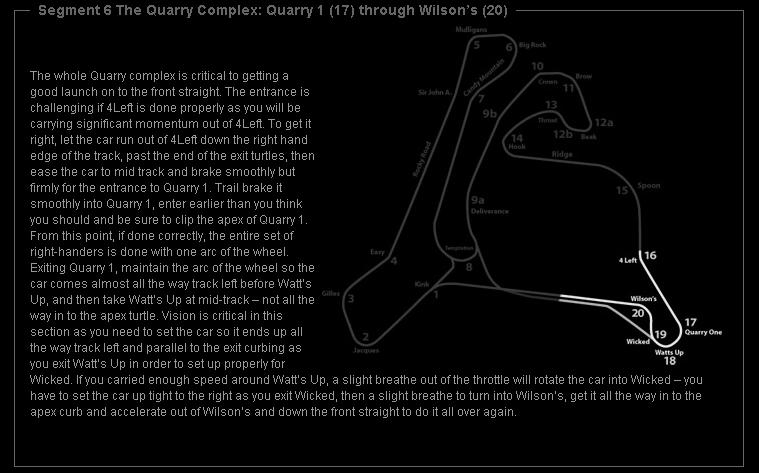

Another issue could be driving style. Coming into the corner hard with a lot of trail braking will load the outside front. Is that a problem? Lap times and tire temps will answer that.

This is the corner (multiple corners taken as 1), there is ALOT of load at the front left at this point in order to setup the car for exit.
In the image attached, those pictures are taken at entry/exit of 18-19.
