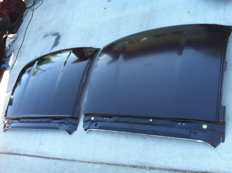

New fiberglass roof mold we made works like charm! Stock roof on right. 24 lb weight savings

Fiberglass roof fits perfect!
