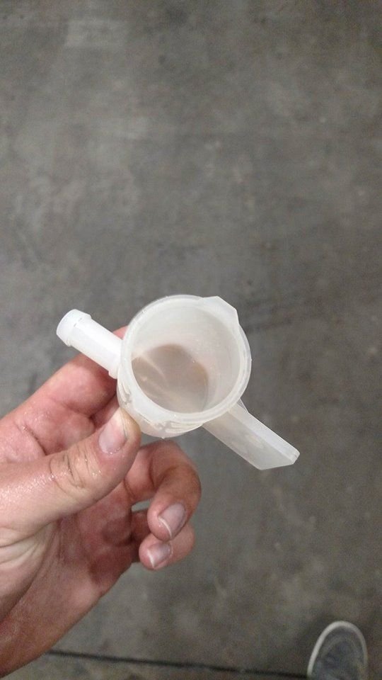

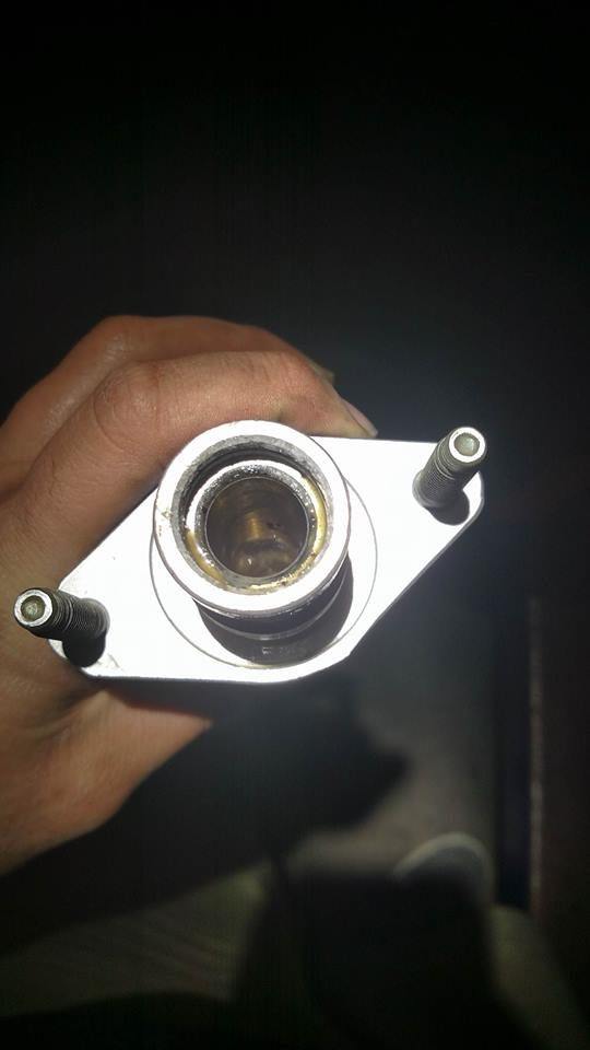

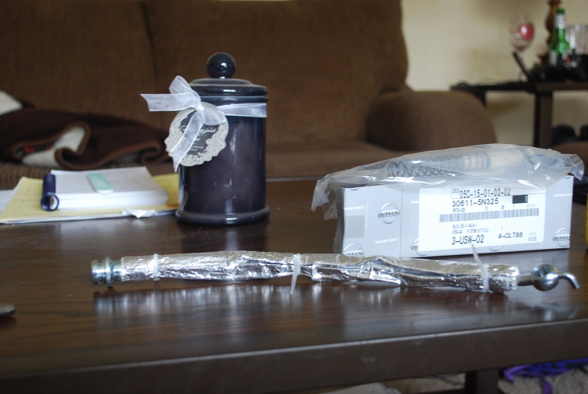

First I started off with attempting to remedy my clutch issue. Tore apart everything hydraulic in the clutch system. I Rebuilt the master cylinder and replaced the rubber hose along with the slave cylinder. I cleaned everything out meticulously and made sure there was no debris left everywhere. I had access to a shop when doing this I used a solvent tank, then brake cleaner, then an air compressor to dry it off.
Some pictures from before:
I borrowed my girlfriend's camera to make me feel like photographer. The slave and hose were from O'reilly (I work there and get a good discount) I haven't had any problems with slave cylinders in the past, and the lifetime warranty makes it so in the future I can warranty out and either get a new one for no cost or get my money back.
That was nasty.
using an air hose to blow all the crud out, then filling it with brake cleaner, then blowing it out and did this until I emptied a can of brake cleaner.
All clean! Then I bled the system.
So after all was done, initially the clutch felt MUCH better. It had a "rusty" feel to it when I would push the clutch in and out. So hop on the road and do a 1st to 2nd pull and shift quickly... does the same thing. Bogs the rpm down and the clutch doesn't follow my foot up. Did it again and launch my knee into my chest and same thing happened. I feel the pressure plate is becoming weak.
