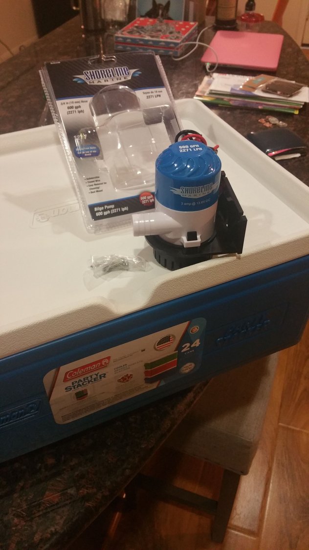

Bilge Pump $15

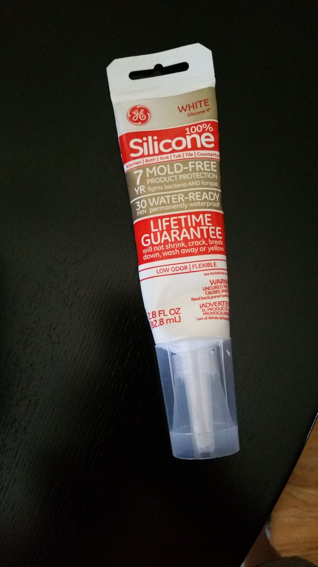

Silicone $5

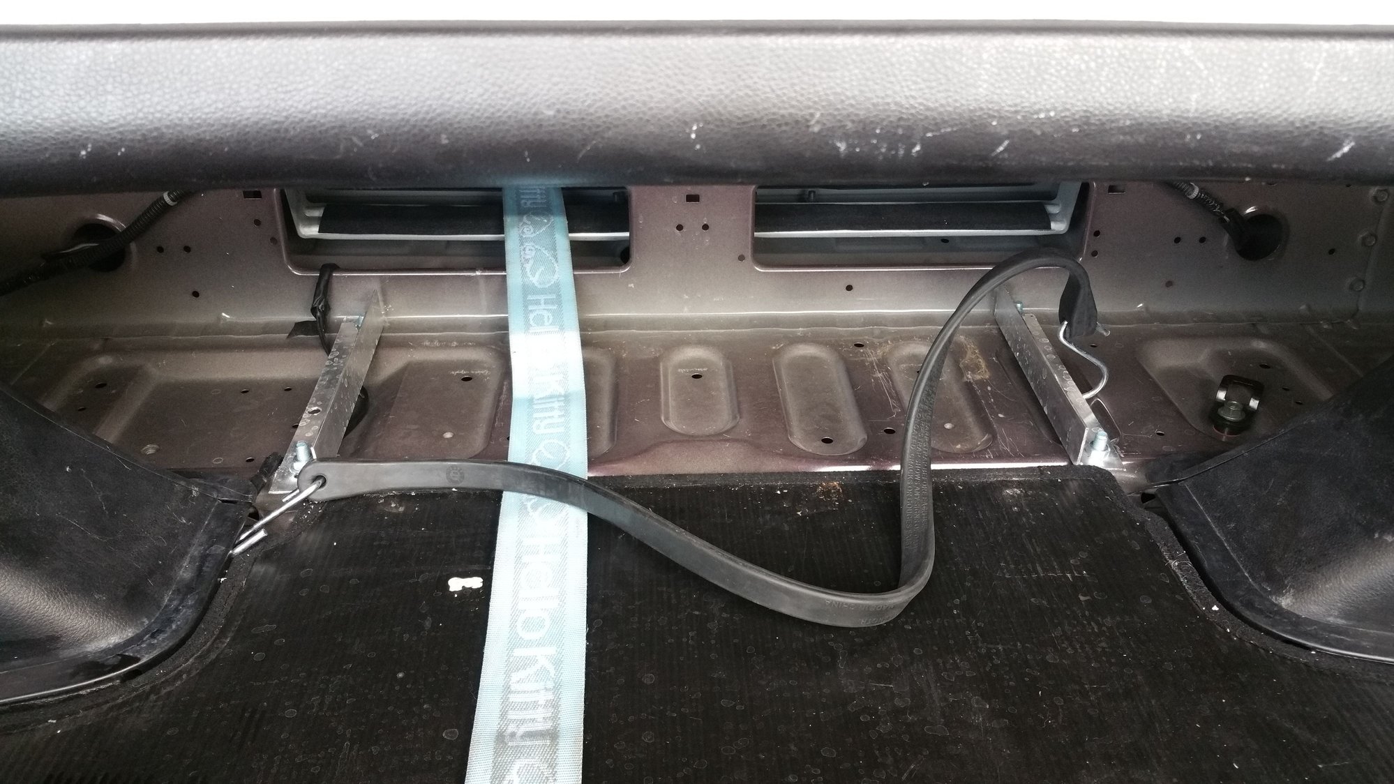

Aluminum L bar for brackets $10
Aluminum sheet for baffle plate $10

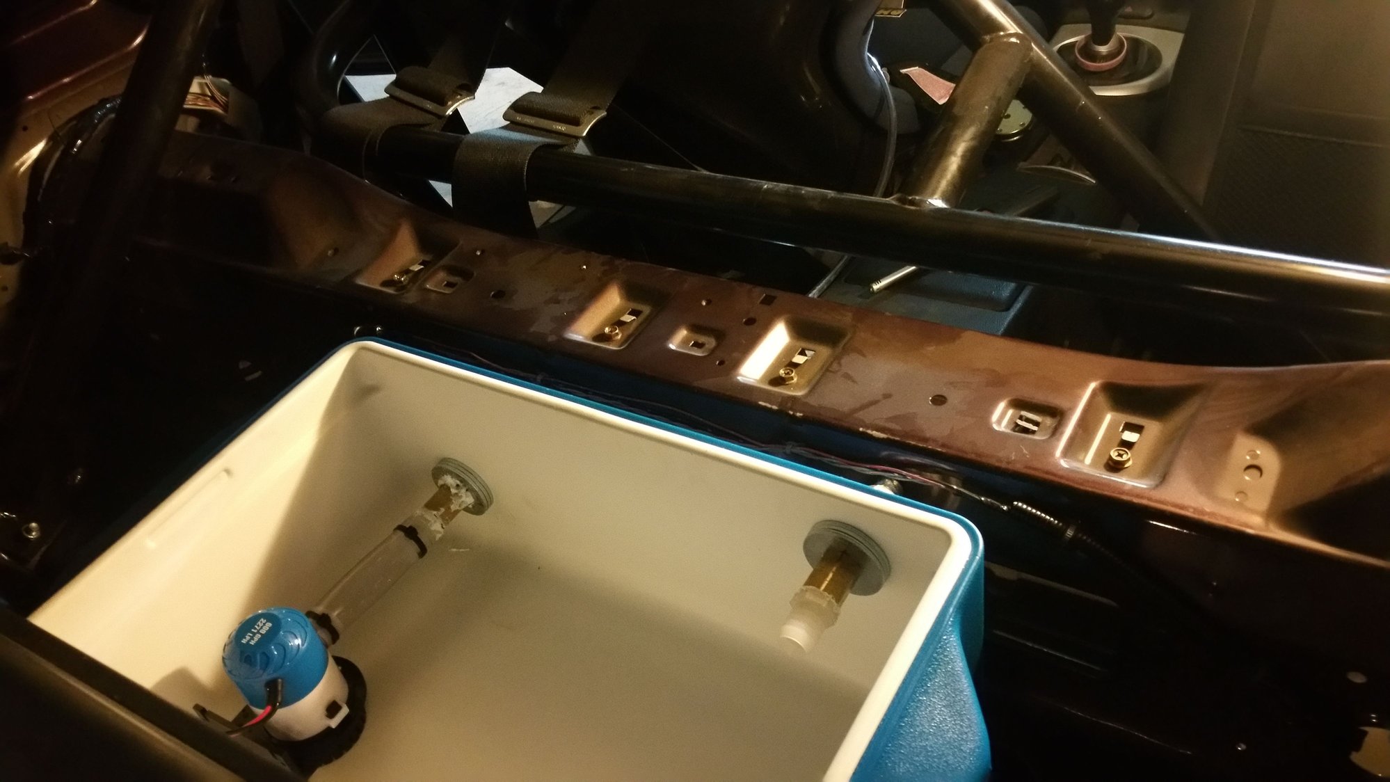

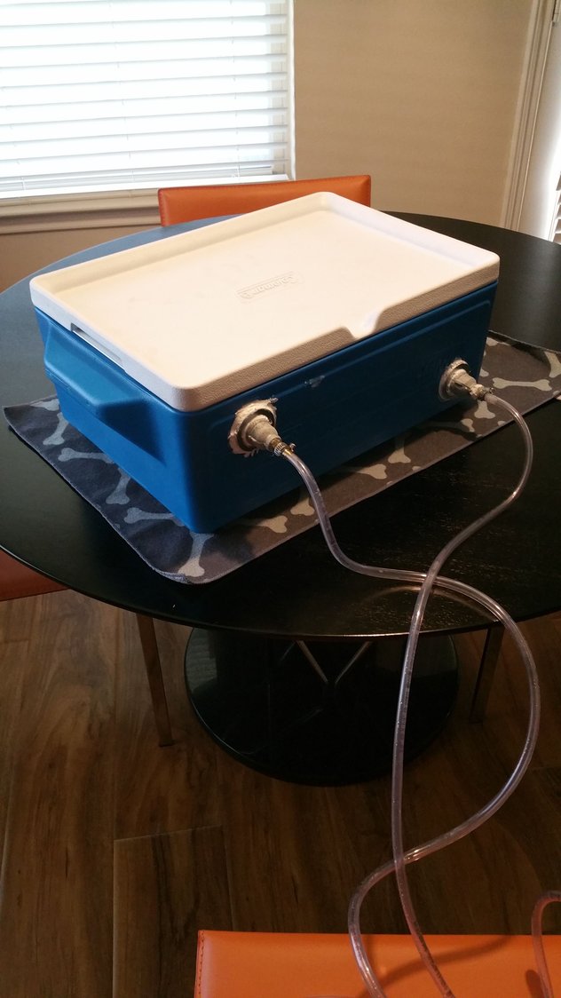

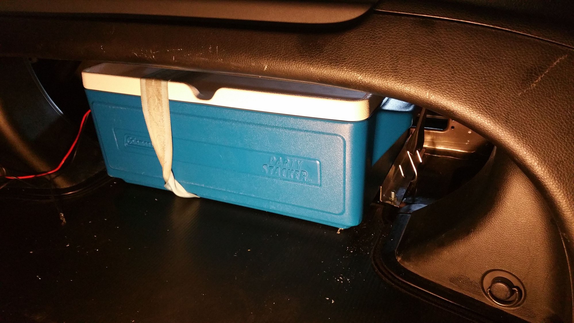

You could use another cooler with a smaller capacity, but I wanted to find one that fits under the rear bar, and I can slide in and out easily. And that's the only one I find in Amazon that fits the criteria.

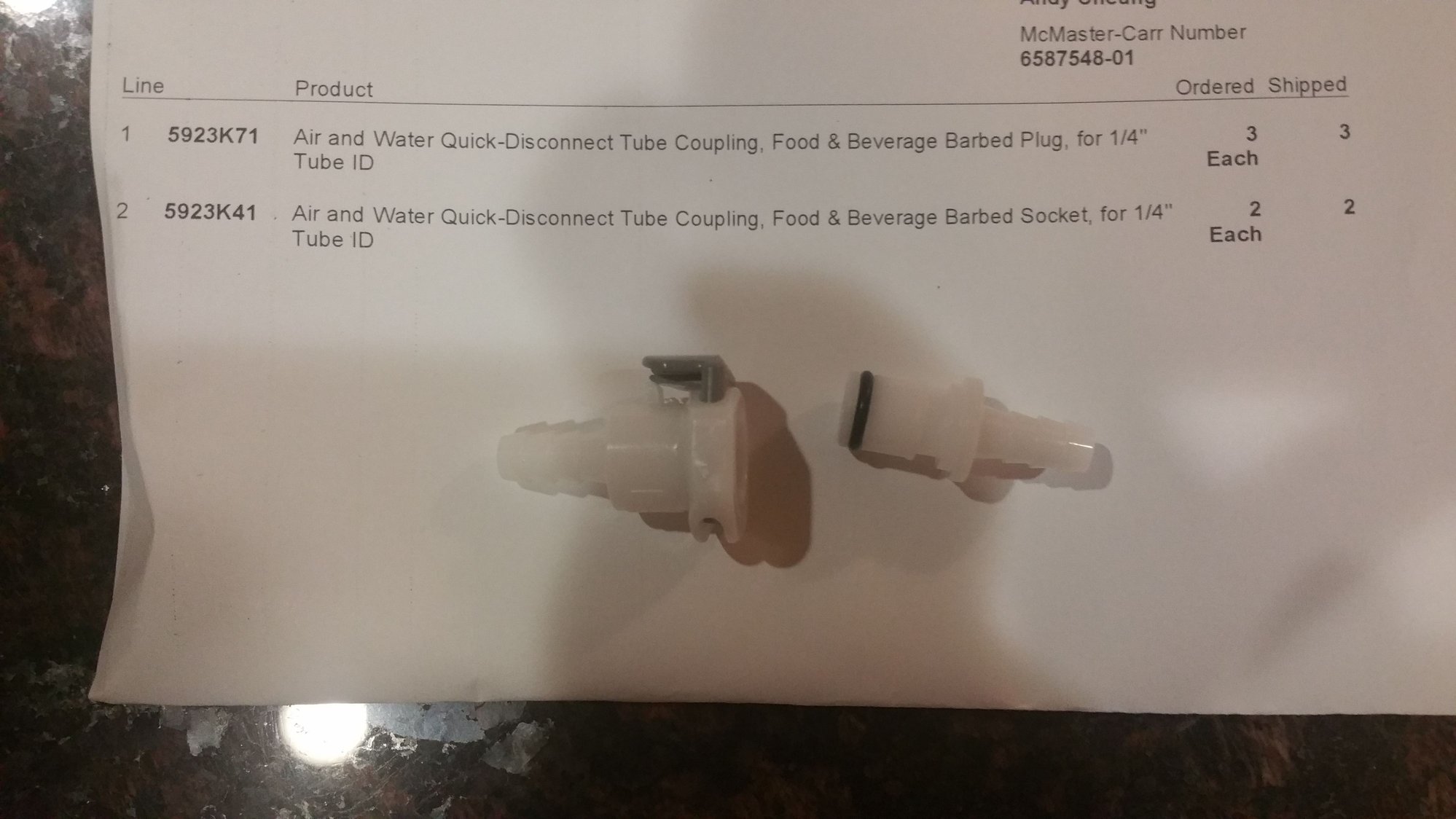

The only fittings that was not bought in a local stores are the quick disconnects. They're from McMaster-Carr and those alone costed me $20 shipped. Everything else was bought from either Ace or Lowes, and I basically just went there and see what they have to connect the pump to my hoses and that's what I ended up.

the little silver things on the side are from IKEA leftover materials. They used to hold bookshelves
toggle switch from Amazon, power supply from cigarette lighter

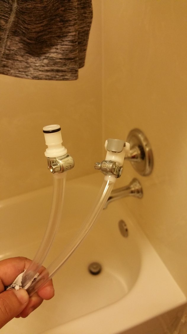

female/male connection on shirt, when disconnect from tank, I can connect them together to prevent dripping water all over
