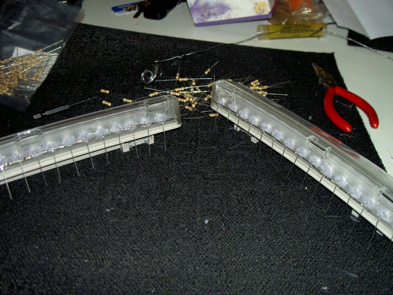

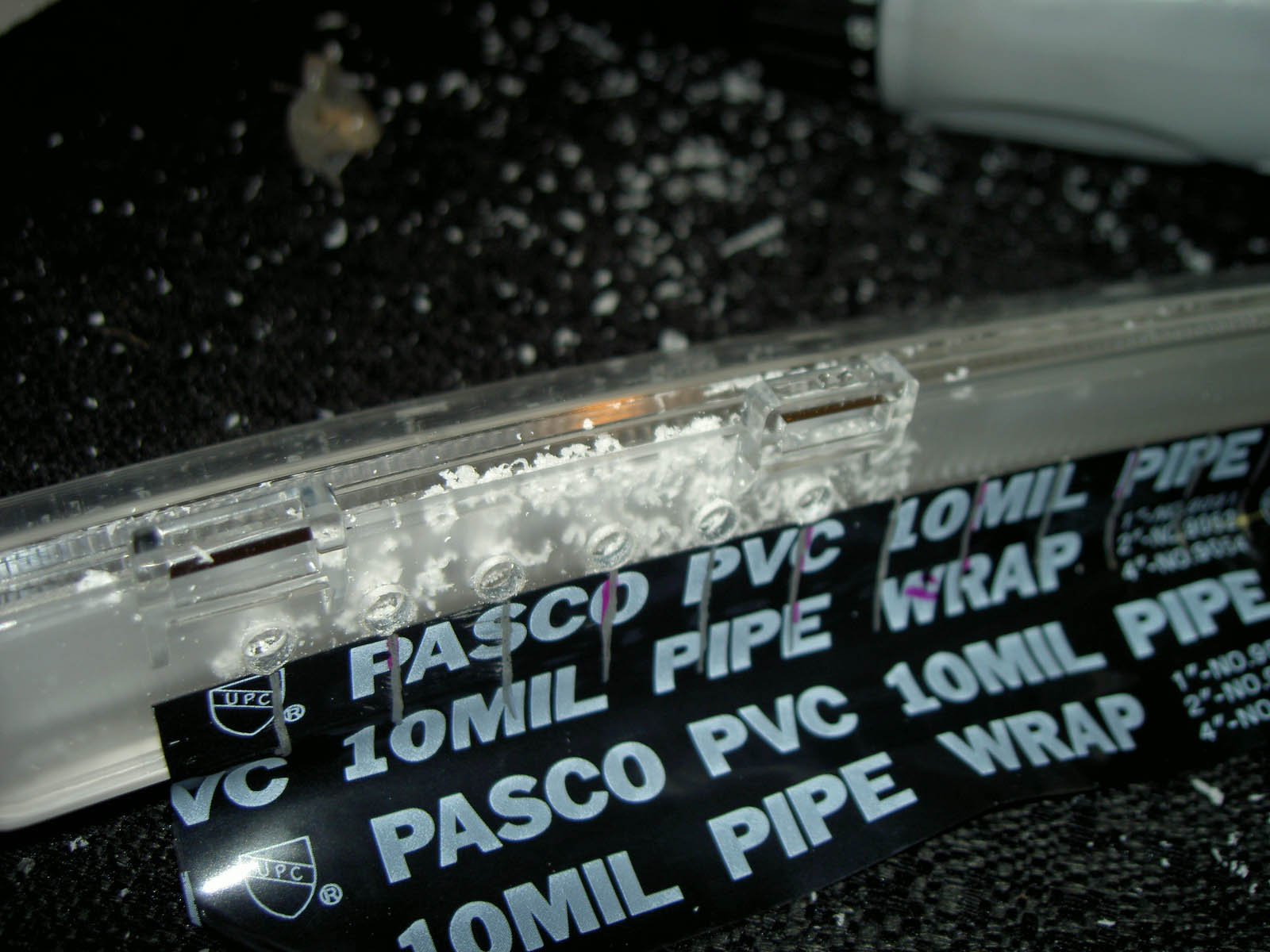

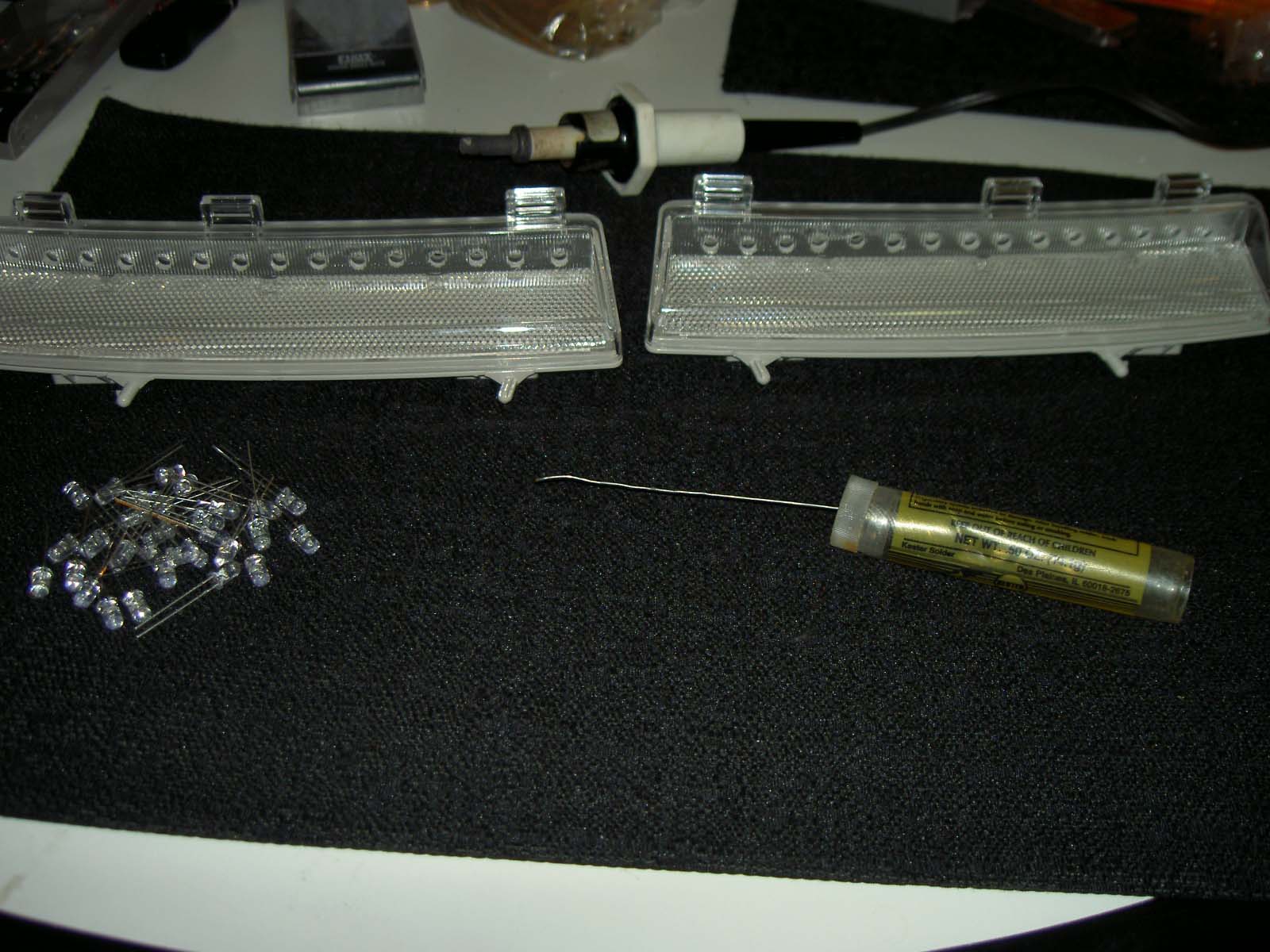

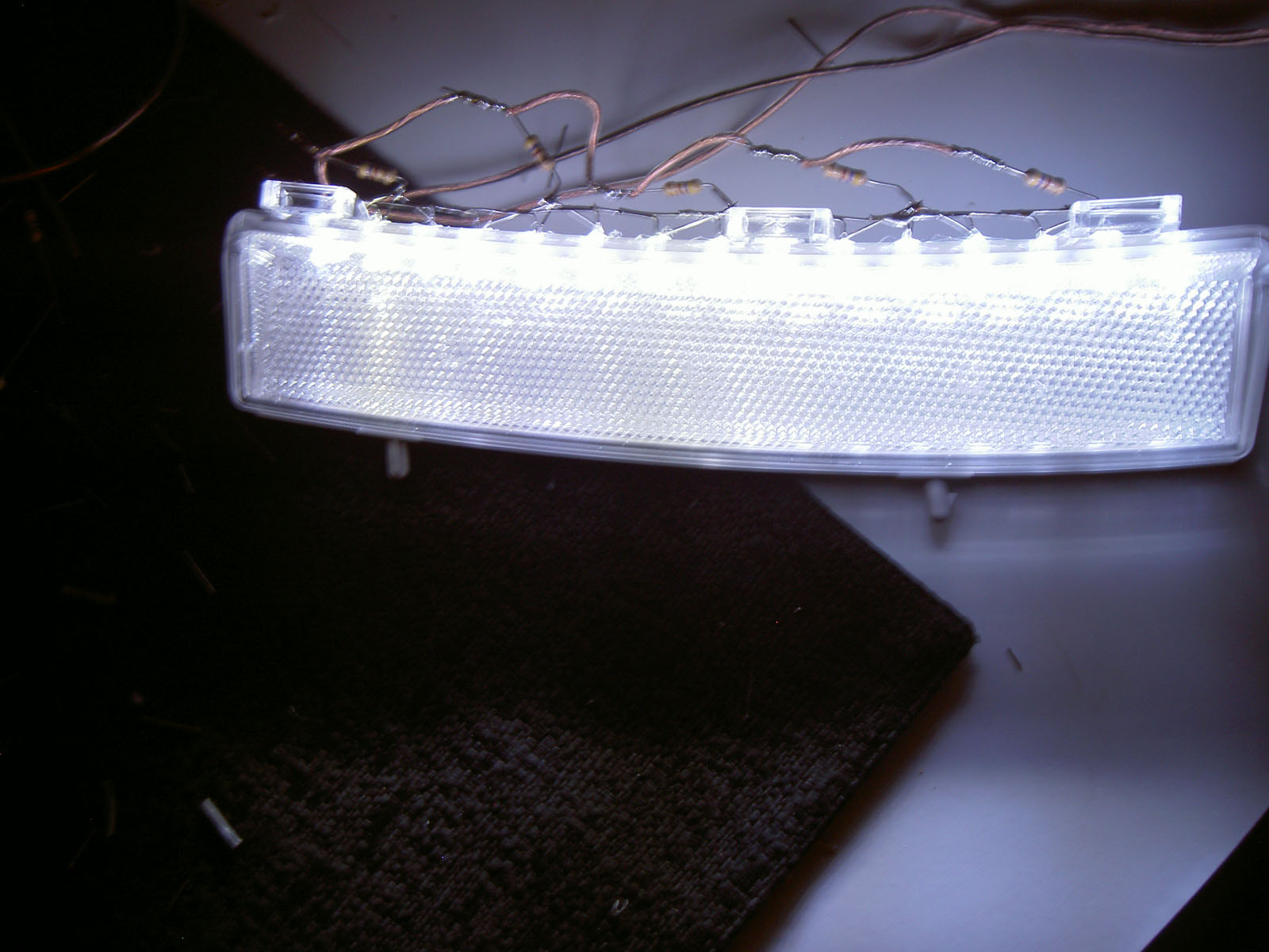

i made my own.. its very easy...
it cost me 27 $ for the 30 5mm leds.. and resistors...
and 57 bucks for the clear markers... DIY save 150-300 bucks
u dont even have to bake them open..
i just drilled the holes from the back... and u just vacuum out the plastic shavings.. there are 2 layers to drill through..( the casing and the inside reflector ) it is easyer to drill a bit and clean the shaving as they occur.. rather than them fall back inside form move vacuum work..
it took me 4 hours to do them both total.. first time..
u can hook them up to the park light or your signal light easily.
u do not have to take the bumper off to install there..
all i did was jack up the car and take the front tires off .. inner fender plastic removal..
the passenger side was more tricky . the Windshield wiper Reservoir is in the way.. there are 3 bolts.. u can get to them and lower the bottle out of the way for more room ..
2 screws for the marker and the wires and u are done..

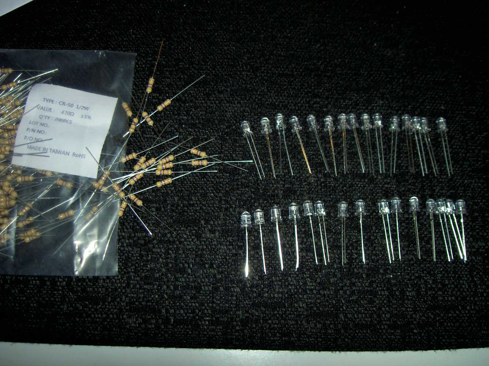

for the type of light i used... i needed 1 resistor for every 3 lights ..( resistors and light Combinations vary on what u use) ( each has there own rating)
local electronic store can give u the right combination.. just remember u need a 12 volt application / 14volt running.
i connected all the negatives in 1 row ..
. then mono foamed the rest for weather proofing.
