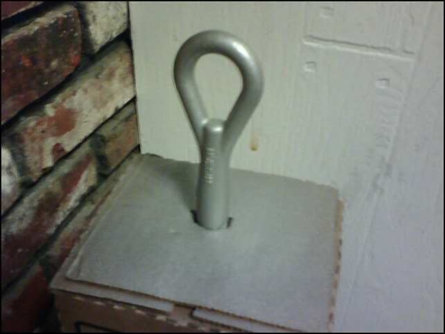

Step 2... Spray the hook with 3-4 LIGHT coats of the Metalcast metallic base coat. Light coats are necessary to keep the paint looking uniform and not rippled / dripping. Allow 10 minutes between each coat. Make sure you spray all around the hook (up into the hole too)

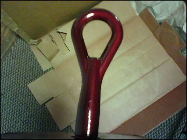

Step 3... Let Base Coat dry 10-15 minutes, then apply 2 LIGHT coats of the Metalcast Clear Candy Topcoat. Allow 10 minutes to dry between each coat. Again, make sure you spray all angles of the hook.

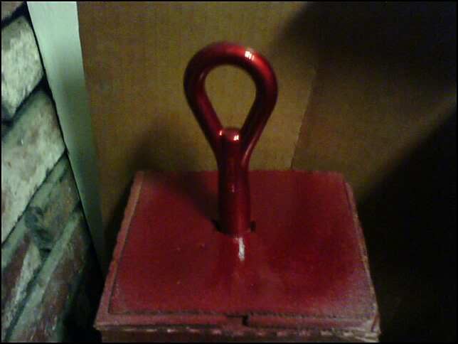

Step 3... Apply one Full Wet Coat, apply it lightly but a fair amount of spraying should be used and the hook will look "Wet". This is the last coat, the paint is dry to the touch in one hour, it can be handled in three hours, and is fully cured in 24 Hours.
Now you're done! A clear coat is not necessary because the Candy coat is essentially a colored clear coat.

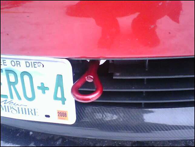

Here it is installed...
