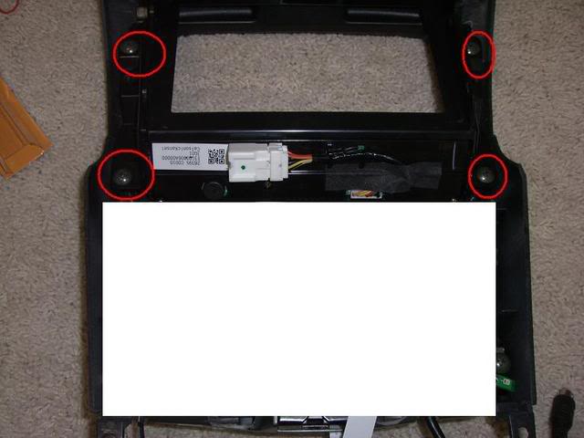

2. Remove the 4 screws that is holding the navigation door assembly to the console.

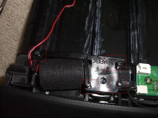

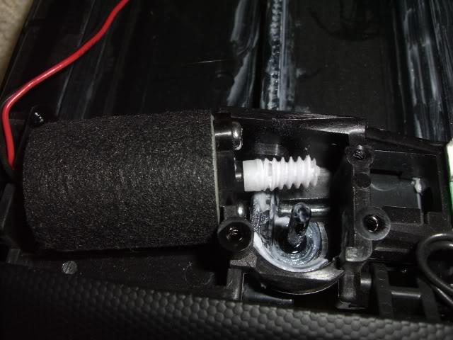

3. Remove the 4 screws holding the motor mount.

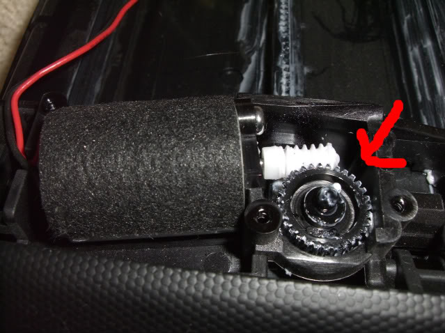

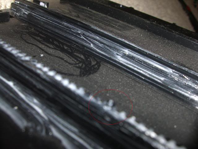

4. take a small screwdriver that have a skinny shaft or anything small enough to stick it under the circle gear and lift it up.Maybe you can remove it by hand but you might have to turn the white gear around to get the black one out. You need to remove this gear in order to slide your door up and down manually.

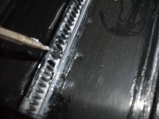

5. ok your door should be able to move freely up now, but you might have to yank on it a little bit since there is a piece of plastic that needs to be removed. once it is pulled up check the middle part that have that gear line to make sure there is no piece of cracked pastic stuck between it. If you find something like this then remove it.

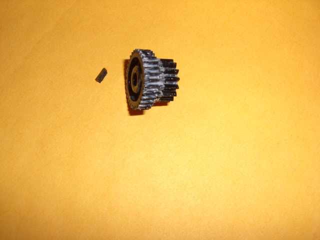

6. Sometime the circle gear that belong to the motor also have plastic piece sticking to it too so just remove whatever that dont belong there and hopefully that would fix the problem

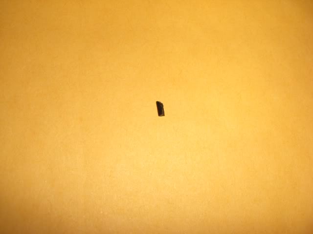

this was what was stuck on the gear. a tooth of the gear

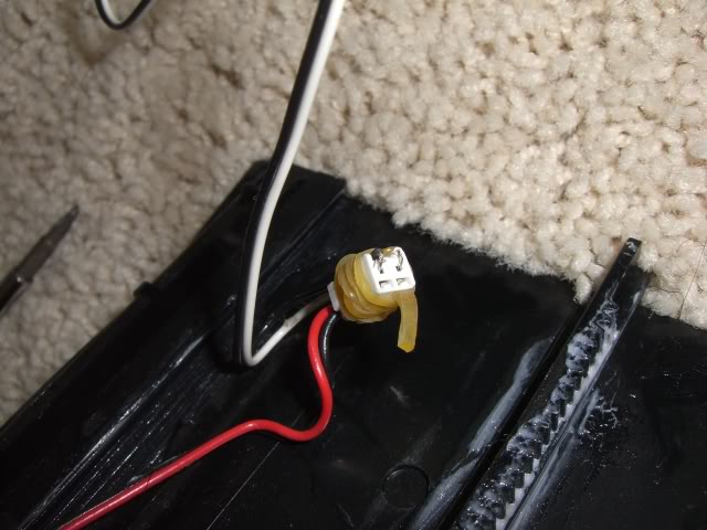

ok to test if this solves the problem i unplug the white connector that provides power to the battery and stick two wires into it and have the other end to a 9 v battery. The motor is bipolar so if it the red cable is positive then it goes up and if black cable is positive then it goes down. test it out before you put it back together.

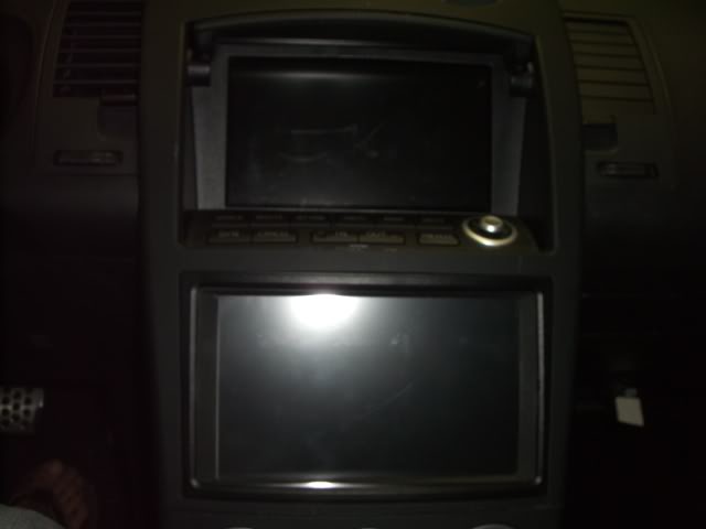

umm i have an 04...

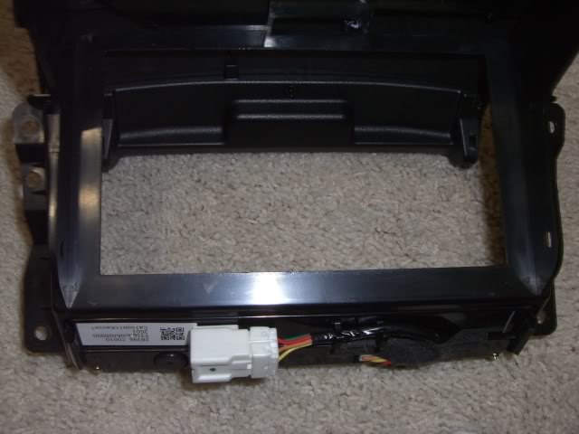

the white connector there is the keypad... i didnt remove it yet... but i suppose all of it should look like this
