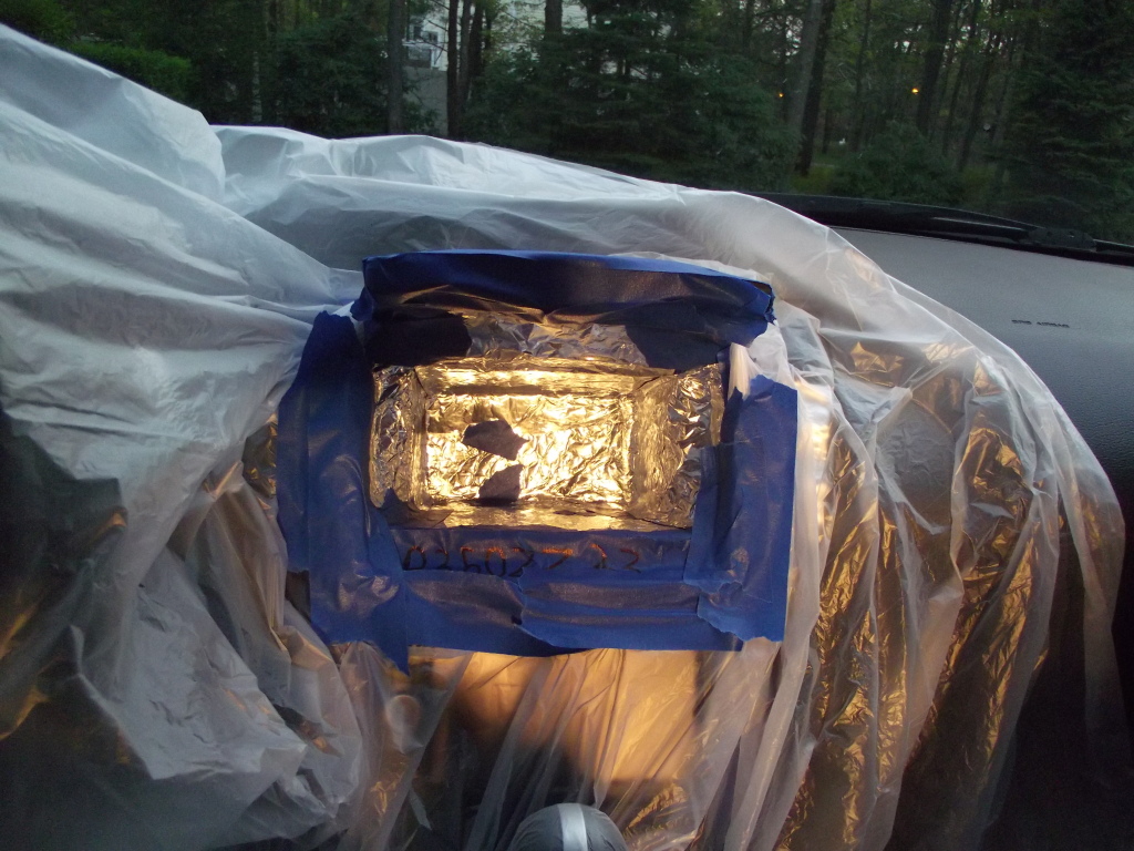

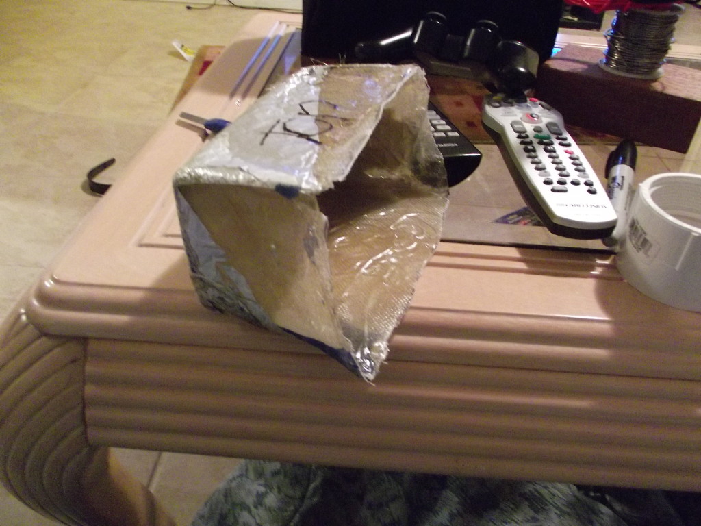

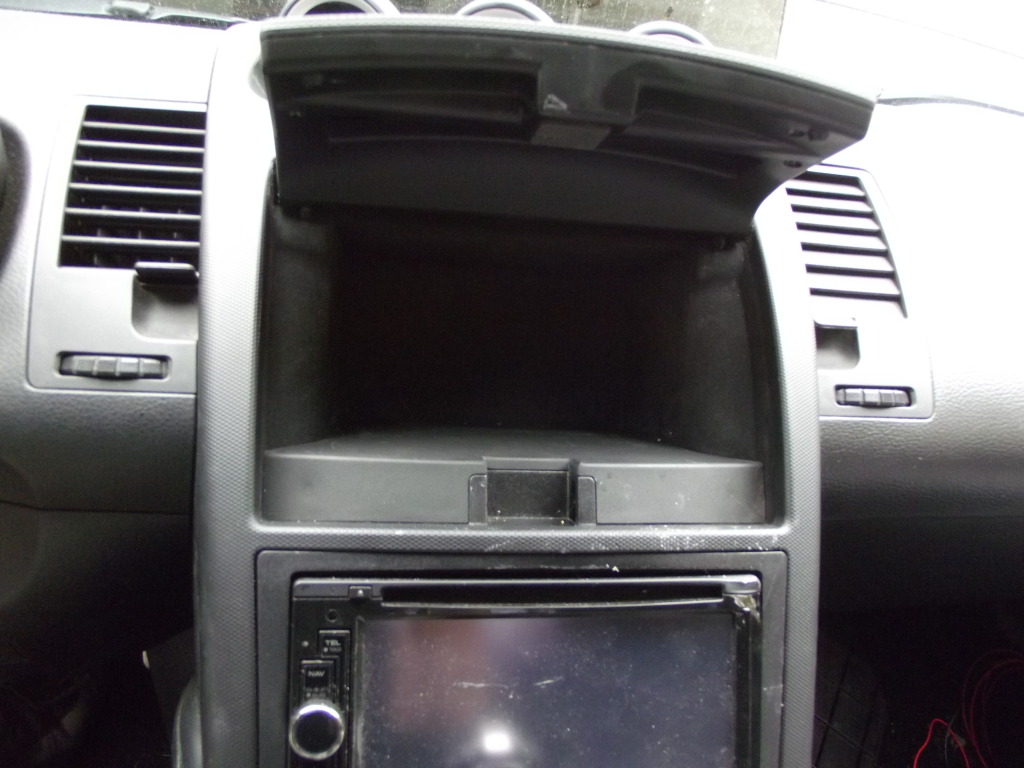

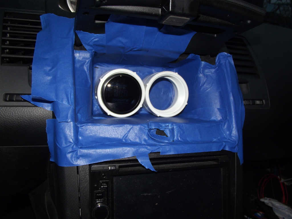

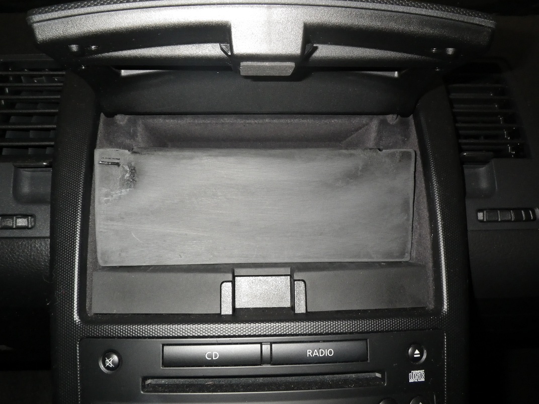

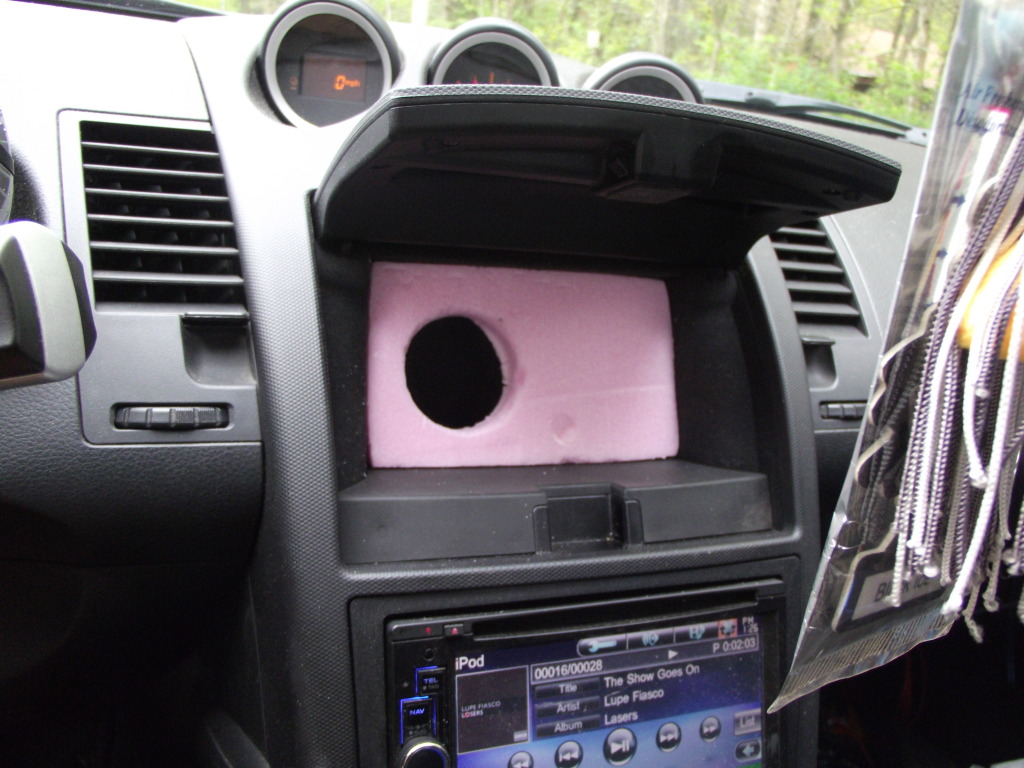

so i have a pillar pod with 3 gauge spots but it looks to big and bulky, and my cubby doesnt get used since i took my lil navi out when i switched to a kenwood deck with built in navi so why not put them in there and have some fun with fiberglass.
i started with this
then i realized that you cant use resin with that foam oh no
back to square one

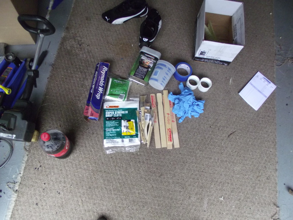

the goods

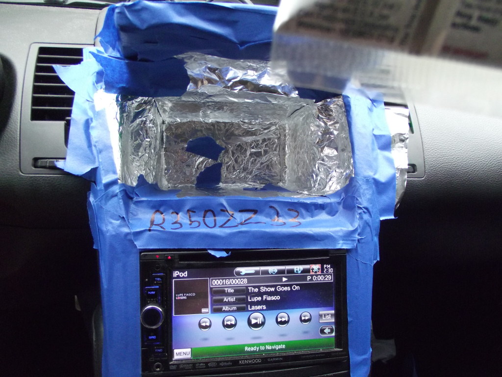

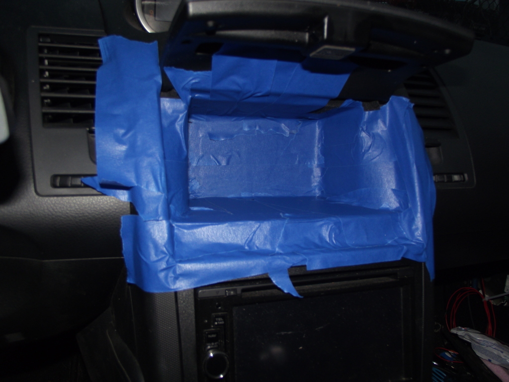

tape it up
test fit

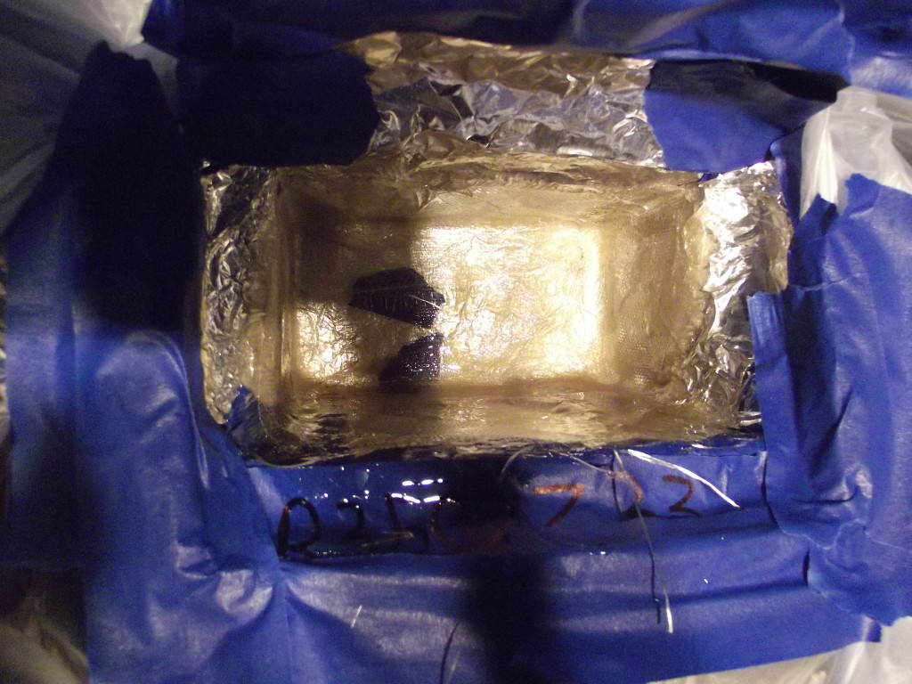

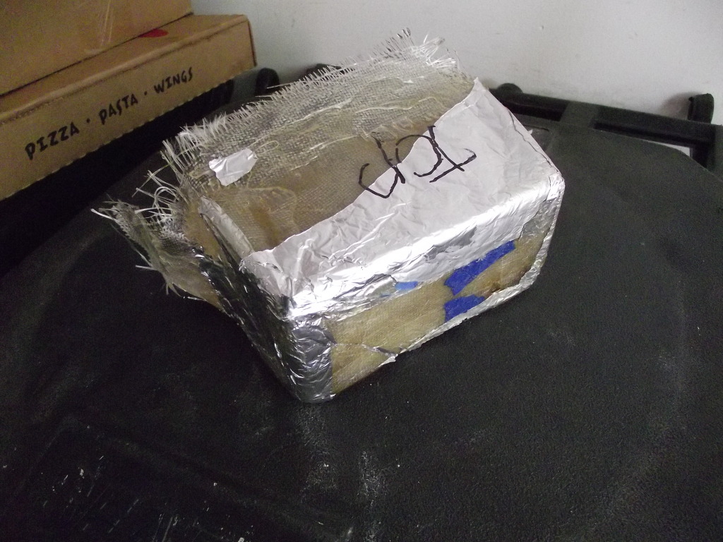

foiled it to help release the fiberglass

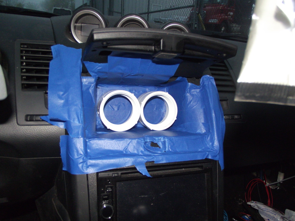

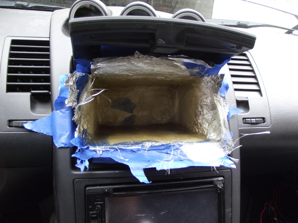

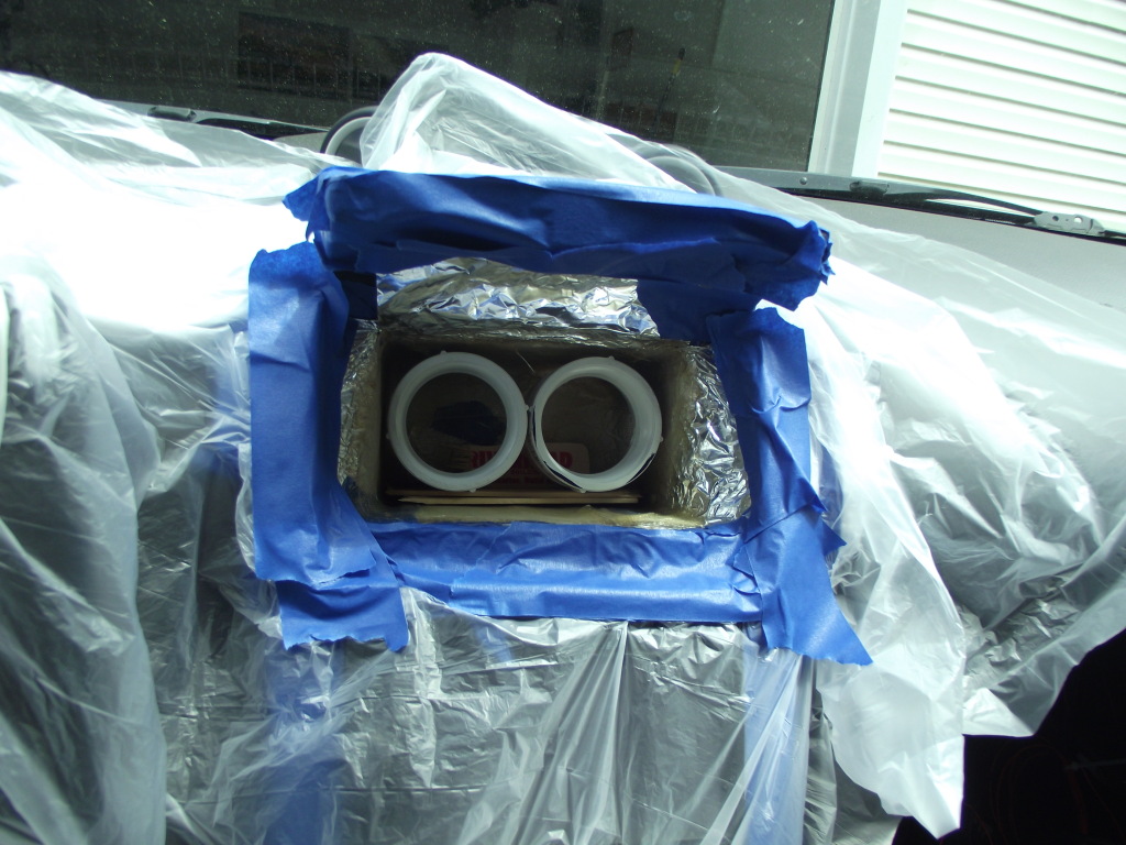

the set up
always use protection
first layer
now im waiting for it to cure more to come soon

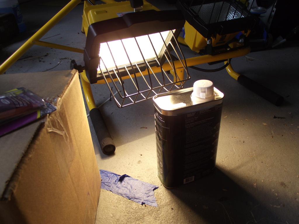

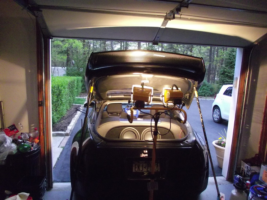

i just spent the last 45 mins holding a work light on it cause i dident add to much harderner i added 54 when i needed about 56 i thought it would give me more working time since last time i did it it was like 80 out i was only getting like 2 mins per batch and the lil harder trick worked and gave me like 6 mins. but the temp dropped so fast when it started to get dark its still tacky 3 hours later oh well i was hoping to pull it out tonight.

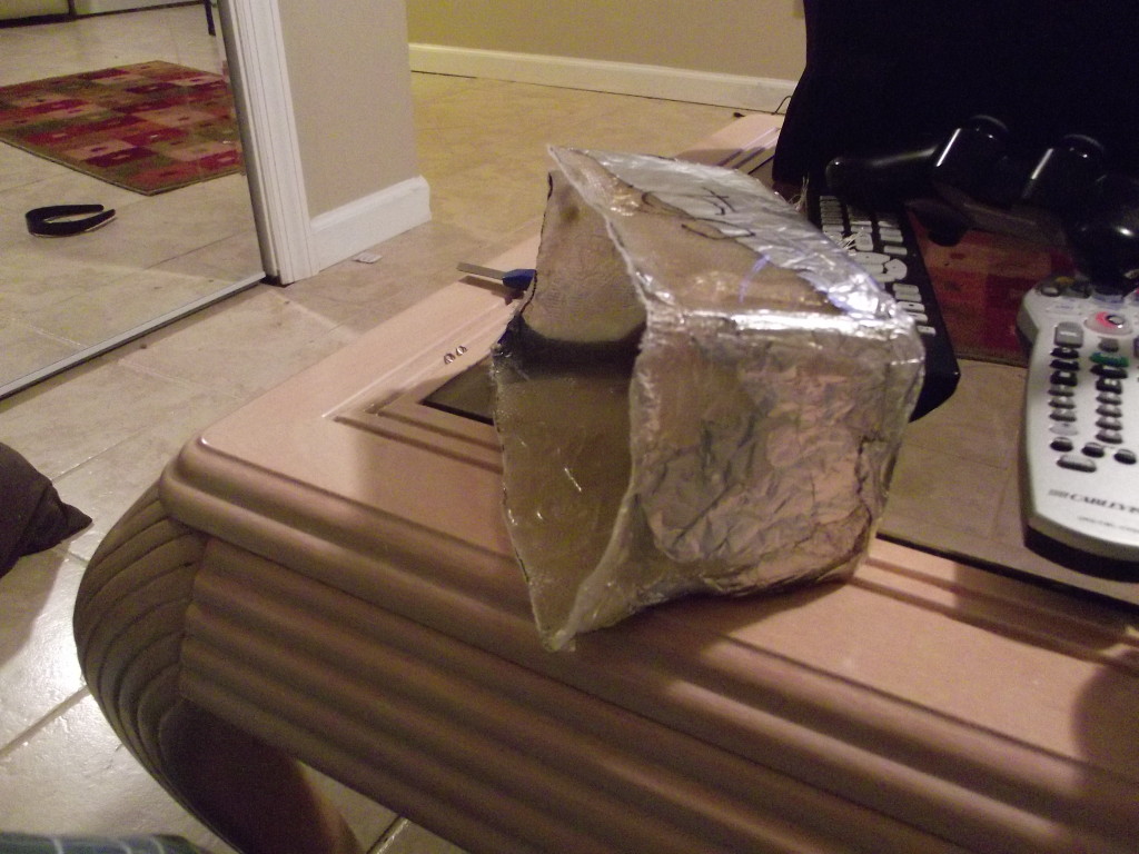

Default Gauge Pod
Here's a quick one I made with abs plastic just never got around to finishing it.
Attached Thumbnails DIY: cubby gauge pod (lots of pix)-gaugepoda.jpg

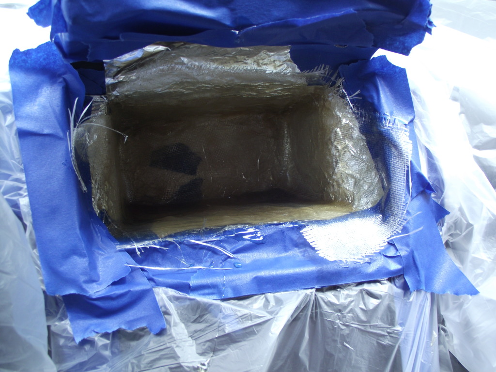

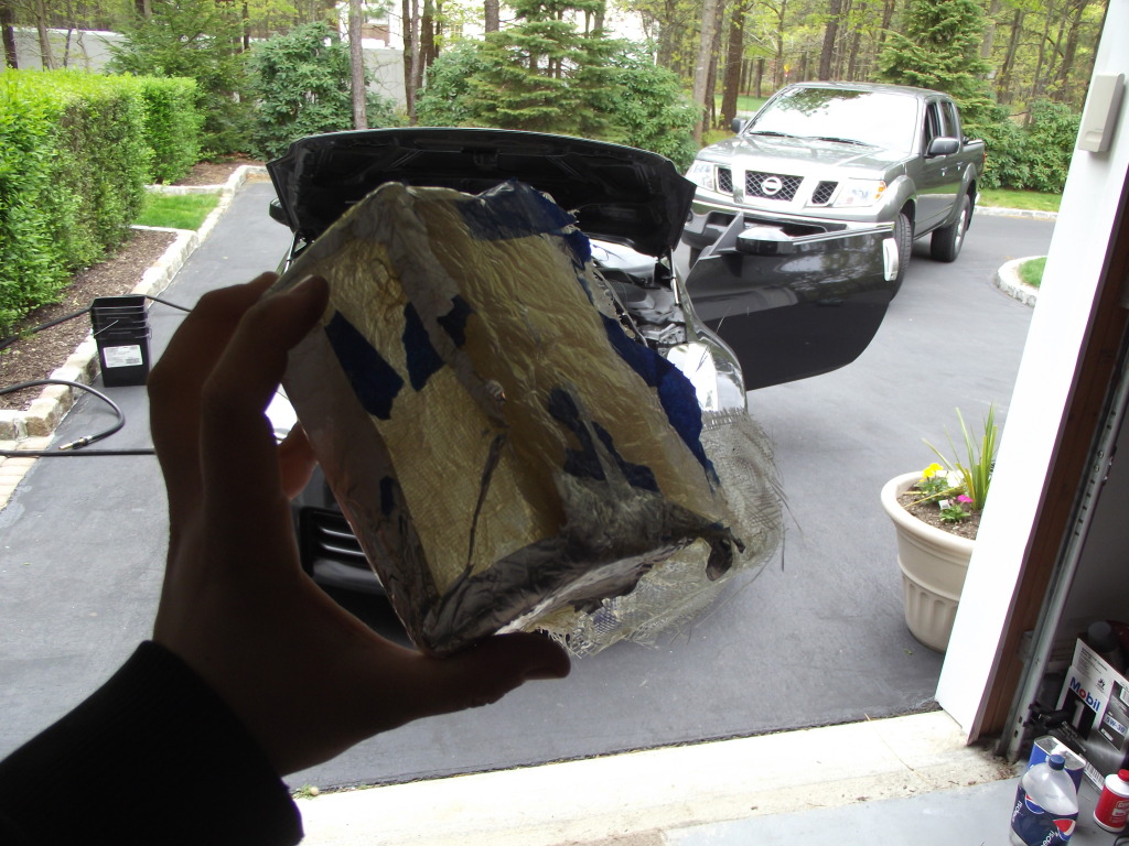

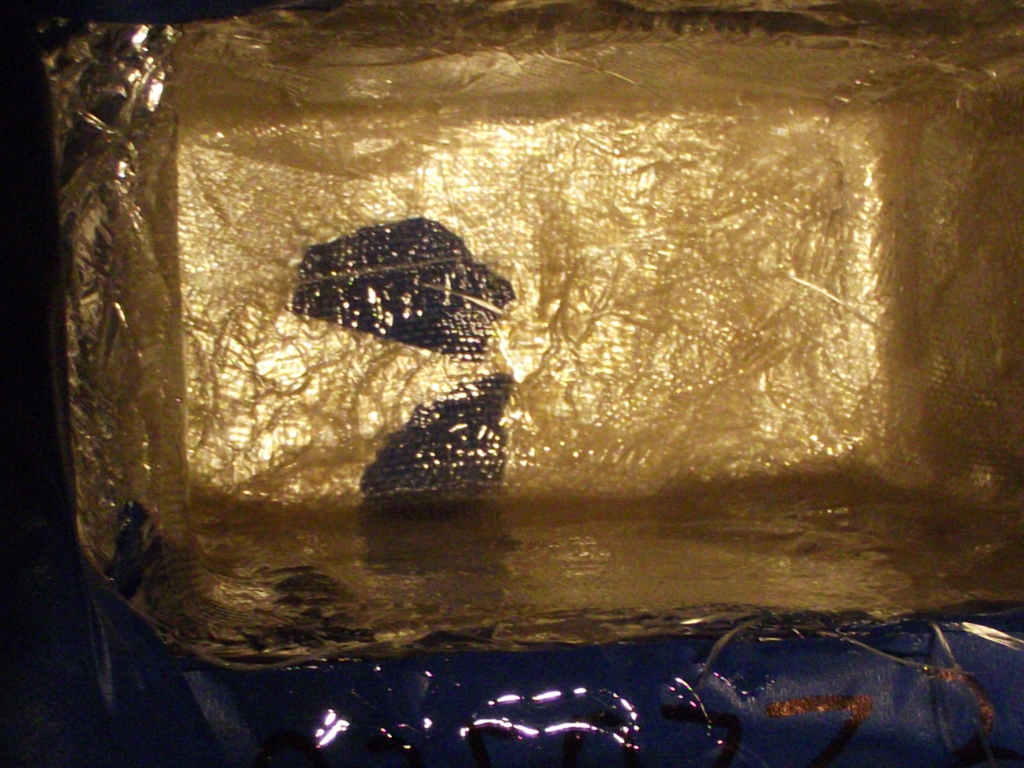

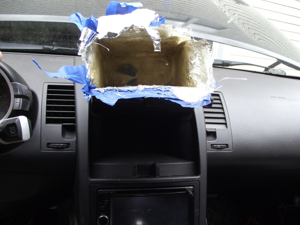

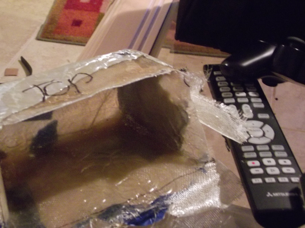

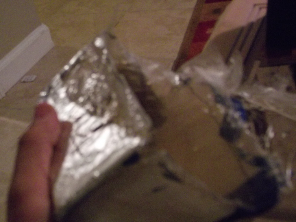

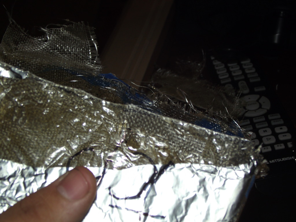

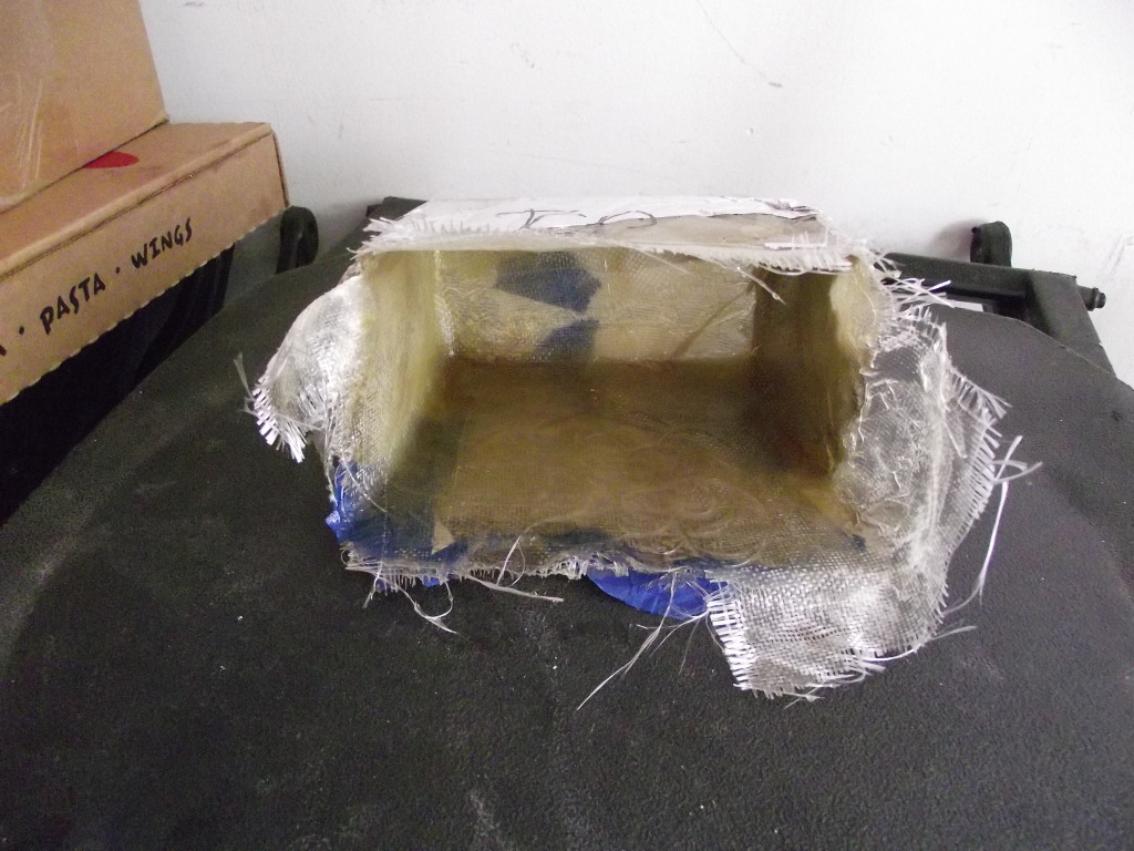

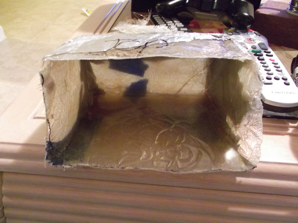

new pix in just a few i rushed to beat the rain but it came out pretty good i trimmed it up a bit but its still pretty rough and un even.
heating up the resin
new stuff
easy clean up from the other day
more rubbers and some cut up fiberglass
sorry no pix during the heated resin was curing fast but here some after it set

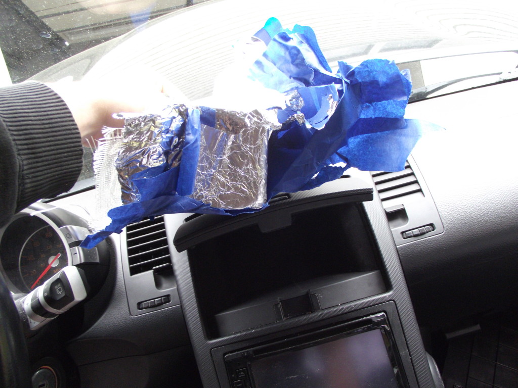

the start of the removal
like it never happened
