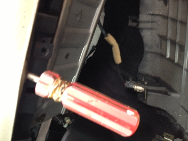

Okay so I bought a totaled 05 350z with all the body work fixed all it needed was the passenger dash airbag, so here's what I did to fix my airbag issue, I went to my local junkyard bought the dash airbag for 350 and its basically plug and play
Step 1- make sure there is no current in the system or when u plug ur new bag it may deploy lol that said just pop hood and disconnect battery and wait 15 mins
Step 2- you will have to remove the bottom dash there is 3 bolts I counted could be mistakes the first one is when you open passenger door where the vent is that has the Z emblem on it there is one bolt remove that first it's deep in there but you can see it. There is one bolt by where the cigarette lighter is just above it and the 3rd one is just below the z vent but you have to unclip the bottom door molding to see the bolt just remove it with a flathead by popping it out if you remove the other 2 bolts and just look you will see 3rd bolt
Step 3- now your bottom dash is removed you will need to unscrew the 3 bolts along the dash you can't miss them and the last one that holds the airbag in is way up there you can see it if you stick ur head up through the bottom it's a 14m gold bolt you will need a deep socket you can't miss the bolt it's back there
Step 4- now that the back bolt is out and the 3 screws along the top of dash where the bottom cover was you can now pop it out there are clips in the back towards windshield so pull towards you and then up
Step 5- now put your new dash in make sure battery is disconnected and plug up the airbag it's one clip.

First bolt
