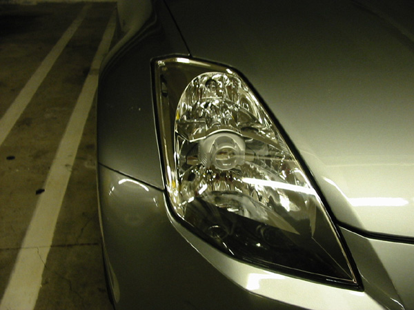

oh yeah forgot to post a pic of the final product:

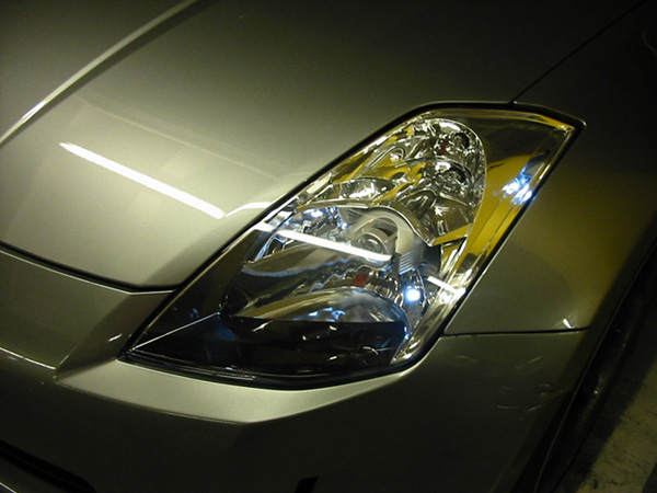

and one more with the led lights on

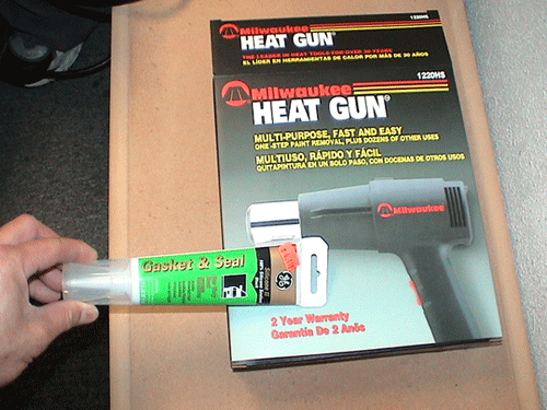

heres a pic of the heat gun and sealant that we used.
