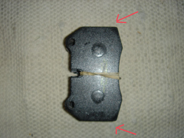

They arn't willing to shave the pad!!
And when you say shave the pad, you talking about the top and bottom edge, so it slides in the caliper easier??
Like i have put in the picture??

Shave The Backing Plate, Not The Pad Itself!!!!!!!!!!! Just where you have the arrows in the picture. It doesn't take much. I used a table grinder....I'm they have something there at the dealer. Hell, take it back home and DIY.

Yes that what he is saying.

Alex, don't tap them in.....just grind them a bit. It really isn't much. I did like three passes on the bench grinder on each side and they fit nice. If you were close, I'd do it for you. But, you're on the other side of the pond....See if the shop will do it for you or go to another shop. I would say at least to NOT tap them in. You don't want to break anything. Plus, remember that you have to remove them eventually and that would be a real pain in the a$$ if they were wedged in place. It's just not safe to tap them in...they're a moving part....they can't be too tight of a fit.

So how much would you say is needed to grind off!! 1mm each end?? Surely this could be done with a hand file??

It's a small amount. You would probably get better results with a hand file because you don't grind much off at a time. Just take your time and they will work. Just keep filing and testing. You will know it is right when they drop in with a snug fit. Also, this fitment problem only applies to the fronts. The rears drop right in. I called Hawk about this and I was pissed. Oh well, just another lesson.

Grinded a small amount of and fitted the first time!!! It's not a very good show by Hawk though, are they planning on sorting this issue.
