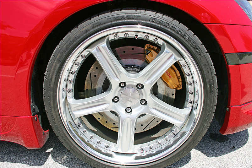

I didn't install the spacers behind the hub.
I'm lowered on 350z S Techs and there was no problem getting he alignment within specs. The car isn't super low.
