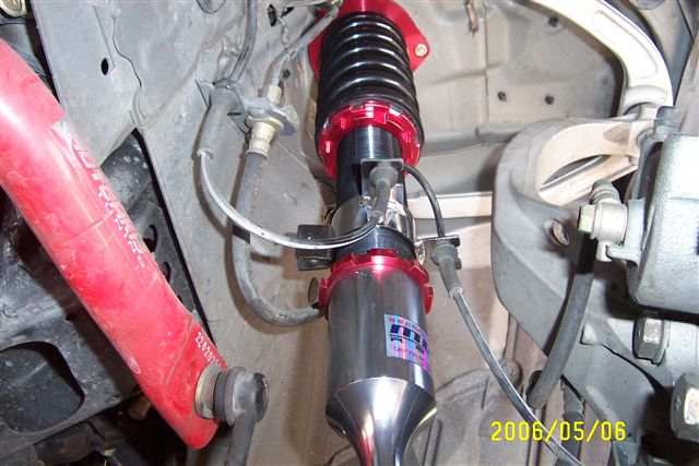

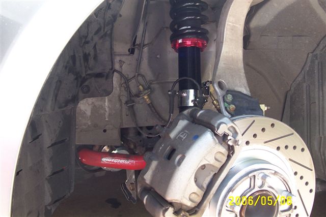

Installed Mine heres some photos enjoy!
Attached Thumbnails Megan Racing Coilovers-dcp_0456.jpg   Megan Racing Coilovers-dcp_0458.jpg   Megan Racing Coilovers-dougmed1.jpg   Megan Racing Coilovers-dougmed2.jpg   Megan Racing Coilovers-dougmed3.jpg
