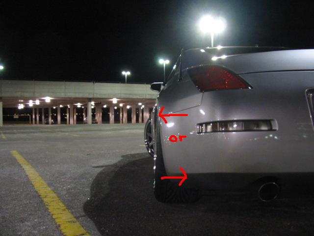

Hello, I have a question to ask about the rear camber kit for our 350z.
I currently have -3 degree of camber on both of my rear wheels and I want to purchase a set of camber kit to fix the problem.
My question is how does the camber kit work?? I mean will the camber kit pull out from the top of the wheel to make the alignment straight OR will it push in from the bottom of the wheel to make it straight??? I have attach a picture to help describe my question..Hope you guys can understand what I mean..
Thanks for your time, any answer will be appreciate.
Matt

Get the SPC kit! Comes with arms and bolts for about $250 and you can install them yourself(I used a Dremel). The way its set up it'll pull the bottom in. It can bring you back to factory specs and will take you to or near 0 camber for drag(which I was too chicken). Now don't freak out after you install these parts when you see your wheels pointing in strange directions... go get an alignment.

So it will push the bottom in right??
Just need to clear things up.
Thanks
Matt

Yes and your alignment guy will adjust the kit accordingly to your instructions.
