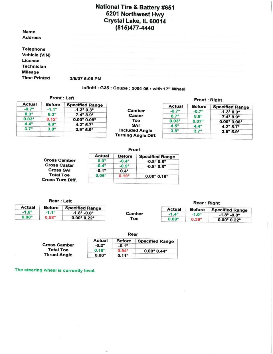

Well i had the car aligned using coupe specs (I have a sedan on coupe and Z springs). My rear toe was way off. The front of the rear tires were turned outward - like .5! I'll try to scan the sheet tomorrow. But get your car aligned. My G tracks true and is divine to drive.

Well, it turned out to be a toe problem. It seems that the rear toe moves for some reason. The bolts seem tight but the ready out from the alignment said they half a degree off. So after a two months and 100o miles, I have chewed up tires, toe bolts that dont move anymore, and a rear end that doesnt wiggle anymore.
The alignment guy tried to blame that the tire tread was the influence of it all but I highly doubt it. Here's the tread I started with all the details so I dont get started with it on this:
