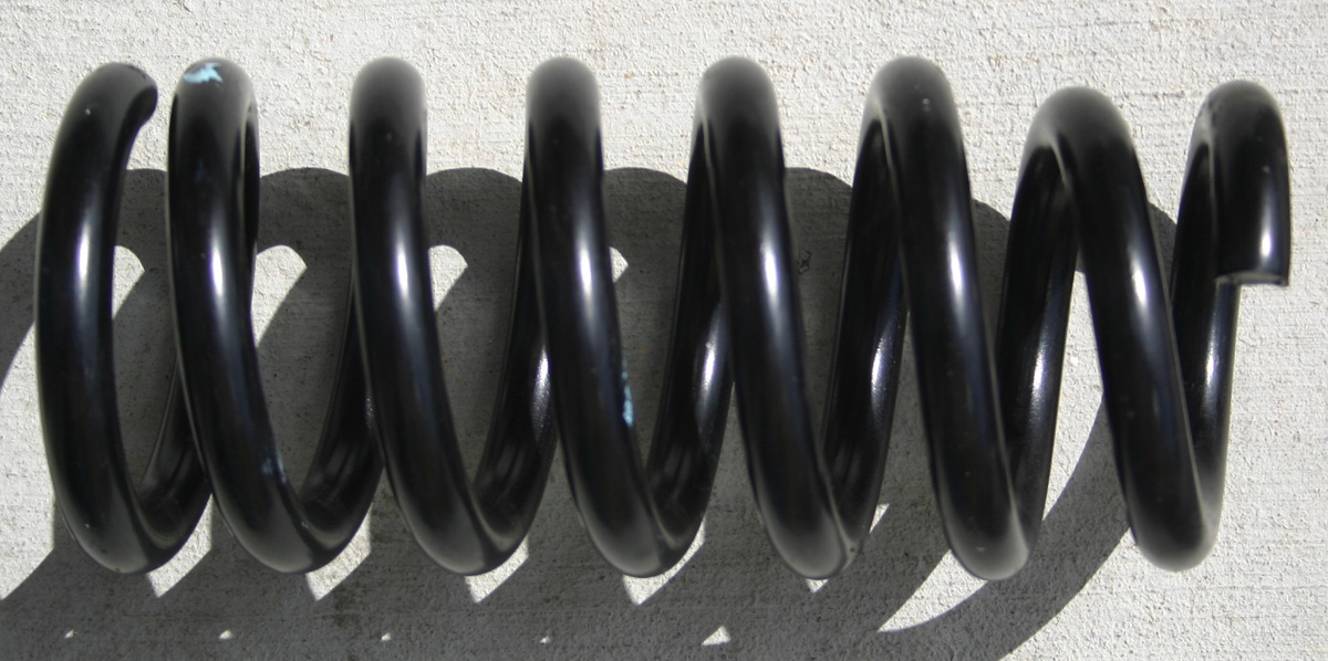

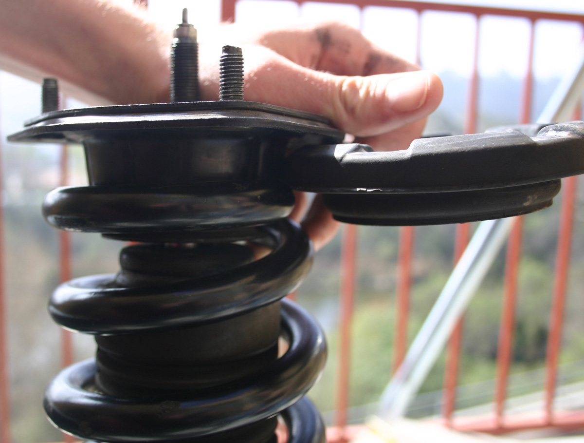

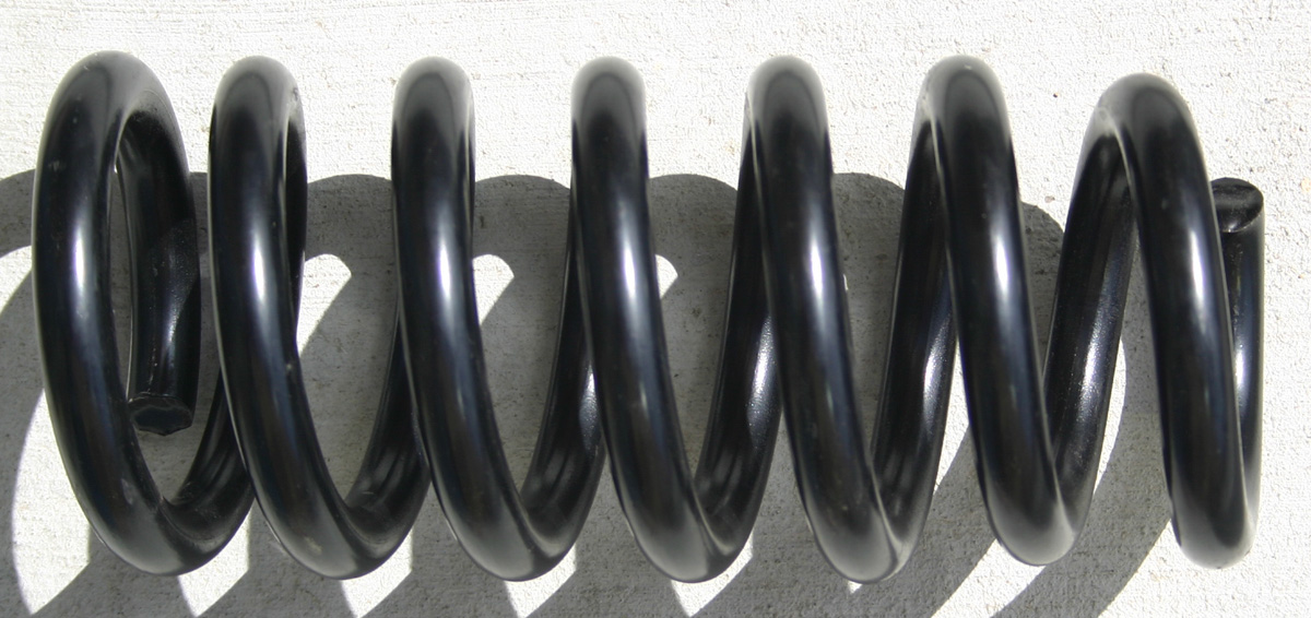

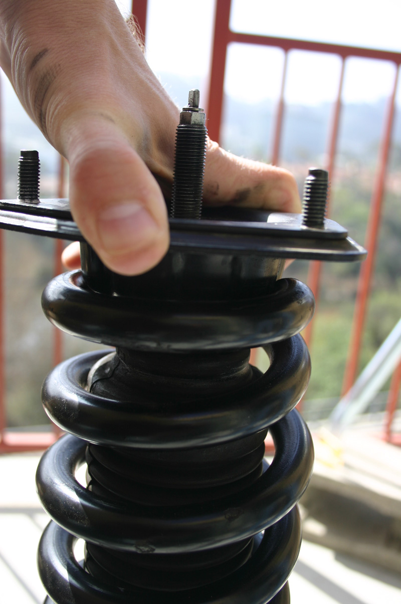

Old Mar 16, 2007 | 10:06 AM
John's Avatar
John
Posts: 4,869
From: San Diego, CA
OK, my little dilemma here. Note in the first two photos how the coil diameter decreases at the top of the spring. On the third photo, note how the inside of the top coil contacts the inside of the strut hat. On the fourth photo you can see the rubber mount won't fit without cutting off the bottom portion.
I'm a bit hesitant to complete the install as I worry that the contact between the inside of the top spring coil and the strut hat will apply a lateral force he shaft of the strut - thus ruining the damper...

Interesting... Mine was not like that at all... The rubber mount and hat just slipped in on top without a problem for me. It appears that either your rubber mount and hat may be oversized or the nismo springs may be undersized.
Perhaps you might have got the wrong nismo springs? Although, it does look pretty identical to mine...
edit: My springs coil diameter shortens a bit at the top as well. Still doesn't make sense why it wouldn't fit.
