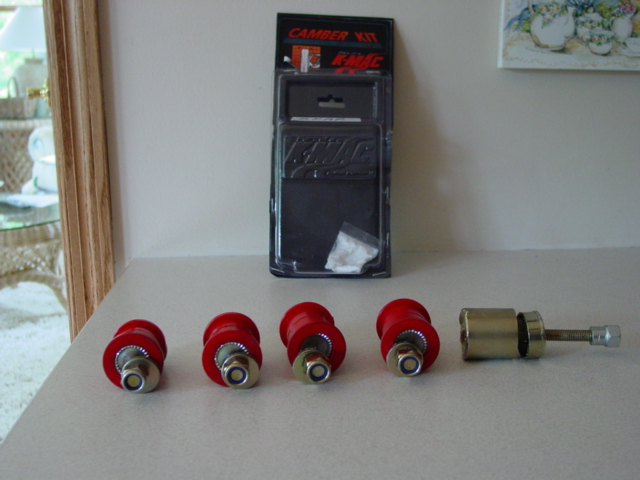

Finally, I received my rear camber kit from Australia. I am expecting the front kit any day since they shipped them separately.
It took longer to get these than I was told. Originally I was told 10-14 days, in reality it took longer than a month.
Apparently when I ordered the kits they were not in production yet and there was some confusion. I dealt with Kevin over at K-Mac and he was a great guy to work with. He gave me the front kits for free because of the confusion and delay I experienced so that made me real happy. All four wheels cost me $344.00 with shipping.
As far as I know I am the first Z to have these kits.
Here is what they look like.
Jeff
