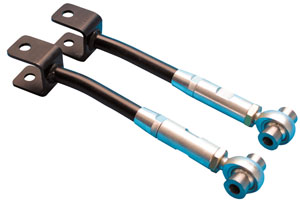

Stillen has some rear camber arms coming soon. Not too sure I want rod ends for the street though:

I just contacted those folks to see if they can shed some light. Just like downshift said, Last tiem i checked you can only ajust the front via longer adjustable arms. We shall see.
Also last I checked the rear could only be done with adjustable rods like shown.
PS- where did you get that rod picture?
Right now my buddy and I are making adjustable rods for MUCH less then JIC is selling them for. IF the market is already flooded, I may just back out and stick with a set just for me

"where did you get that rod picture?"
I pm'd wadd, but I thought I'd share. On the Stillen web site, I subscribed to get E mails of updated products. They sent this a few days ago. No pricing though. I'll call tomorrow and hopefully find out.
My alignment is OK now, so no big hurry for me. I'll wait and see what everyone is offering. I wish 350EVO would post pics & pricing.
