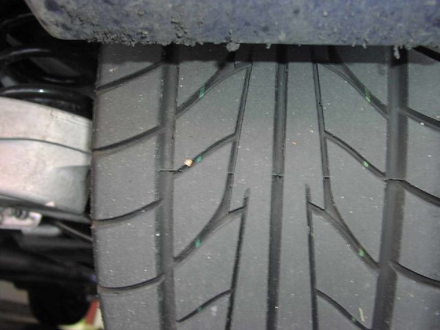

I saw EJ's car and man is that feathering ugly so here is my car as of yesterday (close up of tire, no feathering handles like a 200k car!
Attached Thumbnails Eiback Pro Kit does stop the understeer AND tire feathering (pic to prove it!)-nofeathering640.jpg

to be sure, I think that the SAME car has to have feathering, add new tires (exactly same model) and install springs (keeping align the same) and re-test. there are just too many variables here. No way I run out and buy springs based on that experiment, do I hope there is a easy cure such as this?? DANG right I do!!!!, It just isn't enough evidence to run out and do it.
Did you have it before then added the eibachs and now DOn't????

MaxHax, nice car and nice setup! Did you have the bounce/purpoising prior to the Eibachs and has it now been eliminated?

Default Wrong picture?
That picture looks like the right rear tire? Do you have any of the front tires?
Vance

I had feathering and it is gone. But I changed the tires and springs pretty close together.
A picture of the front won't matter because there isn't any feathering.
Feathering looks like a bunch of little scratches every 3 inches around the inside of the tire.

Originally posted by slay2k
What does feathering look like ?
here you go
https://my350z.com/forum/attachm...=&postid=163390

So, those 2 horizontal lines are "feathering" ?
I fixed the 2nd link since it doesn't work, but in that picture I don't see any of those tiny "scratches" or lines..
Where's the feathering in that pic ? Someone define it better for me plz

The feathering is the black/grey patches you see on the inside edge of the tire (right side on that picture). The black and grey are low/high points of rubber. Because it does not wear evenly, some points are high, some are low. The tire than makes "noise" which gets gradualy worse.
What the dealers have been doing is fliping the tires (install the left in the right). To do this you have to remove the tires from the rims and re-mount them properly. This makes the inside edge be the outside edge, thus (sometimes, depending on the alignment) getting rid of the noise, but not the problem.

You've proven nothing at all. The rears don't feather, only the fronts.
