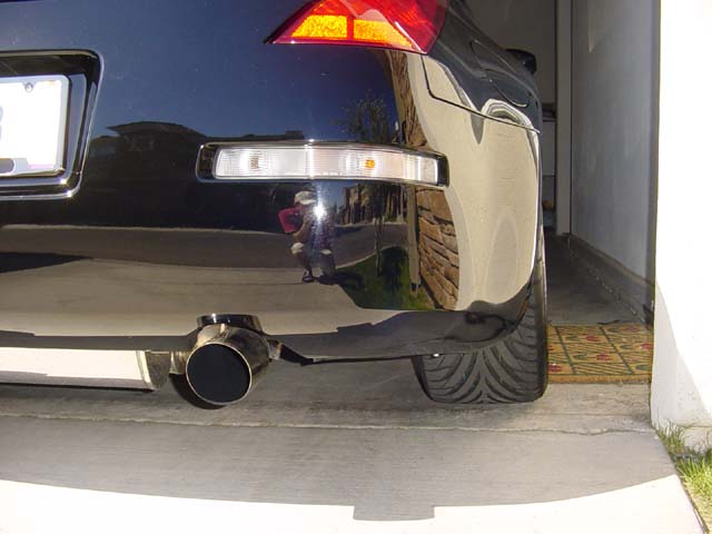

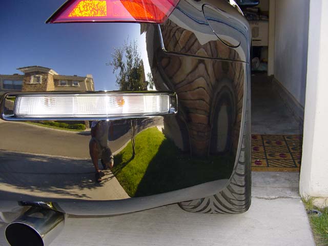

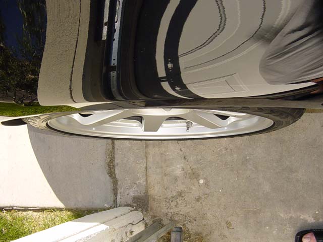

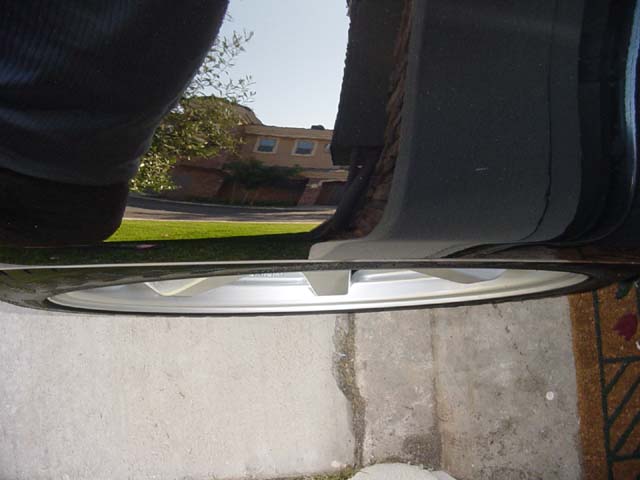

Thought I would post some before and after pics. First photos are no camber/toe adjustment after lowering the car close to 2". Second photos are after installing JIC camber/toe rods. Thanks to Richard at Dyno Comp in Scottsdale for helping dial it all in.

Great reference pics- Did they tell you how many degrees they were off after lowering? What did you set them back to? -1 degree, 0?

With no adjustments it was close to -2.7 deg. After he was able to get it to -1.3 deg . Cost was around $1k for the parts." Stillens camber/toe rods are JIC". I tried to go with just the Camber rods but I could not get the alignment dialed with less than about -2 deg. So I had to pony up for the traction as well. As far as any noise, there is none. The components are very well built. Over priced but well built. The front toe/camber with about 1 1/2" drop are fine.

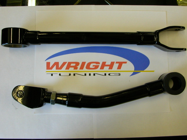

350EVO rear arms....coming soon
