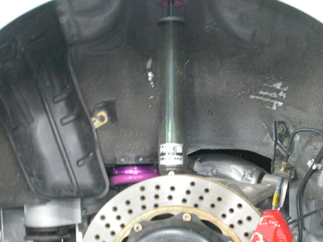

Here is a Pic I just got today:
This is the rear of the car...it got the sticker clearly shown, but the pics suck. Sorry.
