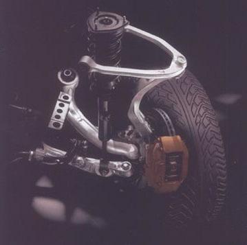

THe knuckle is the central part of the suspension....everything goes to this....including the wheel...the bearing (hub) is in the center (plus or minus) of the Knuckle (spindle)
The ball joint is part of the Lower control arm...IIRC. can be pressed out, but if you broke one, you broke both.
THe LCA is the part in which the bottom of the shock attaches...the ball joint is at the meeting point of the LCA and the knuckle. I'll try to find some Z specific pics
here's one
http://www.350z - tech.com/w/images/3/31/Service_Manual_Suspension_001.jpg erase spaces between the hyphon and 350z/tech
THe part that has the lug bolts on it (noted as "front axle") is the knuckle.
On the wheels....make sure to get them spun on a balancer...if you injured the suspension as bad as you say you did, then you bent your wheel as well...Suspensions are meant to hit potholes while going straight...there is something missing from your story

front camber kit? I'm assuming you are referring to an aftermarket upper A arm? If so, replace that first...then see if the knuckle is bent...often the weakest link takes the hit...and often aftermarket is synonymous with weakest link.
I will recommend again to have them rebalance the wheel....and watch it when its on the balancer to ensure its not bent.

WTX350z you are a genius. I went to go look at my car and the subframe damage wasnt caused by the pothole, but i guess by the previous owner at my expense. Its fairly slight to say the least though. The balljoint they showed me just was a bit looser which isnt really a huge factor, because an 04 350z isnt to have the tightest balljoints anyways. Mainly my front camber arm got destroyed which is why they change alignment, but whats great is im getting an adjustable arm that comes with a new balljoint. Im just relieved that it wasn't as bad as they made it be. They are going to realign everything, and everything should be good. But just a question, would u recommend getting moonface roll center adjusters? i think if i had that, my camber arm would be more leveled for a less likely chance of me bending my camber arm again? thanks!
