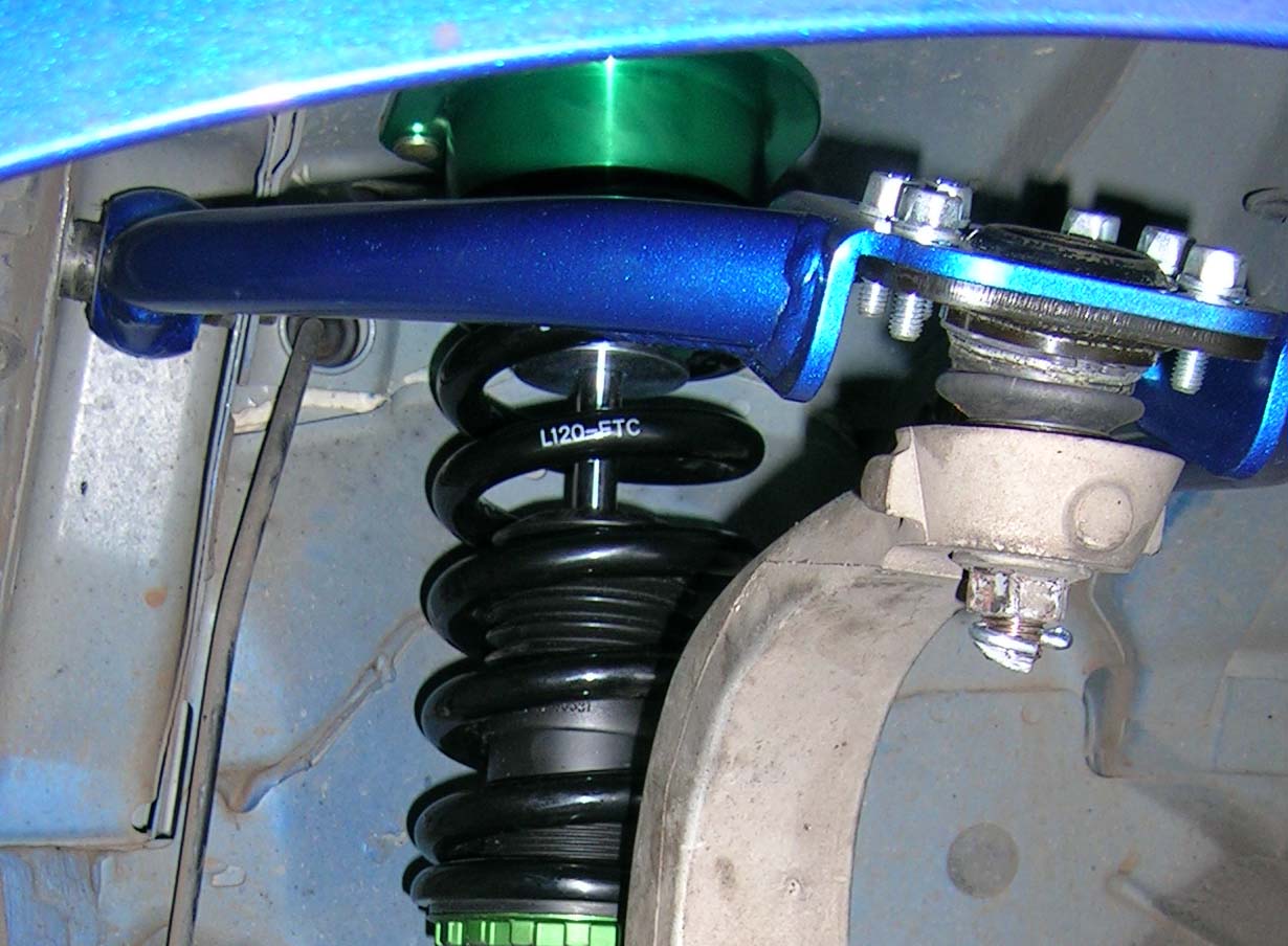

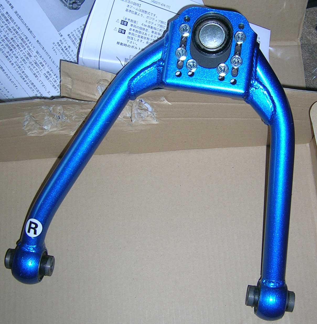

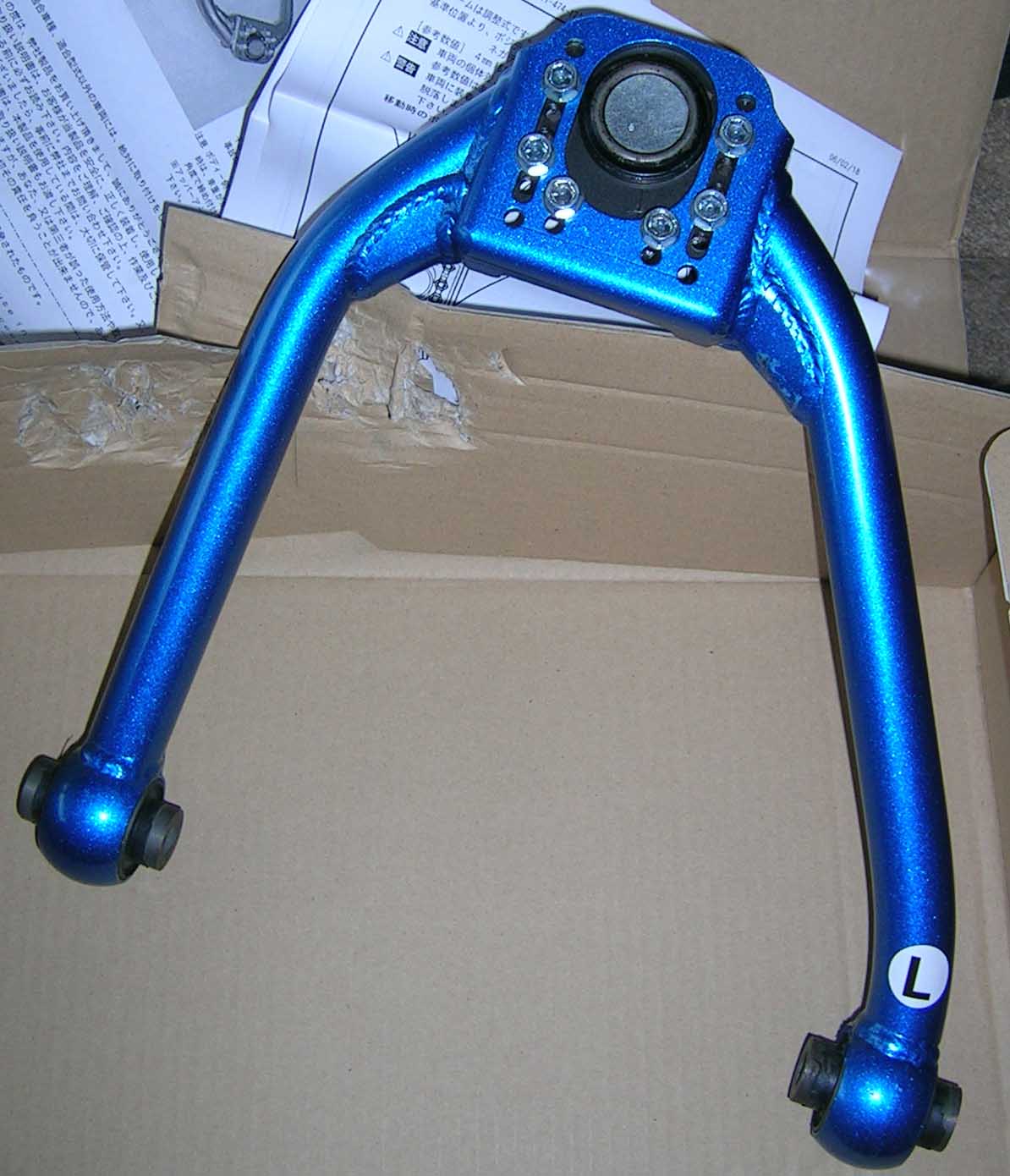

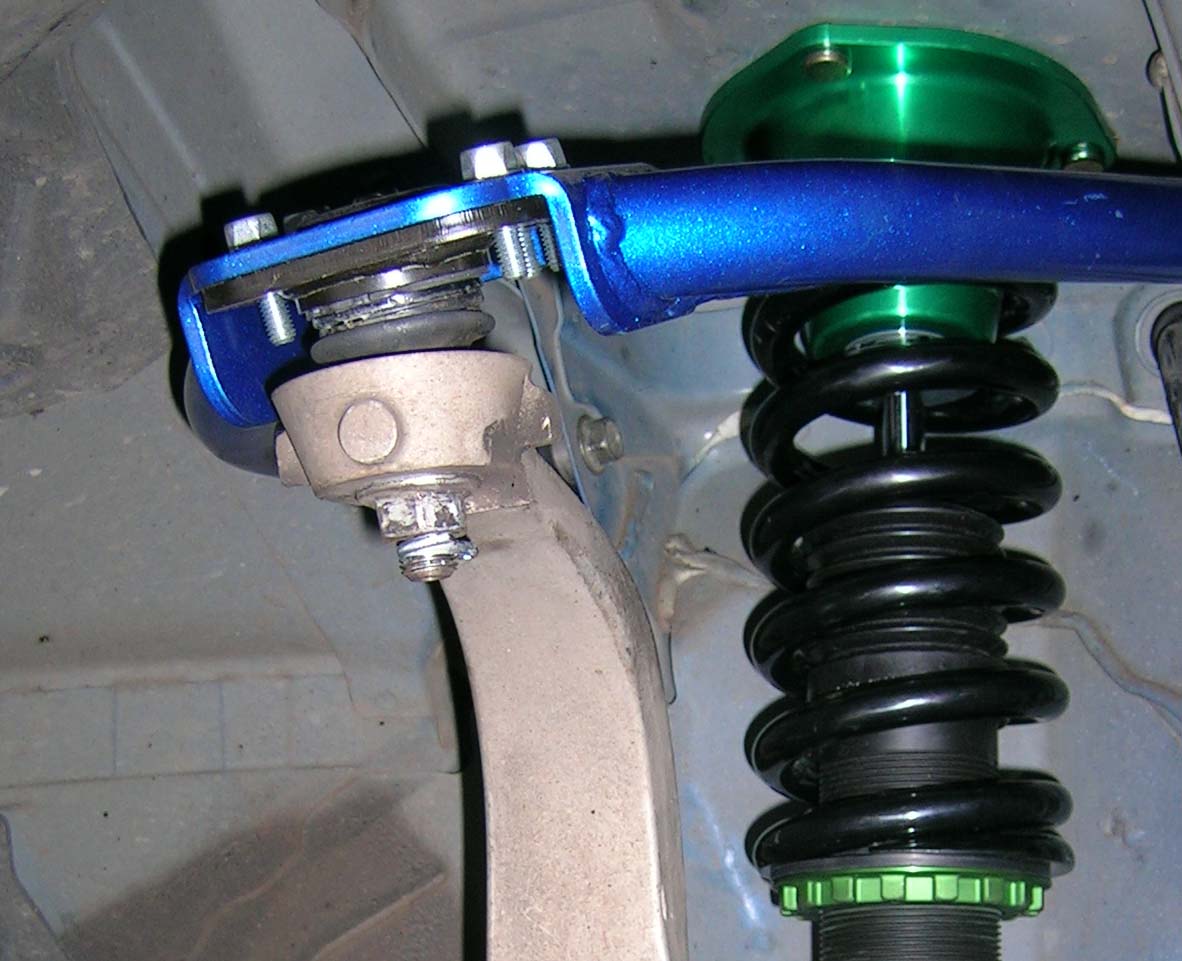

I started thumbing through some pictures I took when I installed the Cusco A-arms and saw that the ball joint assembley is a seperate portion all together like you were saying. It appears to be connected to the A-arm by 6 alen fasteners. So its modular.
For postarity sake and clarity for any one that is following for some odd reason I've attached the pictures I came accross.
I will see how the energy boots work. If there is any play in the joint then I'll be giving you a call for the joints. They realy dont seem to be greased or or have any ports to grease them. That and the rubber they used seemed to be proned to dry rotting. Hopefuly they fixed that.
