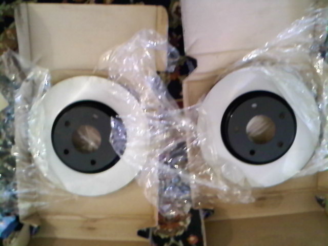

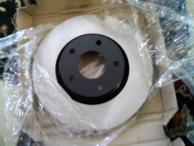

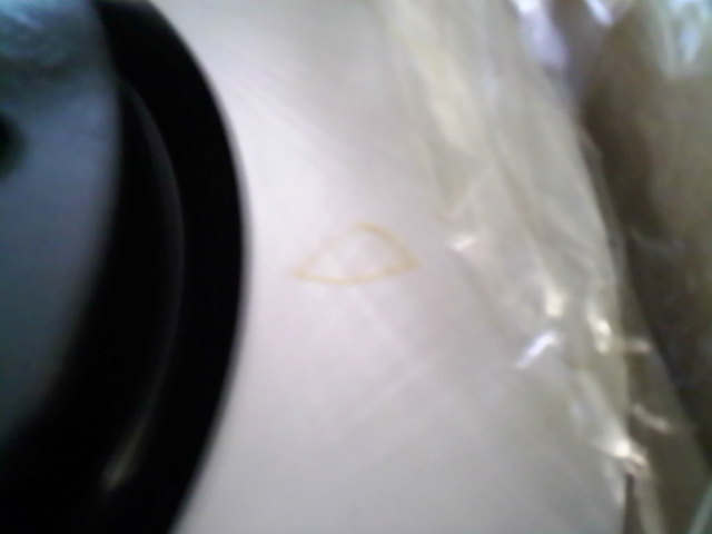

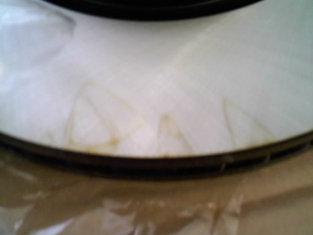

today i received Centric premium rotors front from Autowarehouse!! can't wait till i install them tomorrow.
I thought the rotors surface would be SHINY but it's not kinda disappointed.) Also it has some light brown crap on the surface that i can't get rid of. i'm sure i'll go away once i bed in

Originally Posted by 350zRiot
Is there a certain side the rotors have to be installed or doesn't matter?
No, they are unidirectional. Can you post a pic of the rotor surface? They should look freshly machined, often with grinding witness marks. Zinc plated would be even better, but Centric doesn't do that. They are straight from China as-is.
light brown crap is like liquid. I used the brake spray to remove most of them but some of them are still on it, not much. ( these pics are before i cleaned them) Also little bit of black stuff. These are cell phone pics sry.
I'm installing these tomorrow morning so i hope i get ur respond fast.
Nice. I like the black hat. Assume it is anti-corrosive paint.
Oh yeah. it might be anti-corrosive paint. I like the black hat too haha i hope it doesn't rust FOREVERRR
I expected the rotor surface to be more shiny so that when installed, it stands out behind the rims.
The stains are just surface rust -- nothing to sweat about. It will disappear the first time you hit the brake pedal hard.
The black stuff is a type of electrostatic coating. It will keep the rotors from rusting. Well, at least until they hit about 900°F, which is pretty hot. Above that the rotor will expand enough to flake off the coating, especially on the outside diameter. Don't ask me how I know this....
Just be sure to bed the pads in correctly and you should be OK.

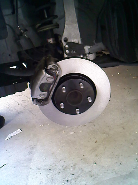

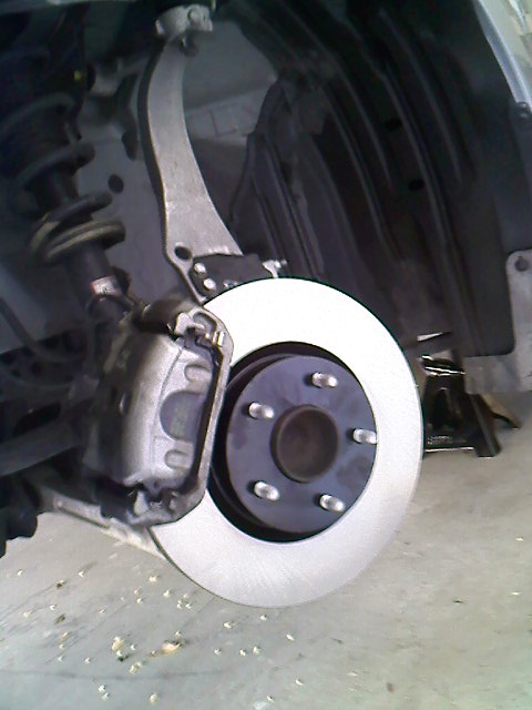

Finally! i'm done installing pads and rotors. it took about 5 hrs
on the HAWK pads' case it shows the bedding instruction but it only tells me to do 3~4 hardstops. Should i do about 6 of them?
Ima gonna bed them today at very night so i don't have to drag my pads along the way

centric rotors with hawk pads
Attached Thumbnails HAWK hps received-0709001616.jpg   HAWK hps received-0709001616a.jpg   HAWK hps received-0709001617.jpg   HAWK hps received-0709001617a.jpg   HAWK hps received-0709001617b.jpg
