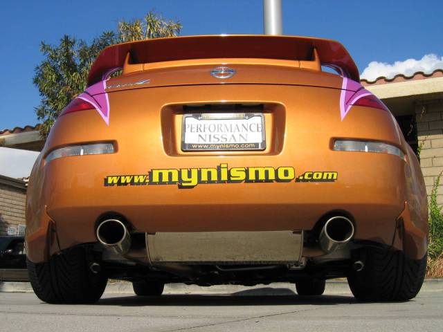

Here is a rear shot of Jeff's Z with S-Tune and Nismo Wheels. and 275/40/18 tires.
If you are worried about it people are coming out with camber rods soon as well as adjustable upper control arms by both Performance Nissan and another vendor on this board.
Choices will come.
