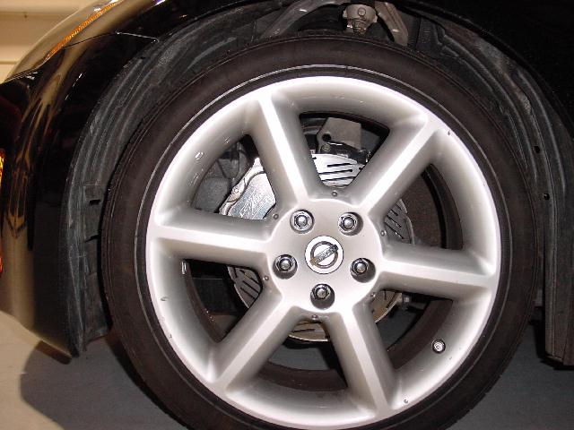

I've had these on for a litte while now and I haven't seen any commentary by anyone so I thought I'd share. I saved like 36lbs over stock just in the front. Does anyone else have these? Seems like everyone has Stoptech? Well, just wanted to see what you think.

"IMO, I don't believe these rotors have adequate thermal capacity or swept area to be effective on a street or track car."
J. just curious has Stoptech done any testing on these... they seem to work fine for me. Is there something I should know that no one is telling me?

The gist of the situation is as follows:
Brakes work by converting energy to heat. They will fade when the rotors heat up to a temperature that is high enough to cause the pads to debond, or when they transfer heat to the fluid and cause the fluid to boil, or when the rotors start to melt.
Typically, the first limit is the surface temperature of the rotor causing pads to fall apart. Therefore, the main goal of aftermarket brake rotors is to keep the surface of the rotor cool, and therefore it will be the primary focus of this post. Keeping the surface of the rotor cool is accomplished in a number of ways:
1. Large rotor mass - a large mass of material will heat up less than a small mass when absorbing equivalent energy.
1a. Specific heat of material (amount of energy it takes to heat a specified mass a certian number of degrees)
2. Use pads that are effective at higher temperatures. Well, this actually sidesteps the heat issue by using a pad that is able to handle the higher temperatures. The problem here is that it is difficult to have a pad effective @ both high and low temperatures, and therefore if you have a high temperature pad on the street it may not perform well.
3. Heat dissipation - by cooling the rotor quickly, it will be ready to absorb more heat. This is accomplished in three ways:
3a. Conduction - heat is conducted away from the rotor face into the rest of the rotor and then into the spindle, etc.
3b. Convection - the heat that has been conducted to the inner surface of the vented rotor is pumped out by air flowing across the vents. It is also convected by air flowing across the external faces of the rotor.
3c. Radiation - The hot surface of the rotor is constantly radiating heat to the outside world.
So, knowing all this, we can see some POTENTIAL areas of concern with respect to these ZMI brakes:
First, lets look at the material property of Ti (pure) compared to cast iron:
Specific Heat - Ti = 522 J/kg/K
Specific Heat - CI = 1X-2X that of Ti (depending on type, from Machinery's Handbook Vol. 25)
Thermal Conductivity - Ti = 21.9 W/m/K
Thermal Conductivity - CI = 80.3 W/m/K
Density - TI = 4510 kg/m^3
Density - CI = 7800 kg/m^3
(all data from http://www.memsnet.org/material , except where noted )
1. Low mass - the very characteristic that makes them attractive from a handling aspect is what makes them "iffy" from a braking aspect. Compared to a stock or Stoptech or Brembo rotor, these have much less mass. Therefore they will reach a higher temperature when absorbing an equivalent amount of energy (unless they can dissipate the heat very quickly). Also, the specific heat of Ti is no better than cast iron (and possibly even worse). However, let us examine their ability to dissipate heat.
2a. Conduction - Ti has poor thermal conduction, and therefore will not transfer heat away from the pad surface as quickly as a cast iron rotor would.
2b. Convection - This brake has very nice slots, and lots of surface area, but compared to a standard vented disk, which basically has a built in air pump and four faces to convect from, I suspect that this brake will dissipate heat no better than a stock brake.
2c. Radiation - would depend mainly on surface area and temperature of the rotor face. Since the rotor surface of these brakes has many holes in them, there is actually less area available for radiation than the stock brakes, and therefore I don't see these brakes radiating any better than stock ones at an equivalent temperature.
So, given all these reasons, it seems unlikely to me that these brakes would perform better than stock ones AT A ROADCOURSE when fade is a problem. However, for street or drag stip use they may be very good, since fade is almost never an issue in those applications.
I would be very interested in hearing any impartial reviews on these brakes to see how poeple like them, and if their experiences are similar to what it seems like theory would show.

Droideka- why the comment? Is that really necessary? These forums could really do without that type of mentality.
D'Oh- I must admit they work pretty damn good so far... I've done some track time and yes they do run a little hotter but I ran a race pad and didn't have any problems. I thought the point of the rotor was to get rid of the heat as fast as possible not hold it in. Isn't that what iron isn't doing? It's holding it in and you need more mass to hold it in. My stock rotors would stay hot long after I stopped where I can touch these ti rotors minutes after.
