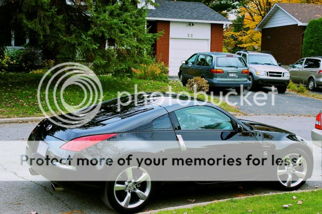

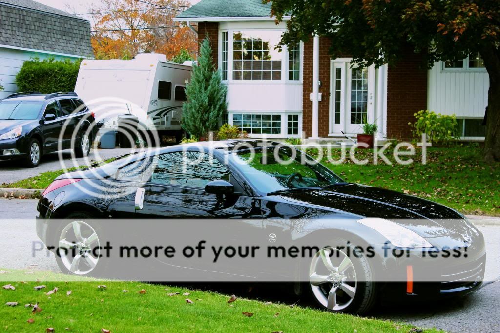

I went to two alignment shops (2 times each) with my 350z and after each time they align the car, my Z still have the same problem. The car steering wheel is not centred. I have to turn it a bit on the right to go straight. I can't figure out the problem. I sat myself in the car personally to center the steering wheel. For now, I'm thinking about a Compression Bushing tear or a steering angle sensor problem? I need your advice. I have brand new tires. I've post my alignment sheet to show you and a picture of my car hehe .

Damn your car looks as fresh as it must have in 06.
