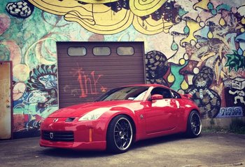

Haven't been on in awhile and just figured id confirm the fender roll on this set up in case it helps anyone out.
Rolled fenders and the 285/30 worked perfect.
Then went with 275/30 next tire set and had re-aligned. still perfect.
Even went up to 275/35 on 3rd set bc I got a flat going to FL, and thats all they had...
Still no issues! Actually this was my favorite combo. way better looking with both front and rear being 35 series tires, and they had an "even" stretch front and rear. They road better too.
Just want to add for a 20" set up.... I think this final combo was pretty good looking!
(245/35/20 275/35/20) on 20x9 F 20x11R +13 xxr 526
With all that being said I'm now in the market for that meaty 18 inch track look
