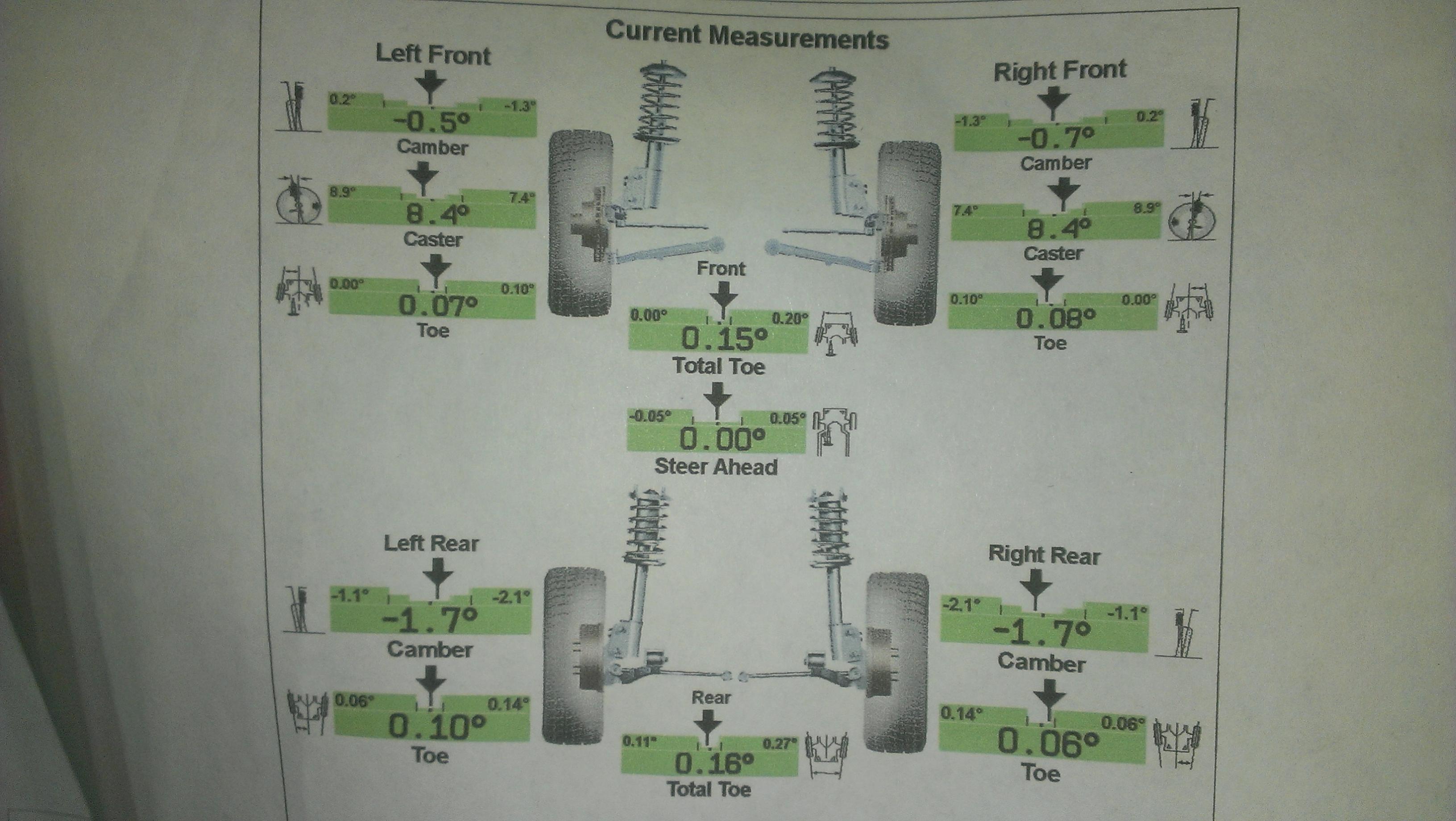

I received an alignment (Sears)before installing the new wheels (stock touring wheels were on) and dont recall it shaking on the way home. I was thinking the balancing wasn't done correctly as the tires were mounted on without being put directly on the car as the camber kits weren't all installed as yet. Anyways, after getting the wheels on and realized it was still doing so, I took it back to be re-balanced. 3 wheels were were about .5 off (guy said that I would not have felt the difference with such a small increment. It felt a little better on the short ride over to a friends house. However, the next time I was driving the car the shake was very noticeable and I received another alignment.
At this point I dont know what else to check out for. I have attached a photo of my most recent alignments since modifying the suspension. The second was with the 19's on. I dont know if it has something to do with my alignment or if the issue is with a component. Some help would be greatly appreciated.

Ordinary balancing just spins the tires and weights are applied to balance the wheels. Road force spins as well as applies force on the wheels to simulate the effect of wheels mounted on the car and moving at high speed. The machine then gives out the high spots and weights are applied accordingly.
Here's some more info:
http://blog.autosquad.com/road-force-balance/
The tire shop I go to puts the wheel on roadforce machine and charges around $15/wheel only if it needs to be road force balanced.
To trace the root cause of vibration, I tried roadforce first as it is cheaper than other alternatives.
