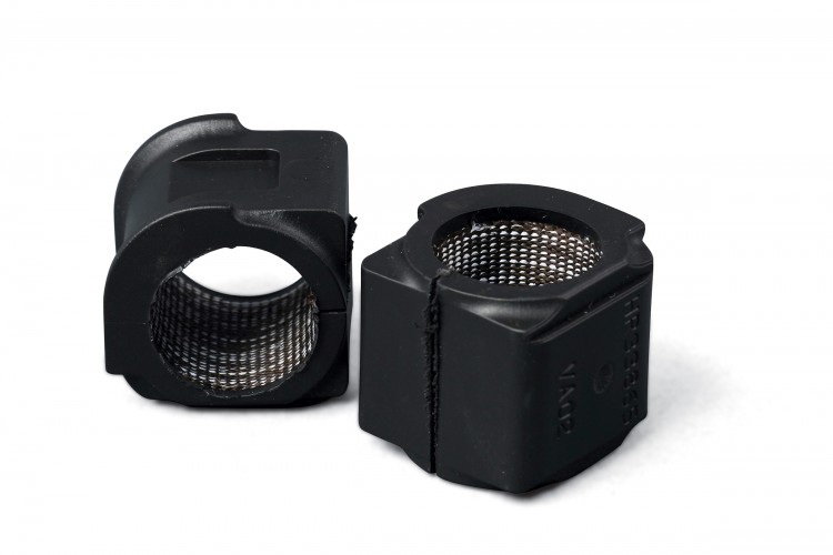

I called up H&R because i was interested in using their sway bar bushings. They don't sell to consumers, and thats fine, but also dont part out just the bushings. Finding these online is hard, since if the manufacturer doesnt part them out, online retailers might not either. The reason I want these bushings is because "H&R Sport Sway Bar kits include exclusive sway bar bushings, featuring a special urethane/Teflon composite that prevents squeaks and eliminates the need for lubrication. No mess, no maintenance, a perfect fit." Those look like they just may work, albiet in 36mm, so i would need lubricant plumbers tape to make up the extra 1mm difference of my 35mm bar. Oh well. I'll order the 35m Energy ones and post here if there is an improvement.
edit 2:
The z1motorsports Energy bushings are 34mm, but my hotchkis is 35m. I called them up anyways, and Jon did seem hesitant, but he said first try Graphite Grease. It has a compound in it that prevents squeaks, i think he said it causes less play. I can get this cheap locally, so if this doesnt work, i see that 'Brothers Performance' has the energy bushings but in 35m. I'll probably keep the marine grease on all of the bolts and No. 18 bracket, but use the graphite on the inside and outside of the bushings.
edit 3:
Ok so no one, i mean no one, carries graphite grease. home depot, adv auto, napa, websites. Even if they do, its the runny spray type for locks, which are crap in bushings. I emailed Z1 again, and asked them what brand they had in mind. I'm seeing plenty of dry powder for graphite, but that wont work as well.
In the meantime, Vivid Racing is able to sell the H&R bushings, the ones with teflon inside. It's $20 per bushing, so $40 pair, $10 S&H, $53 total. These bushings are 36mm to my bars 35mm, so i am going to use plumbers lubricating tape on the bar to give it the extra 1mm required. I should get them next week and then i'll use the Marine Bearing grease. If squeaks still persist, i'll order the graphite grease that Z1 recommends.
edit 2:
edit 3:

I'm excited to hear about the H&R bushings. Very good job on the research! As for the 1mm difference in the inside diameter, that might even be a good thing. Can't wait to find out if these things work - I really want to reinstall the Hotchkis bar. Do you have a part number or link for the H&R bushings. I looked on the Vivid site, but can only find the kit with the sway bar and bushings together.

I actually don't have a part number, and the reason is because the bushings stand alone arent officially listed. I called up and asked them since they sell the H&R bar to start. I assumed, correctly, that they may sell bushings seperately. The shipping is ground, and they will be here next week.
