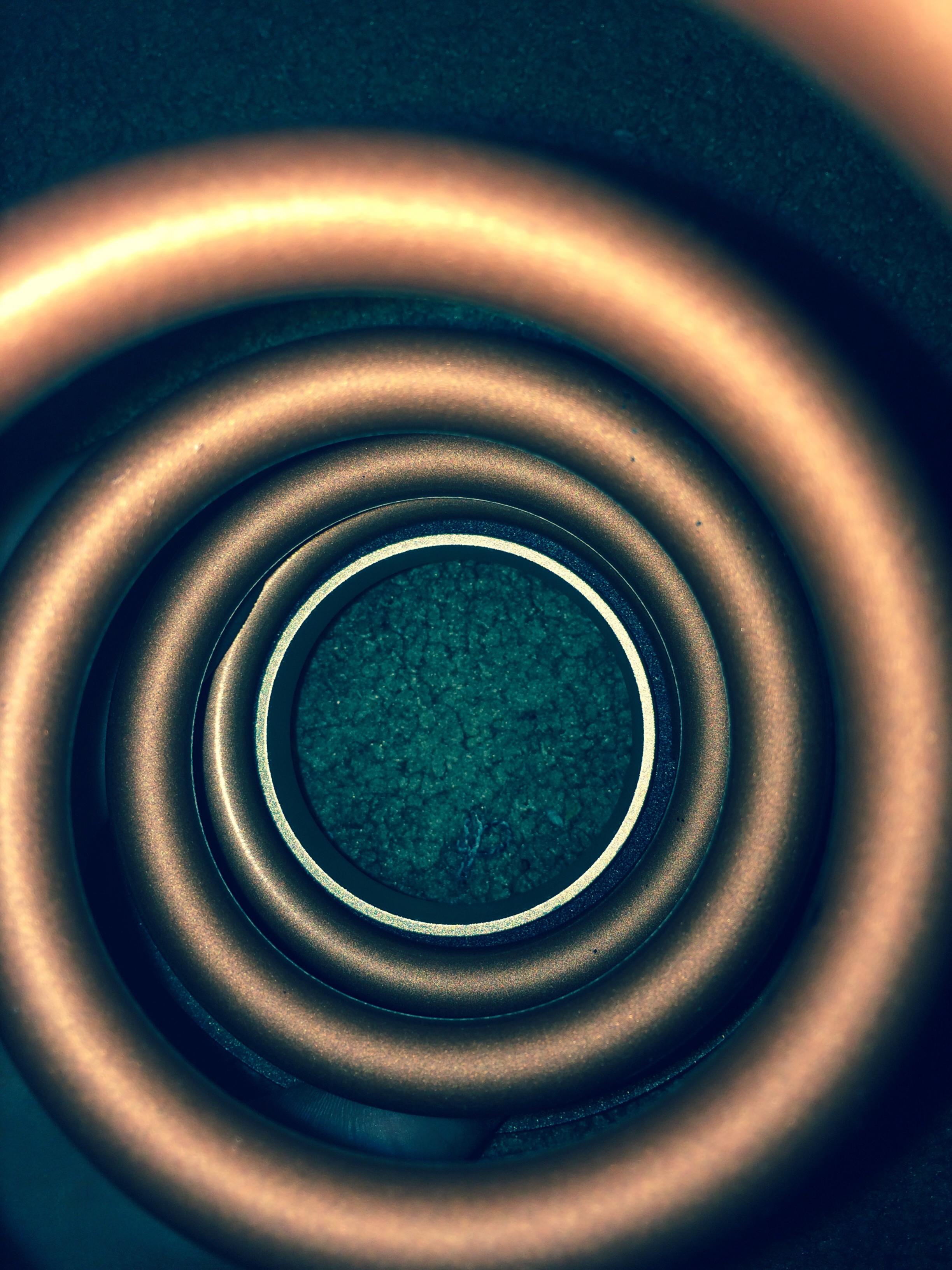

Ok I've finally gotten my swift springs/helpers and the bc racing bucket adapter just came as well. Is the spring suppose to sit snugly around the 65mm i.d. Ring on the adapter or be somewhat loose?

It just moves side to side a little bit... In the picture you can see how there is more room on one side where the black washer is under the spring.
