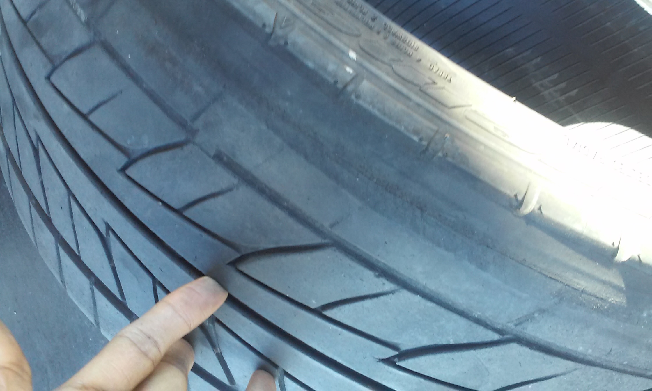

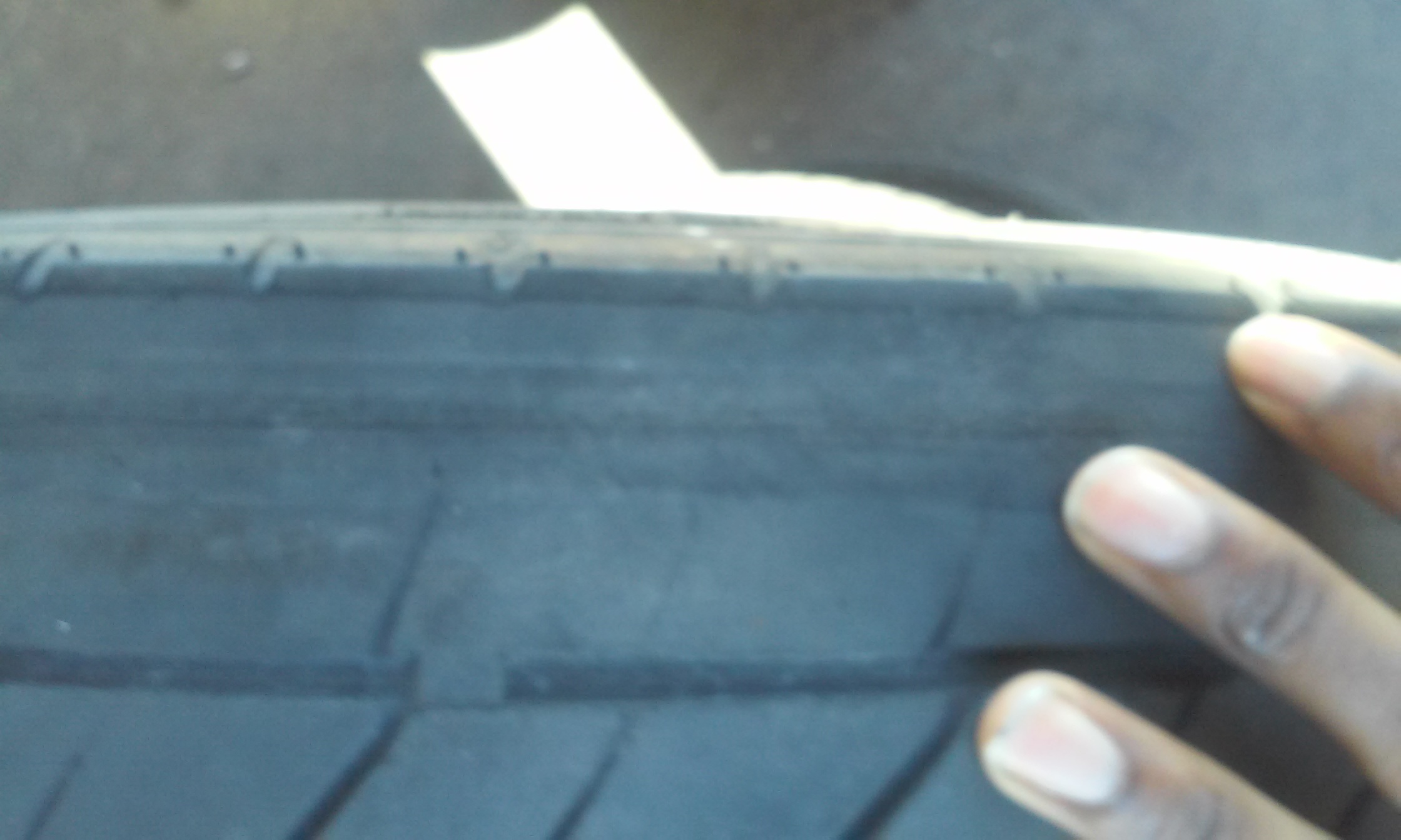

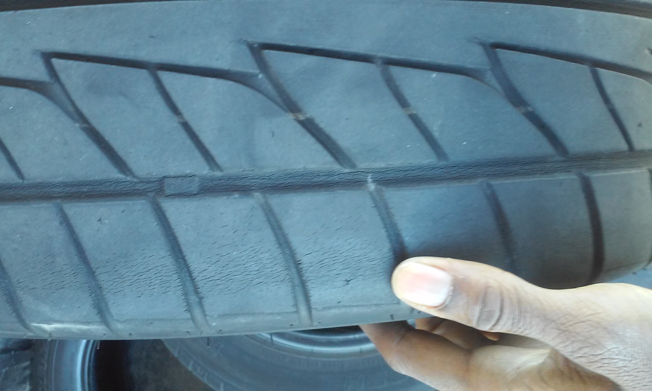

Hello im new to the threads first post with my newly purchased 06 350z. okay let's start when I first got the car it had 19 inch rims, 3 days after I got it. my front right tire went flat, after taking off the tire I noticed the inside of this tire had worn down faster than the rest of the tire ( the tire had about 50 to 45% of the tread and the inside was so bad i could peel the rubber back on itself). I took it to the dealer that I got it from and they took it get an alignment and I was told everything was aligned right. Two months later I had to do the same thing to the front driver side tired it had the same wear just not as bad because i caught it soon. I took it to the tire shop, as the tire was offI looked at the camber and suspension and didn't notice anything fancy both stock. Now I'm wondering do I have to change my cambers or my suspension to get rid of this problem. Has anyone ran into this problem?from research I don't think you can adjust stock cambers ,anyone have any ideas thanks

factory camber is not adjustable in the front.... you would have to buy aftermarket upper control arms and then even still shops wont touch it because according the the computer the front camber is not adjustable, you would have to take it to a tuner shop

I just came here because of the cambers. I don't have anything more to say than what travlee said. That looks an awful lot like camber though.

You probably have a bad bushing and it's not holding alignment

Agreed. It looks like toe wear and not camber wear. Which makes me think you have a bad alignment(toe wise) or bad bushings that allow for an extreme amount of negative camber on the inside tire in a turn. Check compression rod bushings and lower control arm bushings.

if the lower inners are shot... the arm will not be centered..... this happened to mine

Right off the bat, your first picture has an awful lot of cracking in the main groove. I'm betting this is a pretty old tire and should probably be replaced (hope you already did). Check out this article on checking date codes: http://www.tirerack.com/tires/tirete....jsp?techid=11
Shouldn't be rolling around on any rubber older than 5yrs.
Is the car lower than stock at all? while things may look factory, a set of H&R springs are black and can wind up on the stock struts.
When you had the alignment checked, did you get the numbers? is it a reputable shop? Always ask for the paperwork, as it will help you diagnosing problems and you can hold the shop accountable.
Regarding the lower control arm bushing, that may be causing your toe issues. This thread outlines what a failed bushing looks like, as well as how to replace it if you should feel like trying to tackle it yourself.
