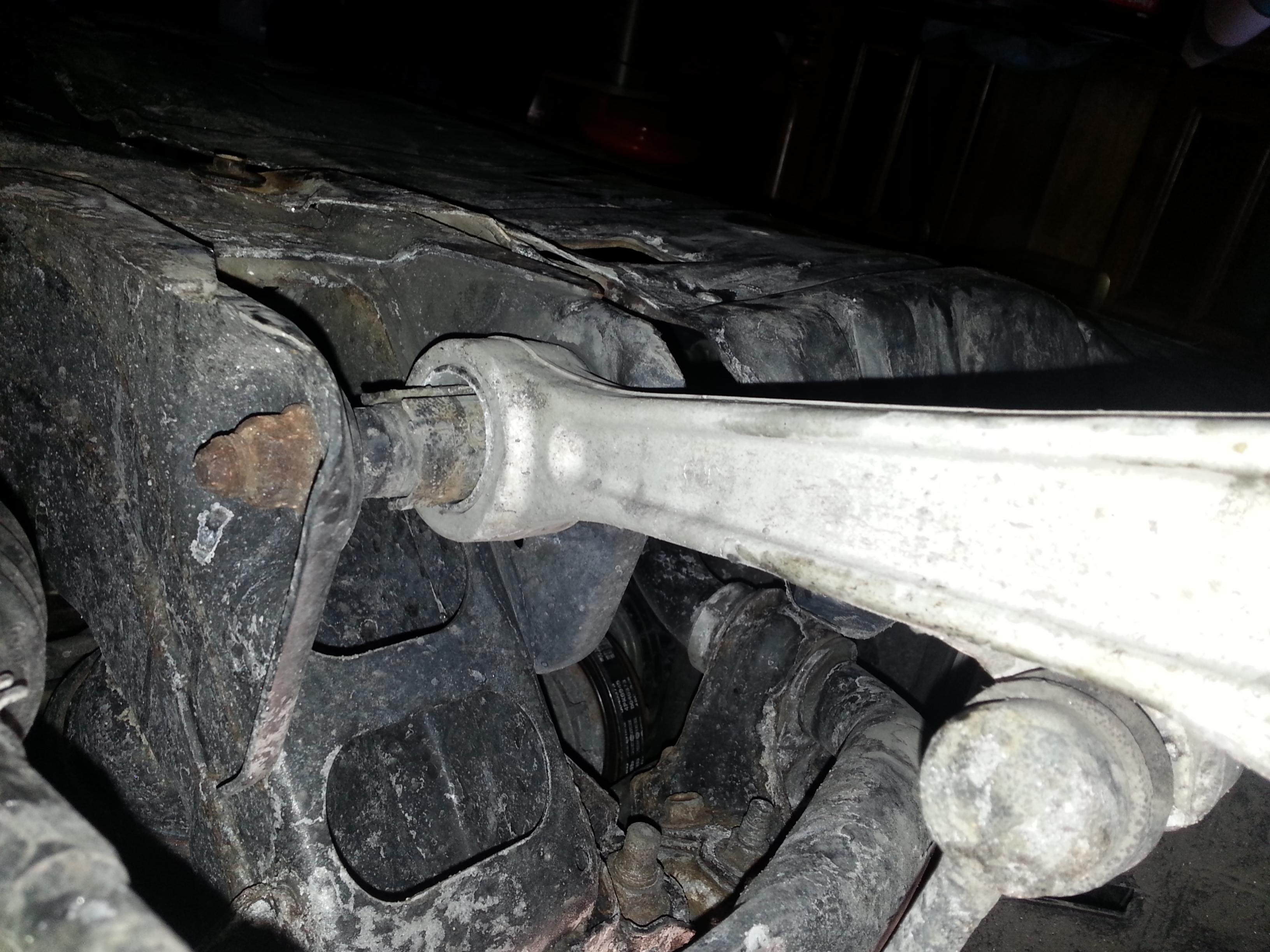

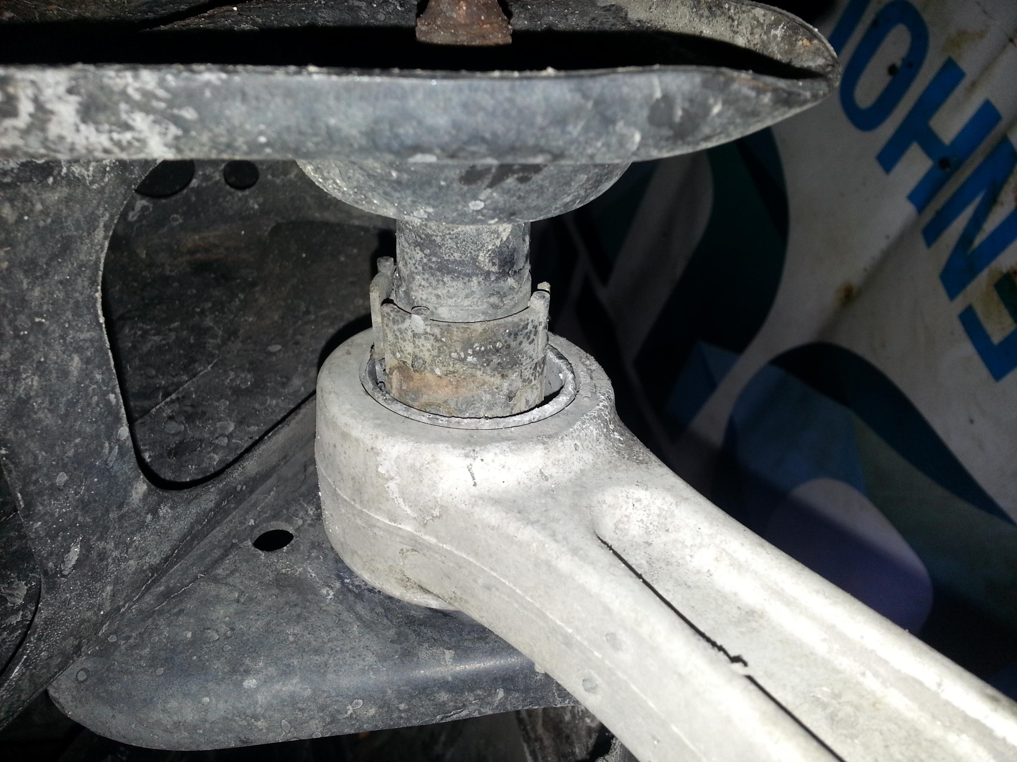

Is this normal or it needs to be replaced?

Replace - don't bother with another OEM rubber one though.
Try Hardrace/Prothane/Superpro/Whiteline etc
I presume it's knocking or has some play in it right ?

Very common for those bushings to tear

Yea its knocking. I will take your advice and get some aftermarket.
