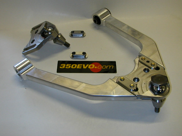

Endurace race proven.
easy to adjust.

BJ, can you answer a question for me?
It seems from your picture that the adjustment in your arms comes from sliding the plate with the ball-joint against the a-arm itself and clamping the two together with 4 bolts in slots. Since the two plates are secured from clamped friction only, how do they resist the intense sheer forces that they are subjected to?
It seems like you would need to torque those bolts down pretty hard to prevent the plates from slipping against each other at full load on sticky tires.
Jason
Old Feb 24, 2004 | 03:16 PM
dwnshift's Avatar
dwnshift
Posts: 1,514
From: Cincinnati
Jason,
We have been using and working with this design for over a year on our race car and never once had an issue with slipping. The cornering loads that we see in our 350Z are much higher and for longer periods of time than any street car will ever see.
I will try and get the exact specifications from the engineering firm that helped us with our design.
There has been alot of blood sweat, and engineering that has gone into our arms.
The bolts actually go through two plates: one on top and one on bottom, these plates sanwhich the arm and the slider.I can tell you that the bolts were torqued to 18 ft/lbs at Daytona Int Speedway on the high banking at 100+ MPH for a three hour race. NO PROBLEMS.
The only way that this would be a problem: If the mechanic doesnt tighten the bolts.
This same design has been used and is still used on all types of street and race applications. Most of all the Porsches we prep in our shop have sliding type camber adjustment.
The adjustment on our arms is very simple of very fast. A jack, 12mm socket and a camber gauge are all the tools you need to adjust the camber. No need to remove the wheel and exact camber adjustments cvan be obtained.
The ball joint design we use is the same stlye found on open wheel cars. And with the small joint package we are using allows for the most positive camber adjustment on the market..... without bottoming out on the underside of the shock tower!
I promise that we are fully commited to producing top notch proffesional products for the 350Z and G35.
Racing makes a great proving/play ground!
Cheers
BJ Zacharias
