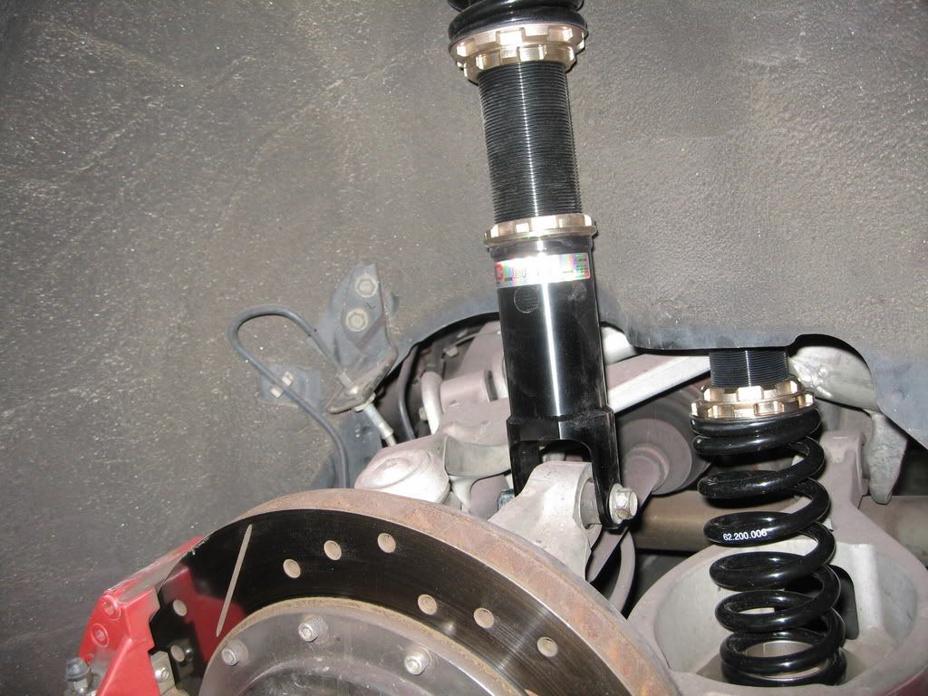

So, you don't 100% need to know what you're looking at or even what you're looking for. Aftermarket suspension is fairly easy to spot. If you turn a wheel and see something along these lines (this is rear suspension, but notice the locking rings by the springs...they'll be in the same spot on the front suspension)
If you can't turn your wheel to get a good view or if you don't feel like crawling on the ground, lift your hood up. Take a look at the left or right and see if you see something like this
It may not be that color or it may look slightly different, but notice that **** sticking up? Either of these tell-tail signs will alert you to having an adjustable coilover suspension. IF you have that, then you can simply adjust the car to the height you're comfortable with.
If you don't see any of those things in the pictures, then it is more than likely you have springs only. Simply replacing the springs with factory springs will lift your car back up.
