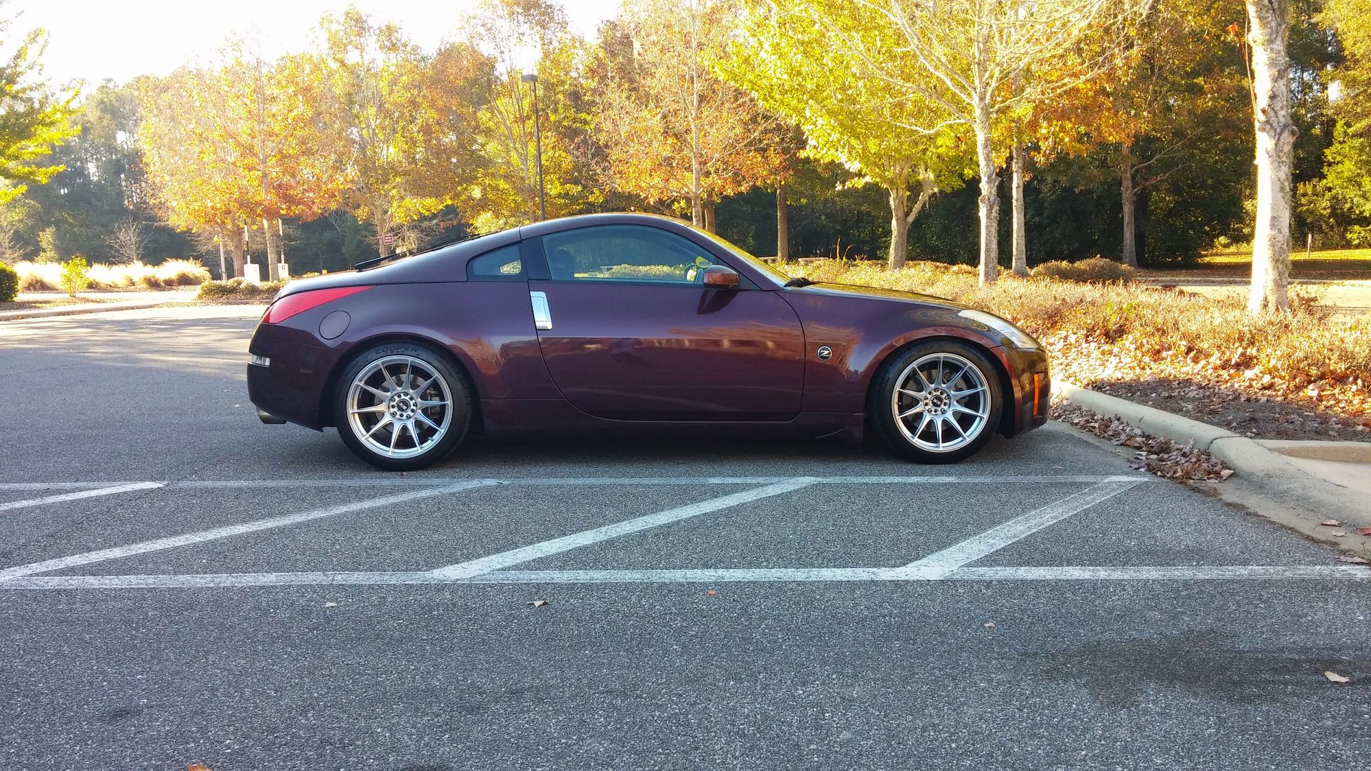

Old Jun 25, 2015 | 03:47 PM
JMSpeed's Avatar
JMSpeed
Joined: Apr 2009
Posts: 243
From: Tampa
Wanted to provide pictures of how my Bilstein B12 Pro-kit turned out. Rear seems to have raised a little since camber pulled in from -2.7 to -1.5. Unrelated to the kit, I'll most likely get a 10 or 15mm spacer for the rear to complete look.

Old Jun 27, 2015 | 03:12 PM
kilogram's Avatar
kilogram
Joined: Sep 2013
Posts: 233
From: Arvada, CO
That's a good look. Any rubbing on really big bumps, front or rear?
