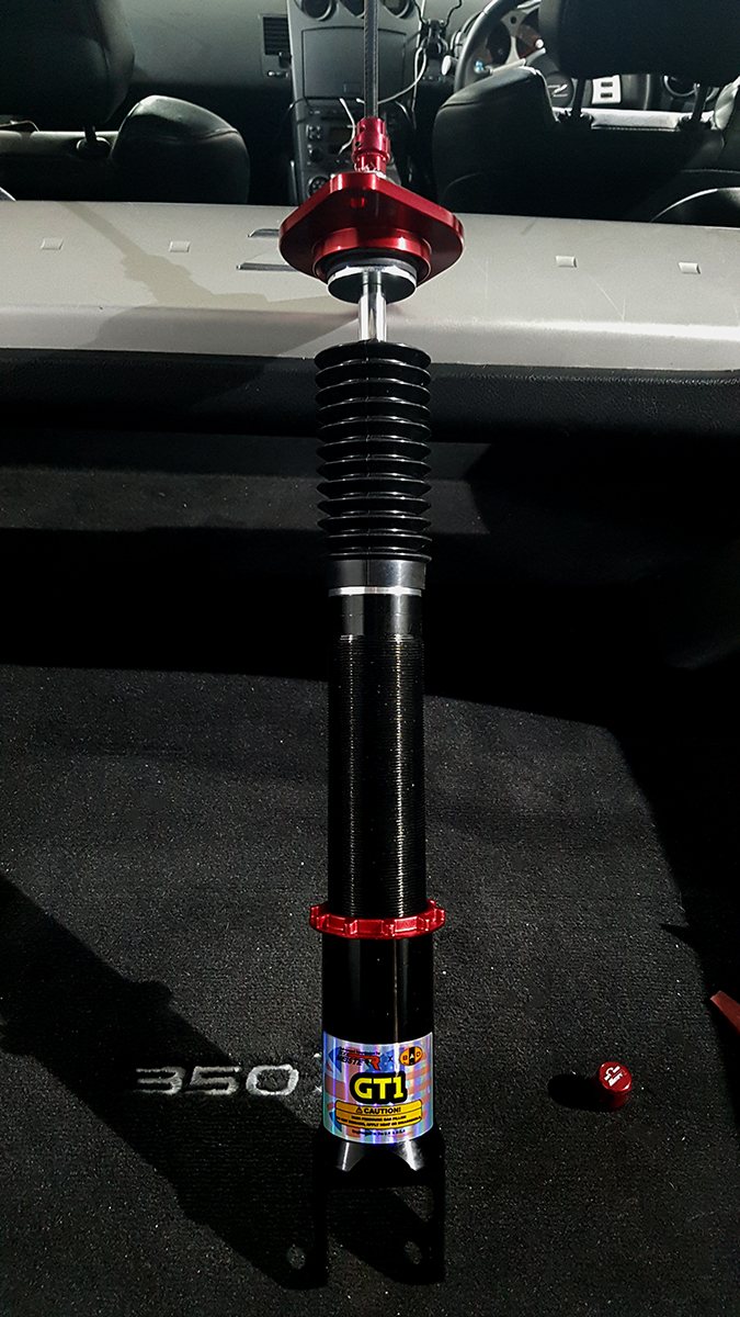

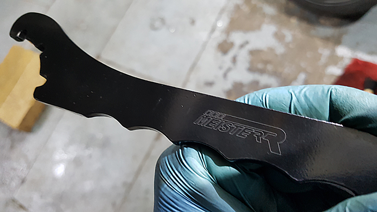

Packaged very securely, you get the suspension, rear adjustment extenders and the custom C-spanners for the locking collars. These are unique from other ones I've seen, you have to slide them down/up over the teeth but they lock in tightly so they don't slip. Extra kudos for this design.

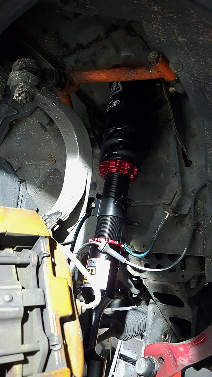

Taking the B6's off is simple, there are enough videos on youtube showing how to do it, this being one of the more concise ones:
I just unbolted the droplinks at the front to give me a bit more movement.
And with the rear spring bucket, I only unbolted the outer bolt, you get enough clearance with some pushing to wiggle the spring and rubber cones out. The inner bolt adjusts the toe (iirc), so I'd rather leave it alone.
I checked that both front GT1's were the same height, you can use a micrometer/tape measure for this. It's pointless comparing against the old shocks as they'll be different due to the springs etc, plus you'll have to adjust the height regardless.
Installing the new suspension is very easy, they have clear instructions with them too, so ensure you read that. I cleaned and wire brushed the surface where the top mounts meet the body of the car as a bit of crud had collected up there.

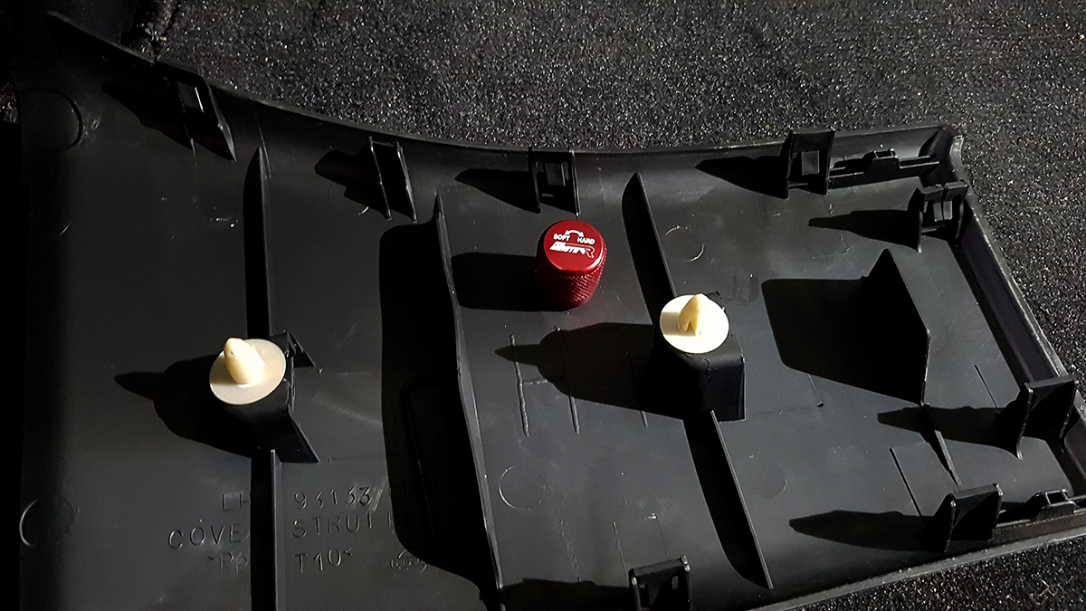

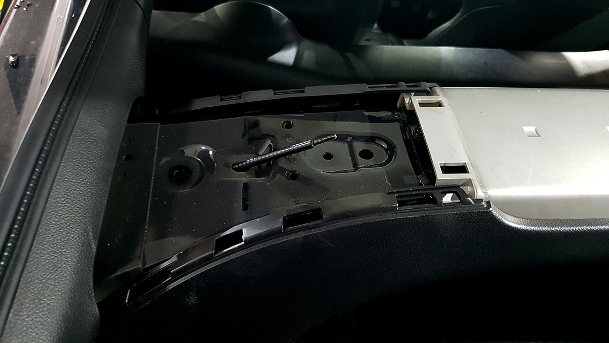

Obviously with the rear, open the boot, and remove the plastic covering on the brace, I took the top edge pieces off for the extender cable to go through. I ended up using the hole for one of the plastic popper fittings, and drilled a hole through this one, saved time having to work out any measurements.
Once the plastic covers are back on the strut, I was left with quite a length piece of extender cable which I chopped down.
A little tip here, after chopping to the correct length, it wont fit straight into the adjuster dial, so just unwind 4-6 of the individual wires and snip them off. With the rubber covered coiled sheath, I found I couldn't quite cut them but you can bend it whilst in the jaws of cutters and it'll just snap at a certain angle. Then it'll be thin enough to then securely get the dial back on.

I've not installed coilovers before with the adjuster cable, so for the first few mins I thought, uh oh, these are going to be tricky but when you get down to it, very easy just a bit fiddly.
Hah, technically you could put a very long cable for in drivers seat adjusters
Yep, retaining the spring bucket was a plus for me as well. Sure if it was an out and out track car I'd possibly look into 'true' coilovers, however I've no idea yet how these perform on track. Very much looking forward to booking a day in the near future !
I like their channel, funny and reminds me to have a laugh sometimes when working on cars
