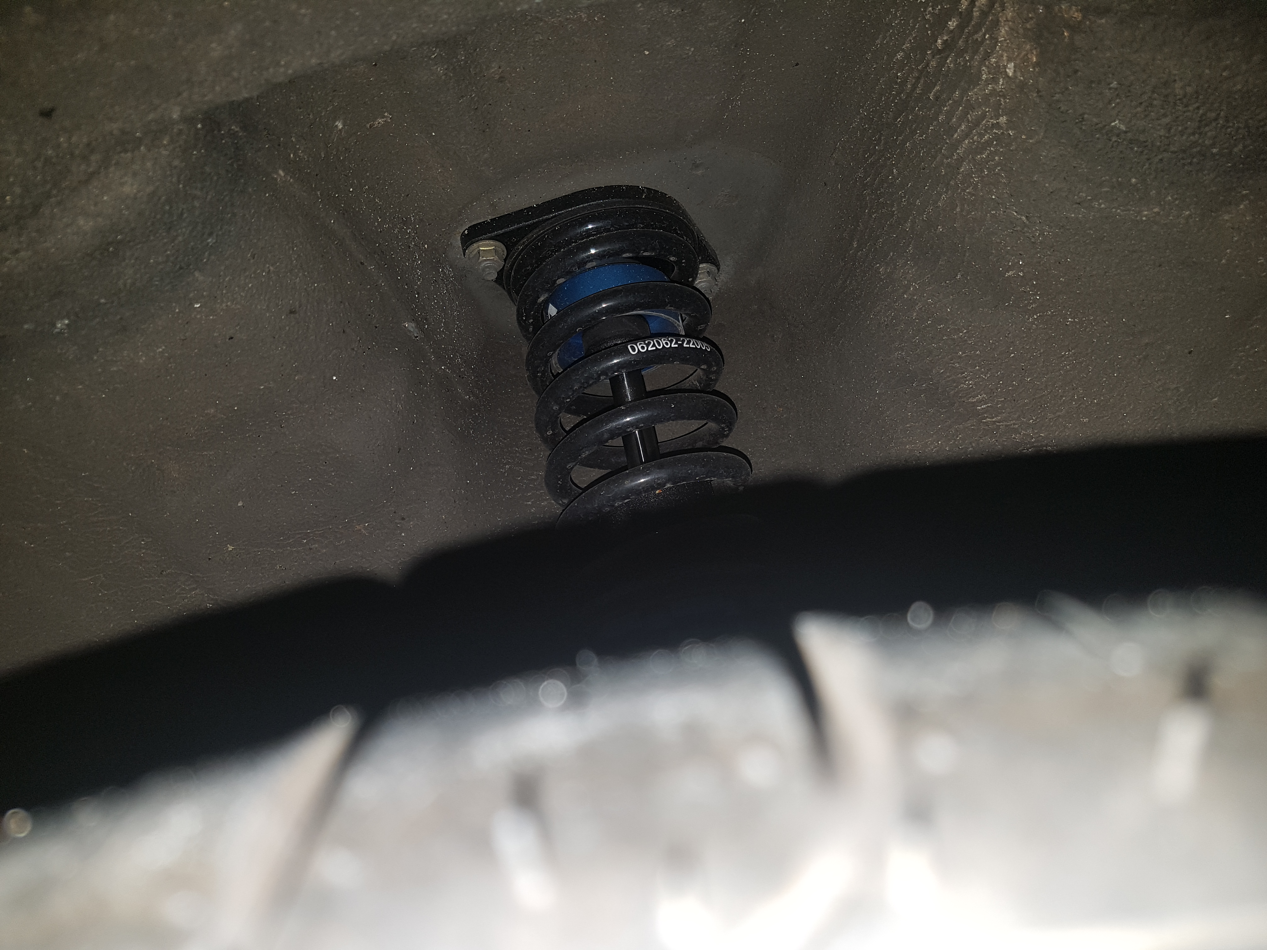

Hi guys,
I've recently had MCA blue fully adjustable coil-overs installed and its easy enough to adjust the fronts (simply pop the hood and turn the **** to desired stiffness) but I can't access the struts at the rear for the life of me!
I've removed pretty much all my pretty plastic bits in the boot but it looks like unless I put a hole in the body I have no easy access... I know my garage adjusted the rears initially stiff as f$*# and said to me to adjust fronts only cause its a pain in the **** to get to the rear coilovers, but its too stiff... Any help greatly appreciated!

You can cut a pair of holes , or just remove them, soften the stetting, and reinstall. Only two nuts at the top, and a nut/bolt on the bottom.

Big unibit and drill a hole.i cut mine up about 3/4 inch
Drilling a hole did you notice any change to refinement? Cars noisy as is lol

My car has full solid bushings, high springs rates, gutted interiour and the exhaust is explicit loud

You definitely don't want to keep the hole open on a street car. Paint the edges with rustproofing primer and find a rubber plug to fit.
