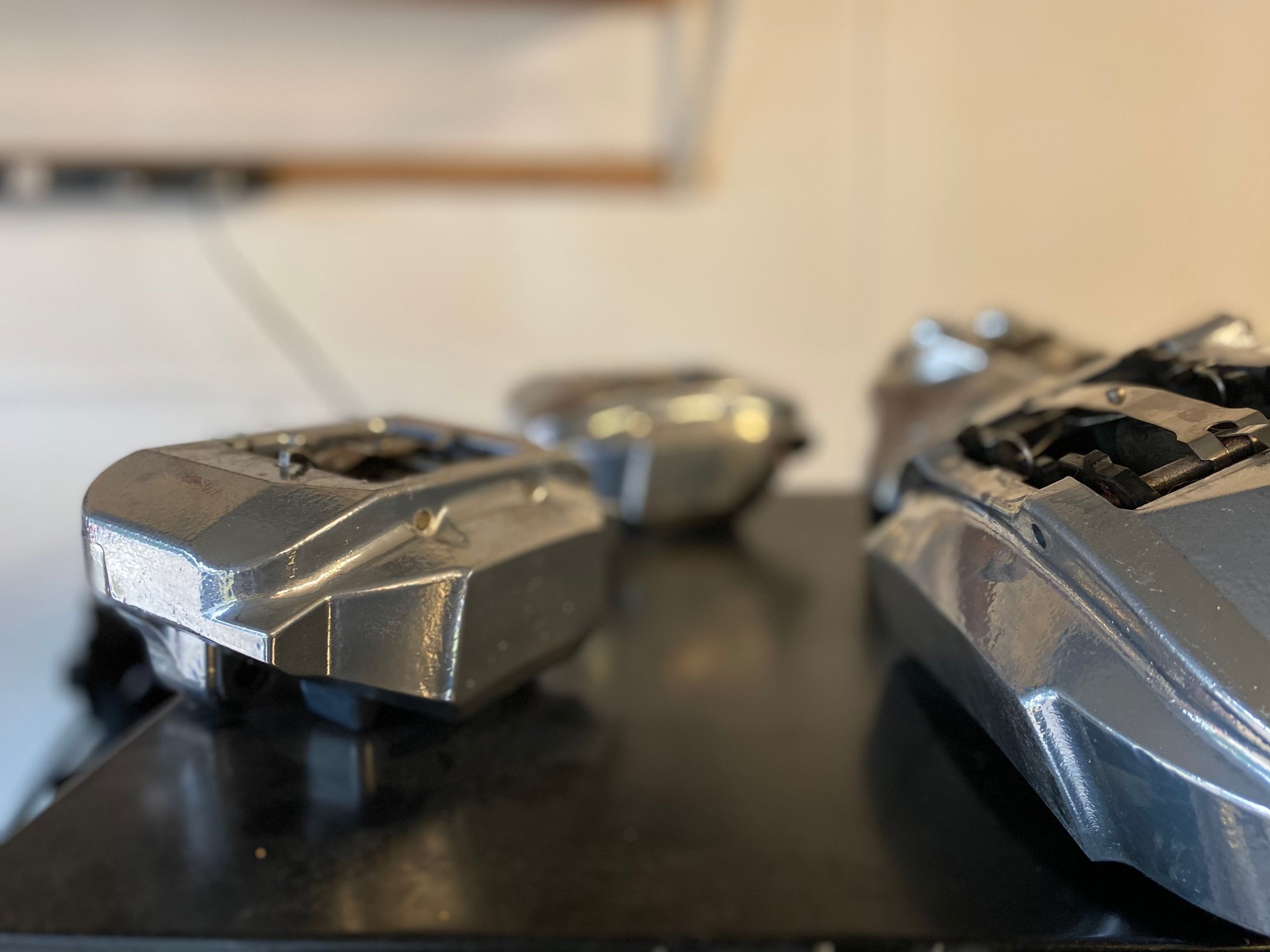

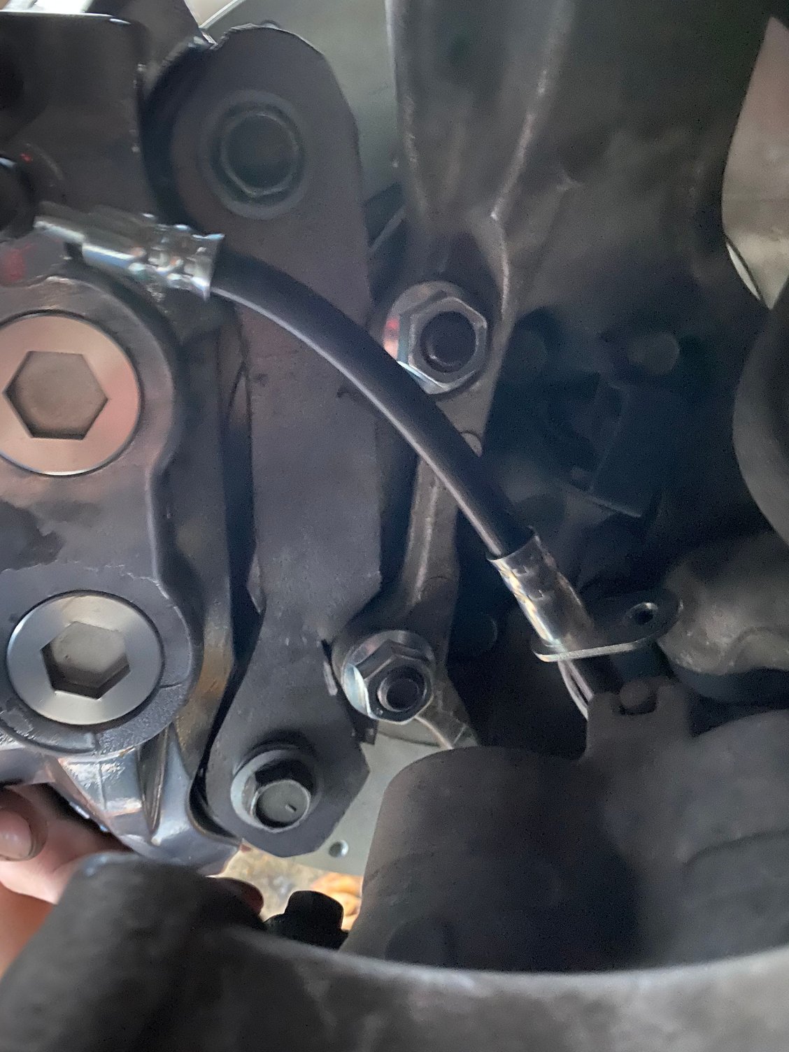

Lexus LS460 brake calipers mated with 370z sport rotors on a 350z.
Not a how to, just stating that it is possible use these calipers on the 350z as an alternative BBK and nobody seems to have tried it out yet along with some issues that you may come across when trying out different calipers
Made adapters with 3/8 mild steel, and steel braided brake lines in the front. The steel is strong enough for daily and occasional hard braking. Mild steel will also bend instead of snap so is also better in terms of safety and warps less when welding. Aluminum is expensive and would be better off being machined if you want to g
o that route.
The brake lines have the same connection to the hard line of the body which uses an inverted flare incase you want to use the brake lines off of the Lexus calipers. The fronts are the same, but they're too short so I used Stoptech steel braided brake lines.
Akebonos and Brembos are easy ways to get a bbk with lots of research behind them and the adapters, but I felt like trying something new. Replacement calipers and pads are also significantly cheaper. Many people have done this with the Brembos off of SRT8s, CTSVs, Porsches and there are kits for those, but I just didn't feel like getting them at the time.
They work very very well and all the issues are sorted out. Very tight clearances between caliper and wheel as well as caliper and rotor so I had to add thin shims to make the caliper align perfectly to the rotor.

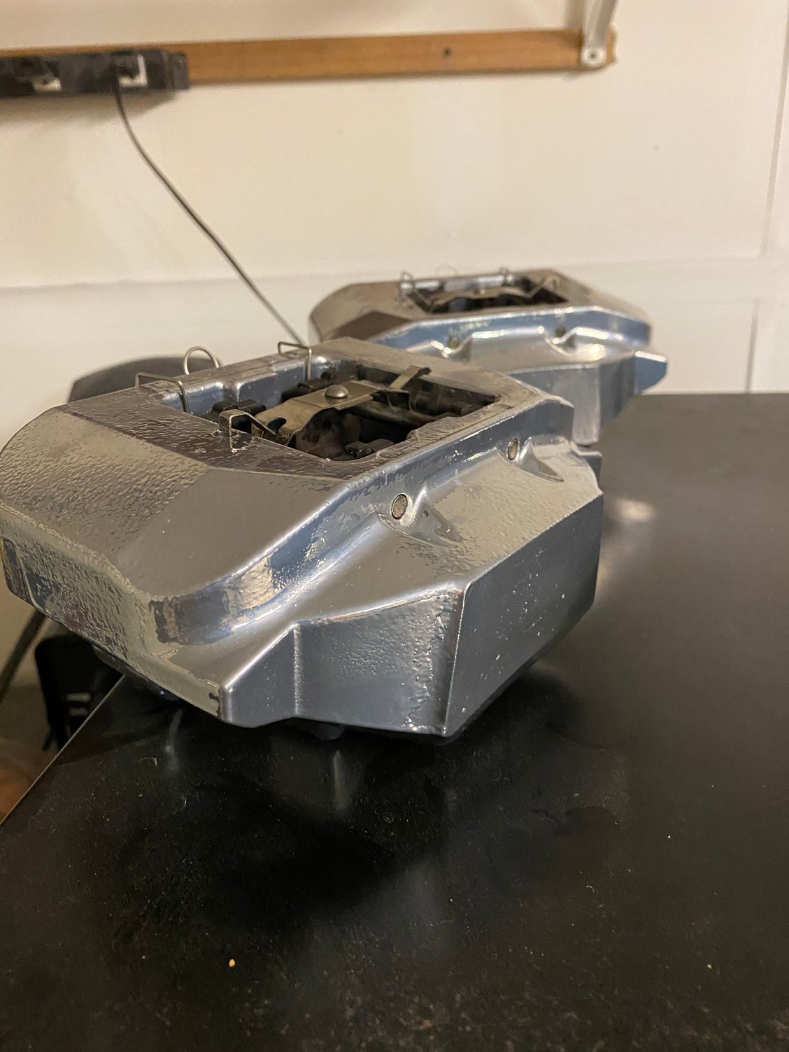

All calipers were powdercoated chrome 😅😅 I may redo them in the future since I touched it before it had cooled with acetone soaked gloves.

as for the front adapters I made sure to chamfer the edges to a 45 degree angle and preheat to reduce warping and increase weld penetration. I'll take a photo of the welded adapters next time they come off

Haha I see the chrome now - doesn't really pop on an unmachined cast surface.

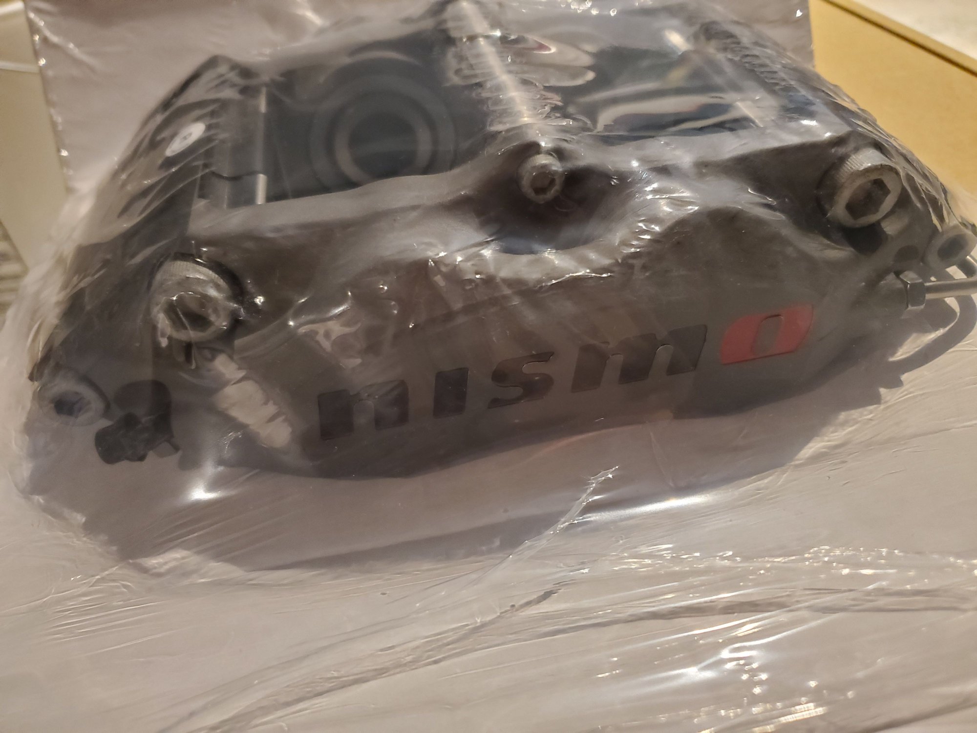

Yes, I haven't installed it yet but I have them chillin in my basement. It's a kit Nismo sells as an upgrade for brembo equipped cars, they relocate the front calipers to the 9&3 location as opposed to the stupid factory location. They are bigger 4 piston/2 piston calipers that are forged, radial mounted calipers made by Stoptech.
In a nutshell it's the trophy sport 4/2 13" BBK kit minus the rotors and they say Nismo instead of stoptech.
