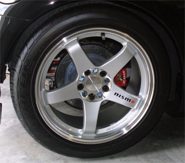

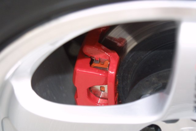

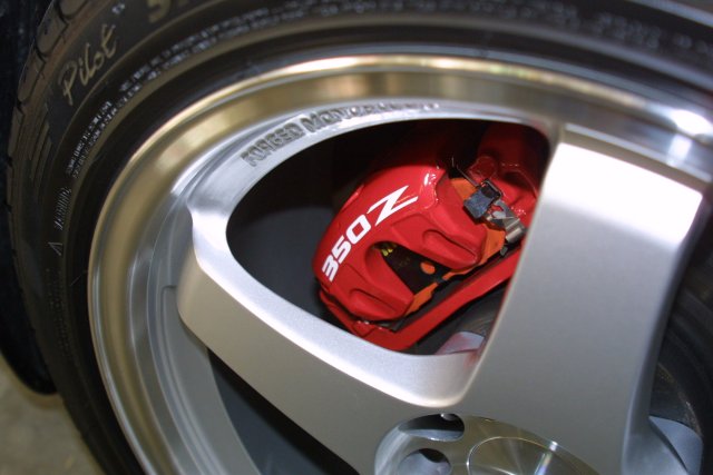

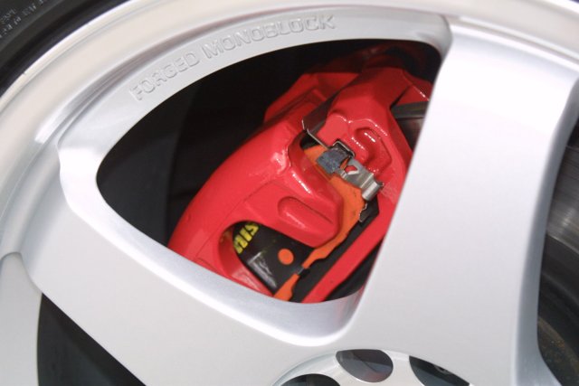

I paid $200 for mine, and I am very happy with the way they turned out. Here are some pics.
This one is with the JVD sticker on it
