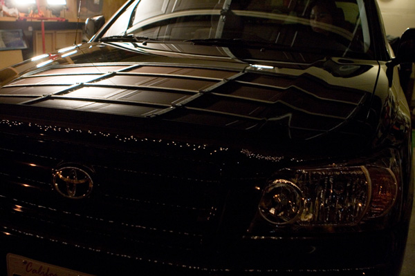

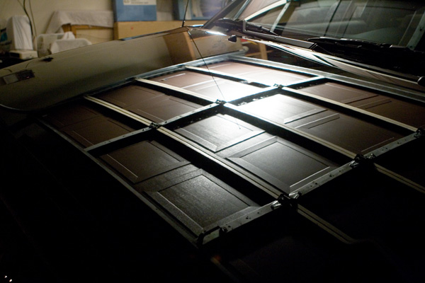

I feel your pain, had the same problems on my PPW.
Here is what I used:
PC w/ counter weight (Orange, White, Grey pads)
Optimum Polish
Poor Boy's EX-P sealant
Meg #16 wax...
Don't have pics on this computer, will post them when I get home.

Pics as promised... it's not Rocket-Science, just practice on your wife/gf's car first
