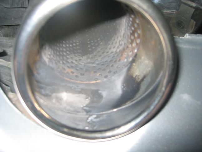

Greg,
Will that stuff "eat" the black residue that builds up on the inside of the exhaust tips? Or do you still have to rub the schit outta it till it gets back to looking like shiny metal instead of black.
I hadnt cleaned the inside for prob 20K mi....whoops! mainly cause i didnt know what to use so they were pretty black. Going forward i'm going to stay ontop of it so it doesnt get as bad...hopefully it wont be such a pain next time.

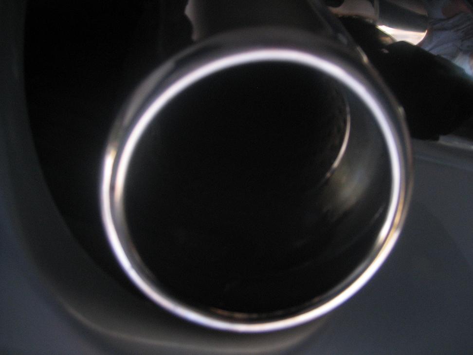

It does not eat through it, in the sense that it will not instantly dissolve the build-up. However within a couple minutes it should look like new again. If you prefer a spray on product you should try the P21S Total Auto Wash. This product is a citrus degreaser that you can use before washing to help loosen stubborn build-ups on your entire exterior, most of the engine bay and most fabrics. The citrus formula is very safe and effective. This should save you from some scrubbing, but to get the tips very clean you'll probably have to do some rubbing. Let me know if you have any other questions.

here are a few kinda crappy shots i just snapped, so you can see what im trying to get off.
the second shot was taken upside down with a flash, 3rd without flash. it shows the part i didnt take the time to scrub cause my hand was feeling abused after getting the bottom part back to shiny.
i'll look into picking up some stuff from you greg...looks like some great products.
ps-sorry bout the thread jack! fairladyz47597 <--its his fault!
Attached Thumbnails how often should i wax?-exh-inside-small.jpg   how often should i wax?-exh-upside-down-small.jpg   how often should i wax?-exh-upside-down-no-flash-small.jpg   how often should i wax?-exh-sys-small.jpg

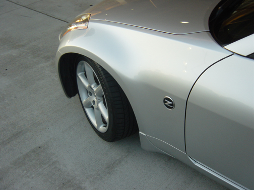

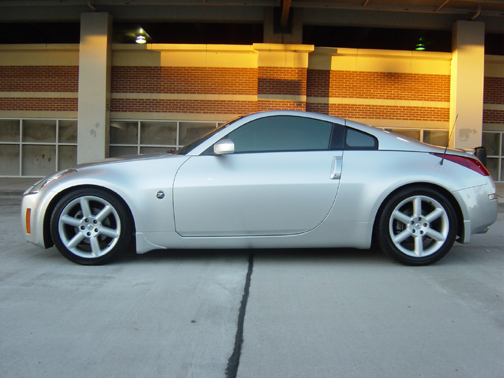

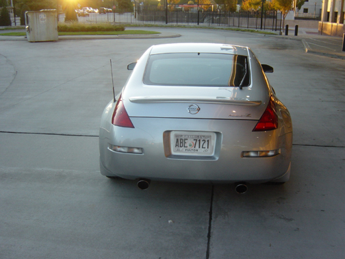

awesome! glad you tried his work out! i thought he did an excellent job on my car! i don't know if i posted pics, but here it is after he washed, polished, and waxed it...
Attached Thumbnails how often should i wax?-dsc06019-copy.jpg   how often should i wax?-dsc06022-copy.jpg   how often should i wax?-dsc06023-copy.jpg   how often should i wax?-dsc06025-copy.jpg   how often should i wax?-dsc06028-copy.jpg

more...
Attached Thumbnails how often should i wax?-dsc06029-copy.jpg   how often should i wax?-dsc06032-copy.jpg   how often should i wax?-dsc06033-copy.jpg

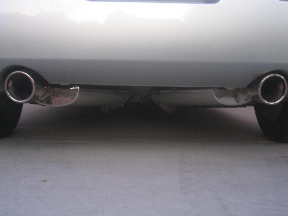

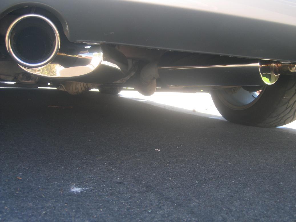

Car looks sharp fairladyz47597!

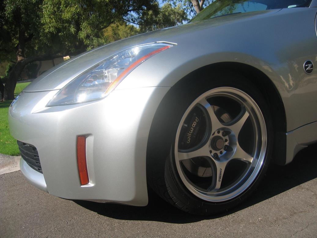

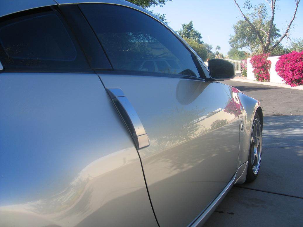

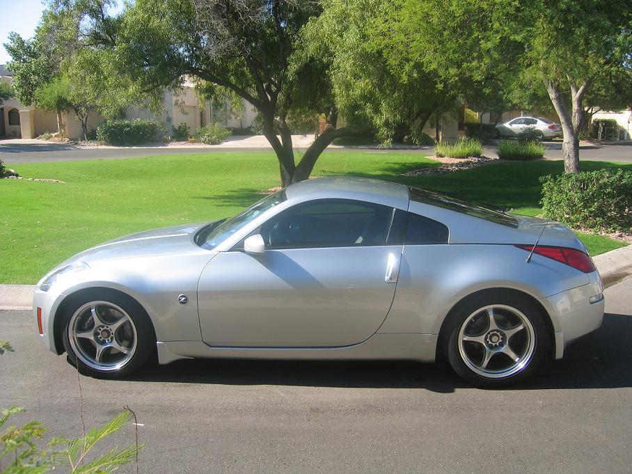

Here's my end result from the day of the claying/waxing/exhaust polish.
oh ya..washed it again yesterday, so it look like this now too!
Attached Thumbnails how often should i wax?-ride.jpg   how often should i wax?-ride2.jpg   how often should i wax?-ride4.jpg   how often should i wax?-ride3.jpg

thanks for the compliment. i just took the pics when the sun was setting so the light was pretty nice. i've noticed that my silver car looks the best when it is twilight.
i like your wheels btw. are they any special kind?
i did feel violated when someone touched my car. at first i thought it was some of my friends at work but then i realized that it was some stranger which pissed me off, but i got over it. no big deal. i will check into a california duster to get some of that ugly dust off the car. meanwhile, i'll pray for rain. i'm sick and tired of this frickin drought.
Old Nov 20, 2007 | 02:26 PM
  #39
grudum's Avatar
grudum
Posts: 392
From: Phoenix
thx.
5zigen FN01R-C brushed 18 inchers. nothing too special. They're light and reasonably priced. They look cool too, if you look closer, the inside edges are powder coated a darker grey. Got em cause I had the BBK up front w/ stock rims originally, which was kinda goofy. The stockers cleared w/ no probs by about this | | much! lol.
I love the tires on em more than the rims though!
