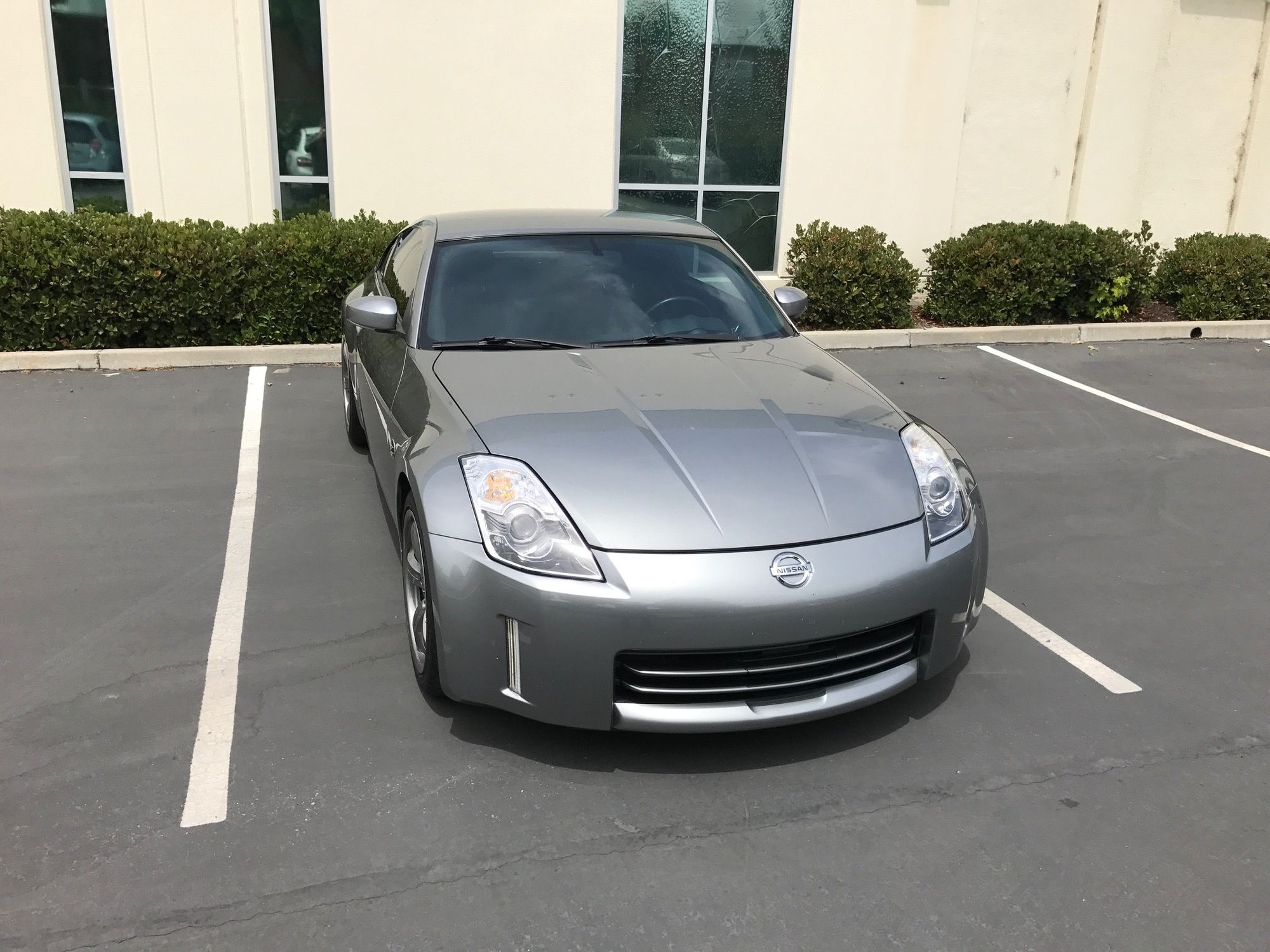

I'll need to check out this Opti-Coat stuff. But so far I've been very happy with AMMO NYC products. I primarily use Larry's interior kit stuff, works great, especially for cleaning the Zs headliner and cloth seats if you have them.
Here's some shots of my Z the day after I spent a solid 12+ hours going through the whole exterior. Steps taken...
1) Complete Wash and dry.
2) Clay bar.
3) Polish (used Griot's #2 polish with 6" foam pad on my DA)
4) Complete wipe down with Grease and Wax remover.
5) Applied AMMO NYC Reflex Foundation coat per instructions.
6) Removed Reflex per instructions.
7) Applied AMMO NYC Skin Defense per instructions
8) Removed Skin Defense per instructions.
All the wiping/drying was done with clean or new microfibers (300gsm+). My paint is not "perfect" especially on the front bumper, but the car really came out great. My iphone pictures don't do it justice.

You know, dude, I work a couple days a week in Mountain View. Got a spare 12 hours? I'll pay premium.... $5/hour. Hahahahahaha!
Looks GREAT!!

Dang nice, and got to get me some of those clears

I had Zleds install the LED mod in the clear front reflectors. So I have them synced with my amber turn signals, then switch over to white LEDs when my headlights are on. If my headlights are on at night and I use my turn signals, the white LEDs turn off and amber comes on. Looks slick and gives my 11 year old Z a modern look.
I would have been able to complete the work much faster if I had an air compressor to speed up the drying process. I also could have applied the Skin Defense with my DA, but I decided to do it by hand with a foam pad.
Water still beeds effortlessly off the paint, been 3 months since application.
