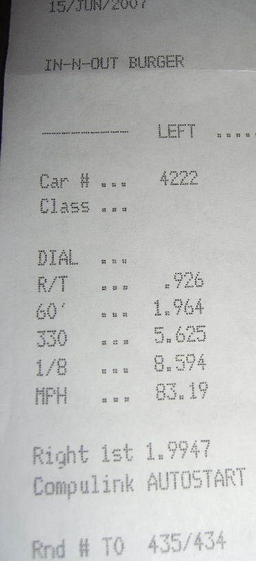

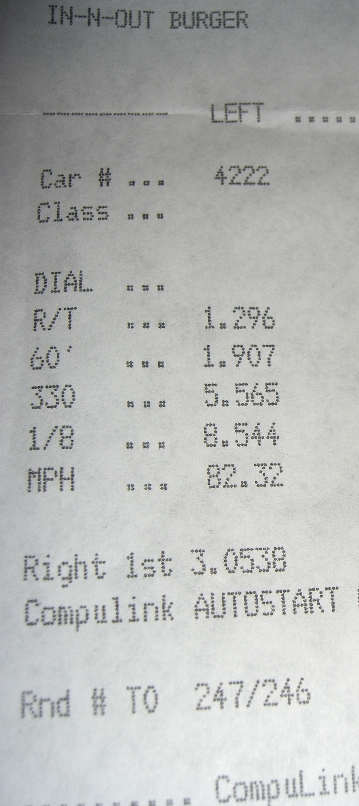

Old Jun 15, 2007 | 08:59 AM
gargoyleZ's Avatar
gargoyleZ
Posts: 242
From: South Califas
went to Irwindale last nite...although my best time there was 8.3et, I could only pull off an 8.5xx. Just thought i'd share. Like Alberto said better times to come. i liked the consistant 1.9 60'z!
opinions welcomed.
