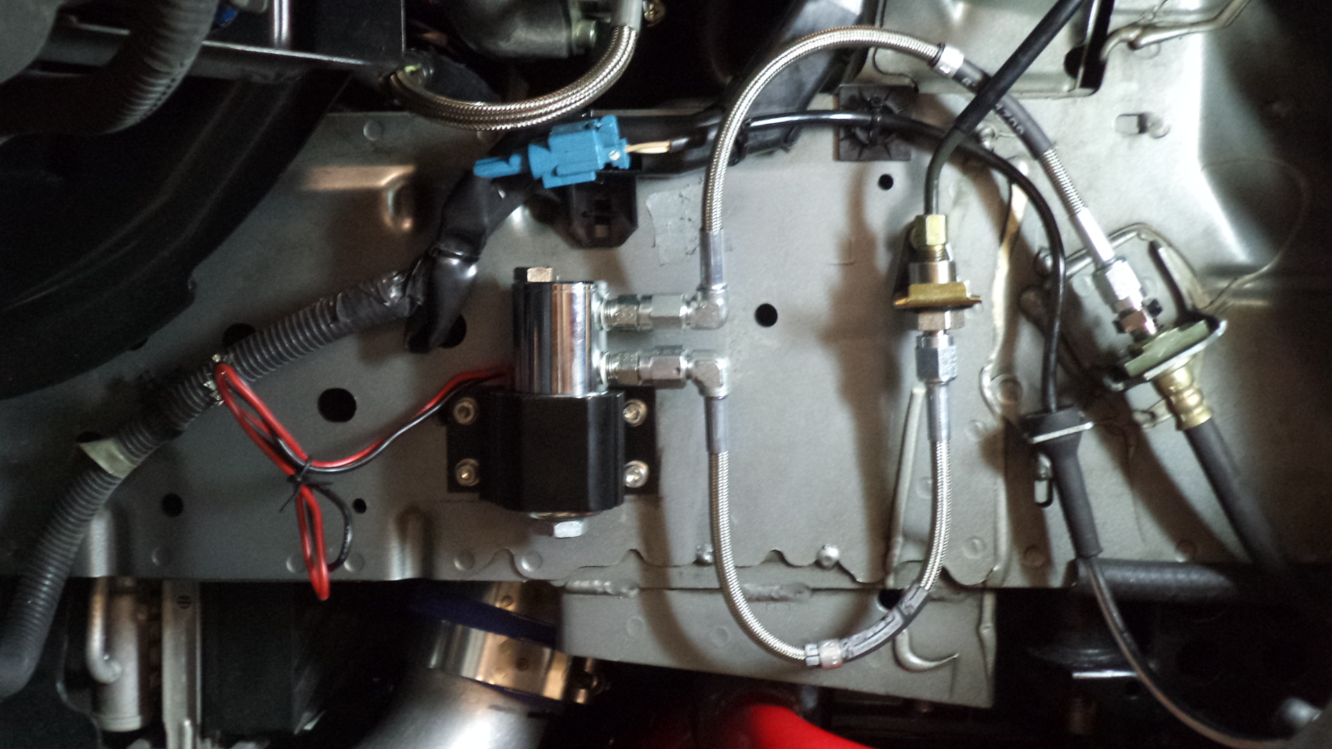

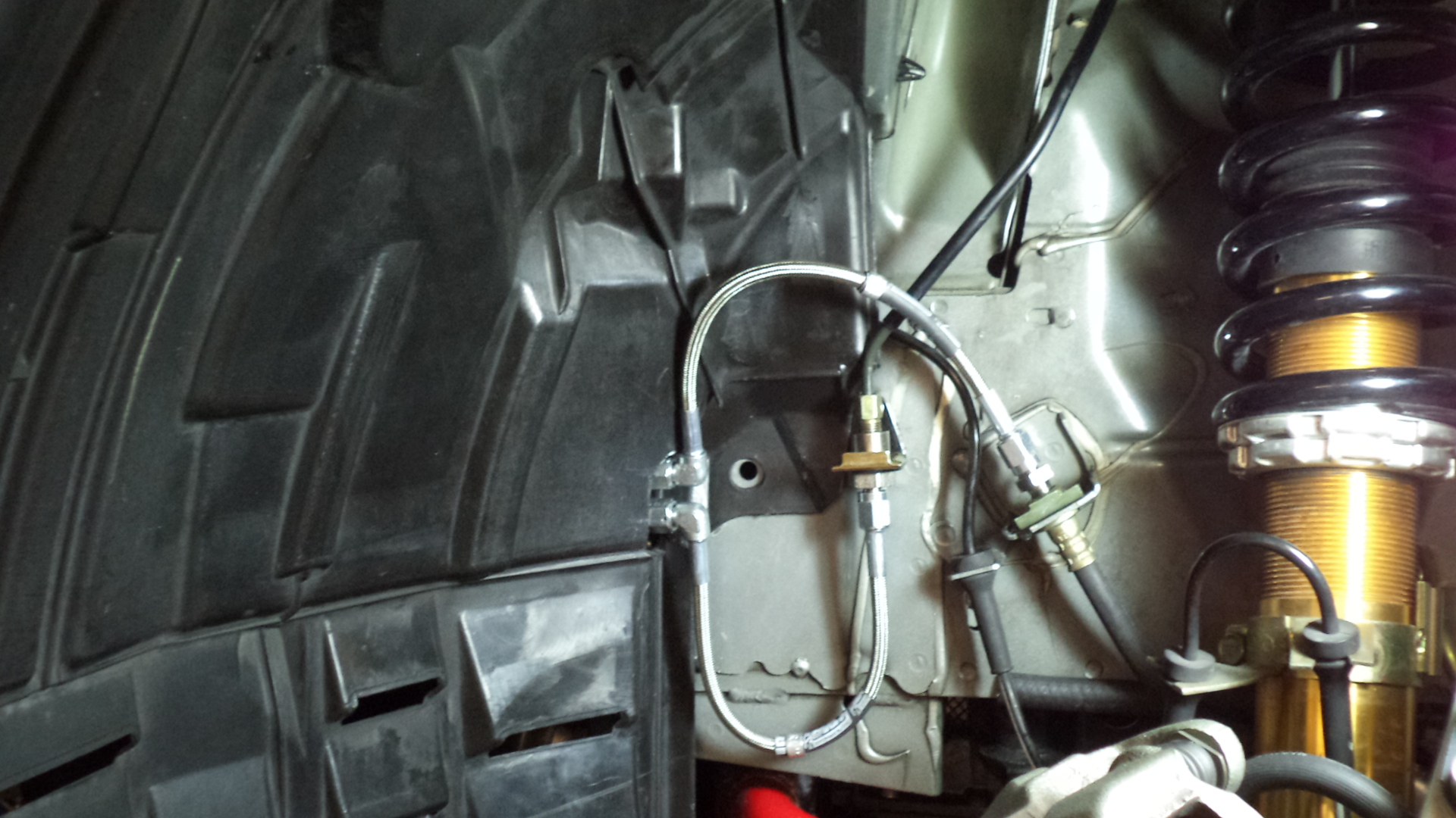

OldManZ350's Avatar
OldManZ350
Posts: 2,429
Likes: 230
I got Hurst Line locks. Don't go cheap, I went thru 3 sets of the Summit Brand that were Bad!
Attached Thumbnails B&m line locks w/ part numbers-dsc00100.jpg   B&m line locks w/ part numbers-dsc00101.jpg
Can you list the parts you used?
That's a slick install... I second the request for parts used...
