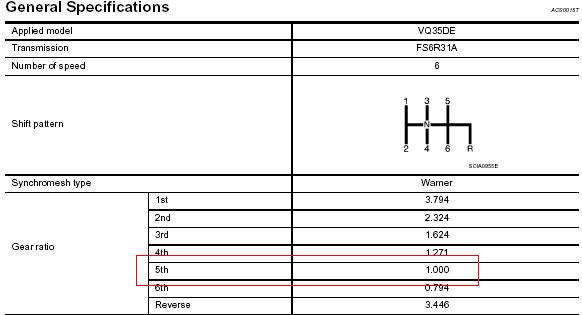

Rim size is stock, car is not broken in, transmission is manual, 4th gear is almost 1:1, 5th is not.
20% loss is not normal for manual transmission...

you need to get back to breaking in the car, and not spouting off your incorrect information...
what does this mean to you: ?

not normal maybe not, but possible, supposedly the carbon fiber shaft was going to help, but it didnt... nothing you can do about it. but yeah 5th is the 1:1 gear.

You're right I'm wrong... 5th is the 1:1...
Now I can't remember whether I dynoed in 4th or 5th.
If it's 5th then we're missing HP, if it's 4th then doesn't it mean we're missing even more HP?
