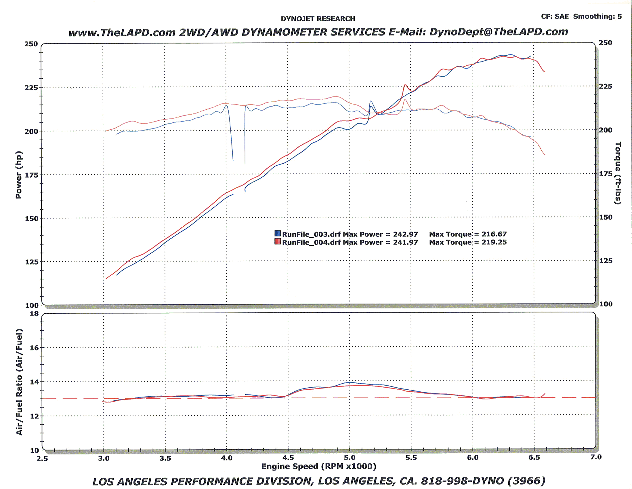

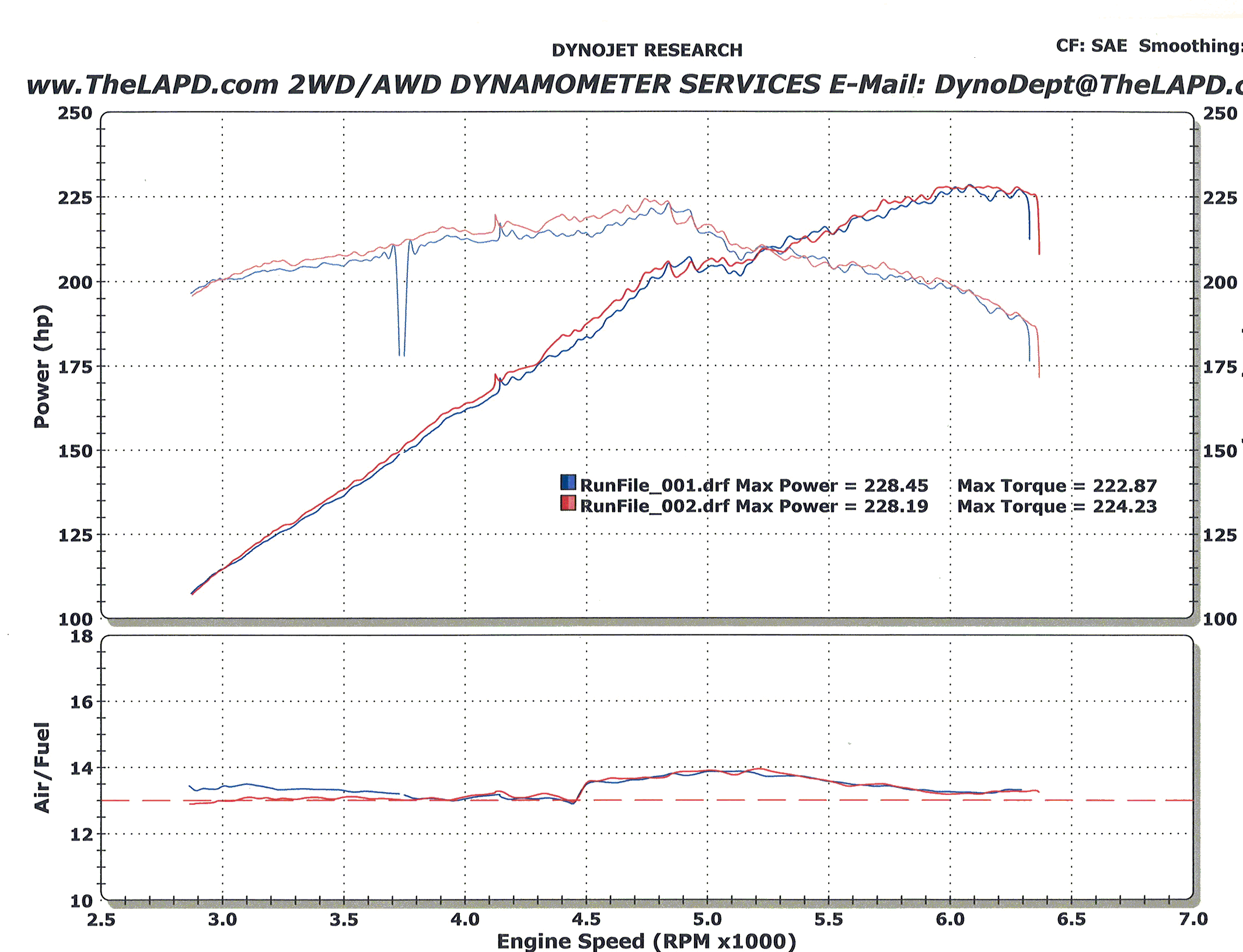

i have a 5AT and with motordyne spacer. intake, stillen TD, and crank pulley i pulled 228whp in 4th geasr and 242whp at 3rd gear on a dynojet

The files are 400k and I don't know how to shrink them...they are on this thread though...
http://www.everything350z.com/ubbthr...psed_5__1.html
Old Oct 18, 2006 | 09:44 AM
cvt's Avatar
cvt
Posts: 1,128
From: los angeles area
okay i figured it out...4th gear runs...
cvt's Avatar
cvt
Posts: 1,128
3rd gear runs

Results are decent. A/F's look good except your too lean in the midrange. If you tuned your car with an EM, or a flash you would certainly benefit with having the A/F's cleaned up and advancing the timing some.
i was thinking of a TS flash but decided to go with headers first...then re-dyno and see where my a/fs are at....then a flash.
