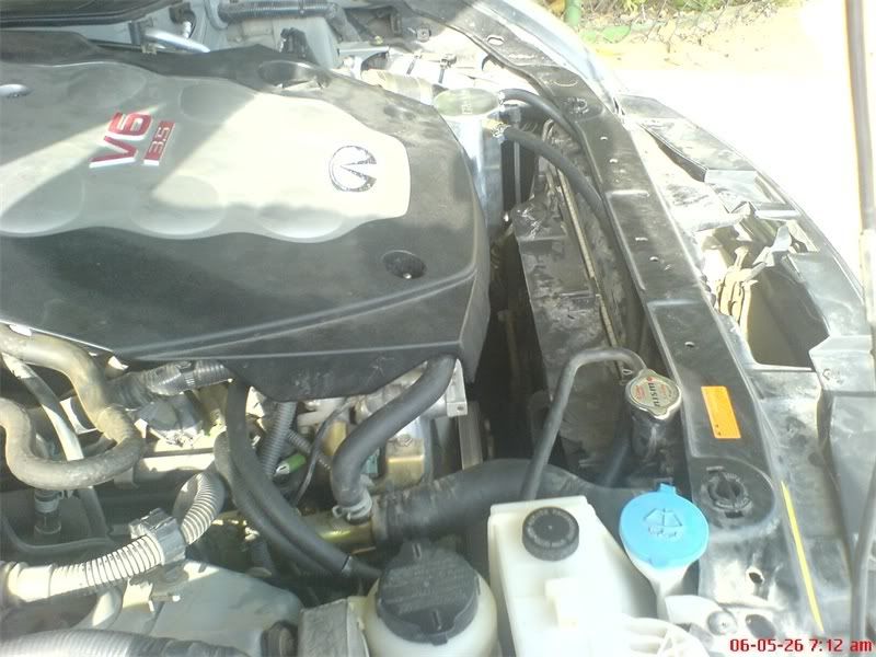

Did anyone ask for Pics ? (Sorry Dirty Engine Well its not anymore )
Followed the Instructions of this Great Thread When i did mine
http://g35driver.com/forums/showthread.php?t=97390
