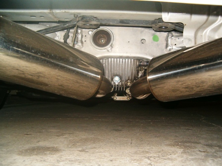

Old Mar 1, 2007 | 04:08 PM
streetracer's Avatar
streetracer
Joined: Feb 2006
Posts: 1,139
From: San Juan
here's a pic of my car with the nismo cover.
