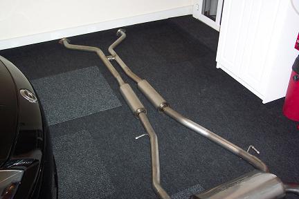

After reading about wrong pipes I decided to put my Borla together before I bring it to the dealer Monday for the install.
Question? Can anyone tell me if this looks right? It seems to look like the diagram that came with it. Any help would be appreciated.

It looks good to me but I'm not sure. Someone whose purchased I'm sure will comment.

Looks good to me. The problem, as told to me by Borla, was the flanges that connect to the cats. They need to be opposite as are yours.
